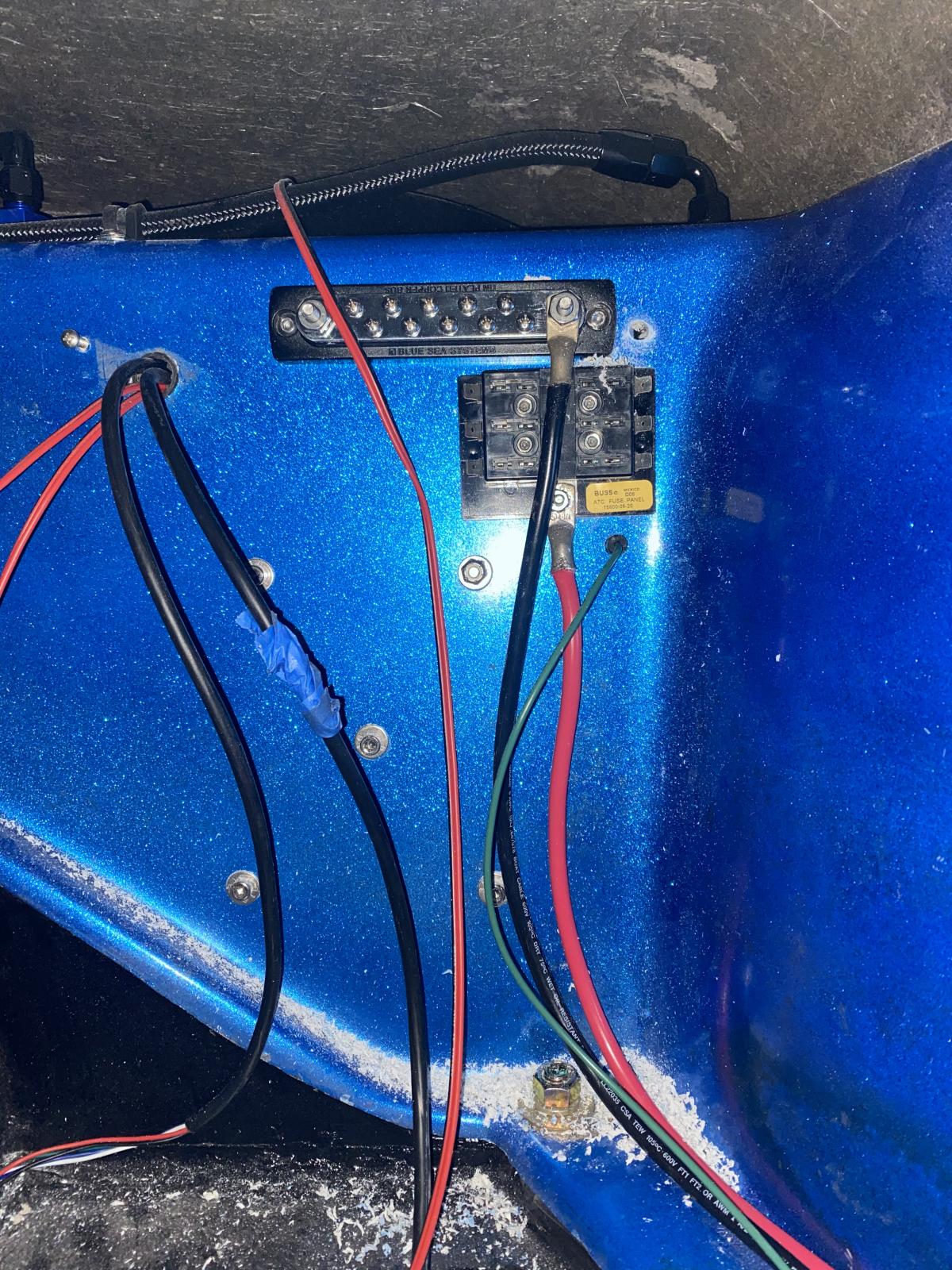

Lots of wiring progress today, mounted the bus bars, fuse boxes, relays, etc And started pulling wire.
I ended up adding a couple extra fan relays, this harness has two but I have three fans. I connected the lower temp “on” relay to the pusher, and then the second higher “on” relay output to a pair of 25 amp continuous that control the two puller fans. I’m trying to give this radiator set up every chance at success, they’re all on 12 gauge wire direct from the battery and grounded direct back to the battery.
All that’s left to do is clean up and loom, wire all the dash fuses/switches and lights in, then it’s time to test fire!

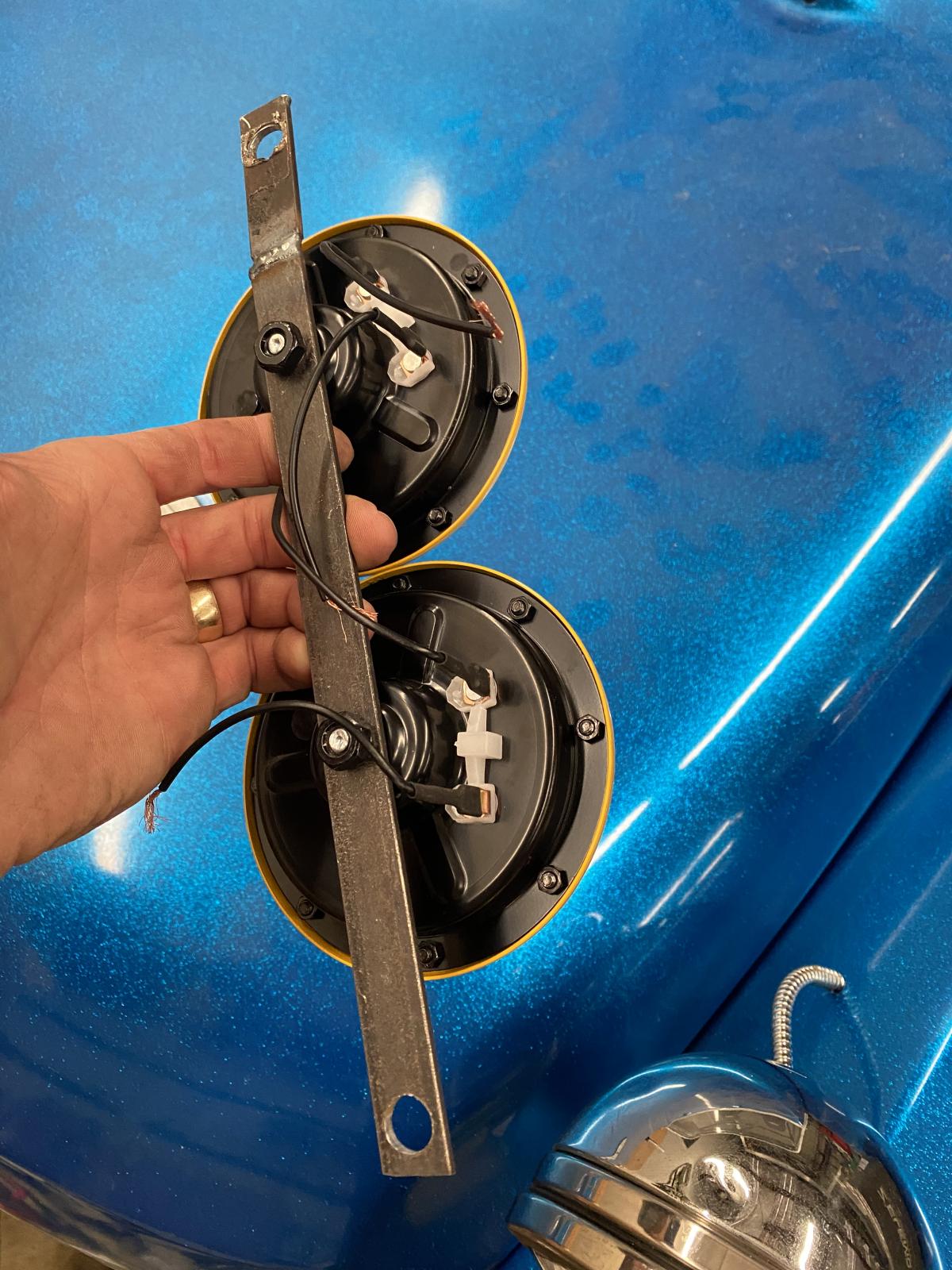

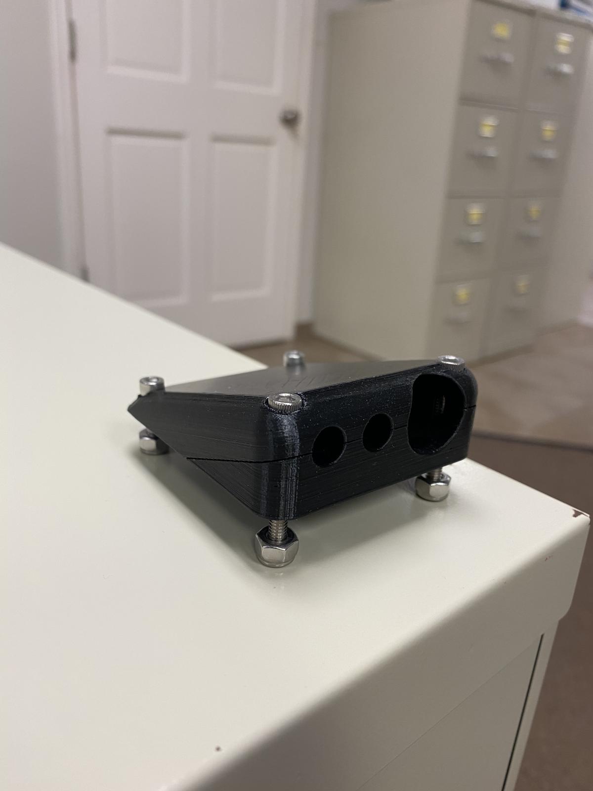

Mounted the turn signal switch from motion Raceworks, and built a mount for some Amazon special horns - these things are LOUD. The mount bolts to the top two beam bolts and the horns are hidden behind the front license plate part of the body

PostPosted: Wed May 19, 2021 10:56 pm    Post subject: Re: Manx II “2-Face” Ecotec IRS Bus 091 Reply with quote

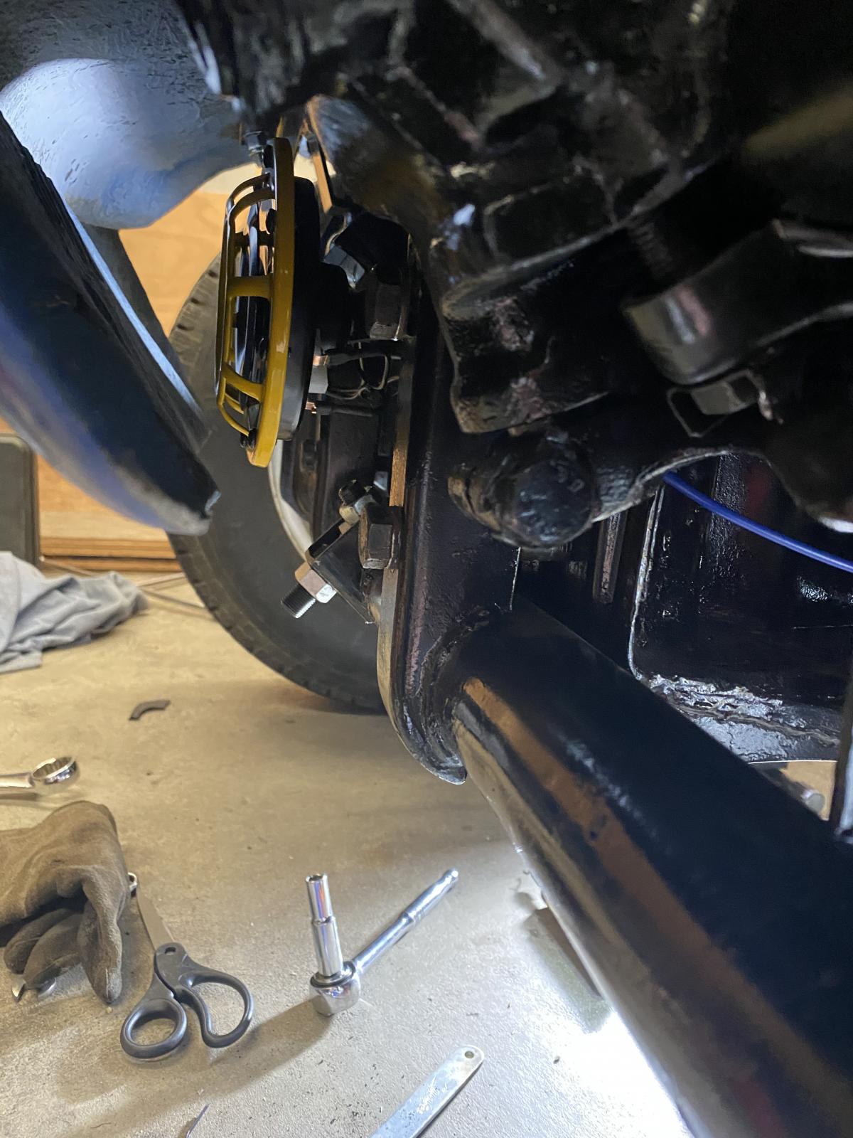

Horns mounted and wired in. I don’t have a provision for the brake failure light so I wired that into the horn circuit... it will be hard to ignore that warning LOL
I’m not sure how well it will work, since the two, 3 wire brake switches could open at slightly different rates and blip the horn each time I hit the brakes... I have never been in a vw with a working brake system warning light to see if it flickers when the brakes are depressed. I will find out pretty soon!

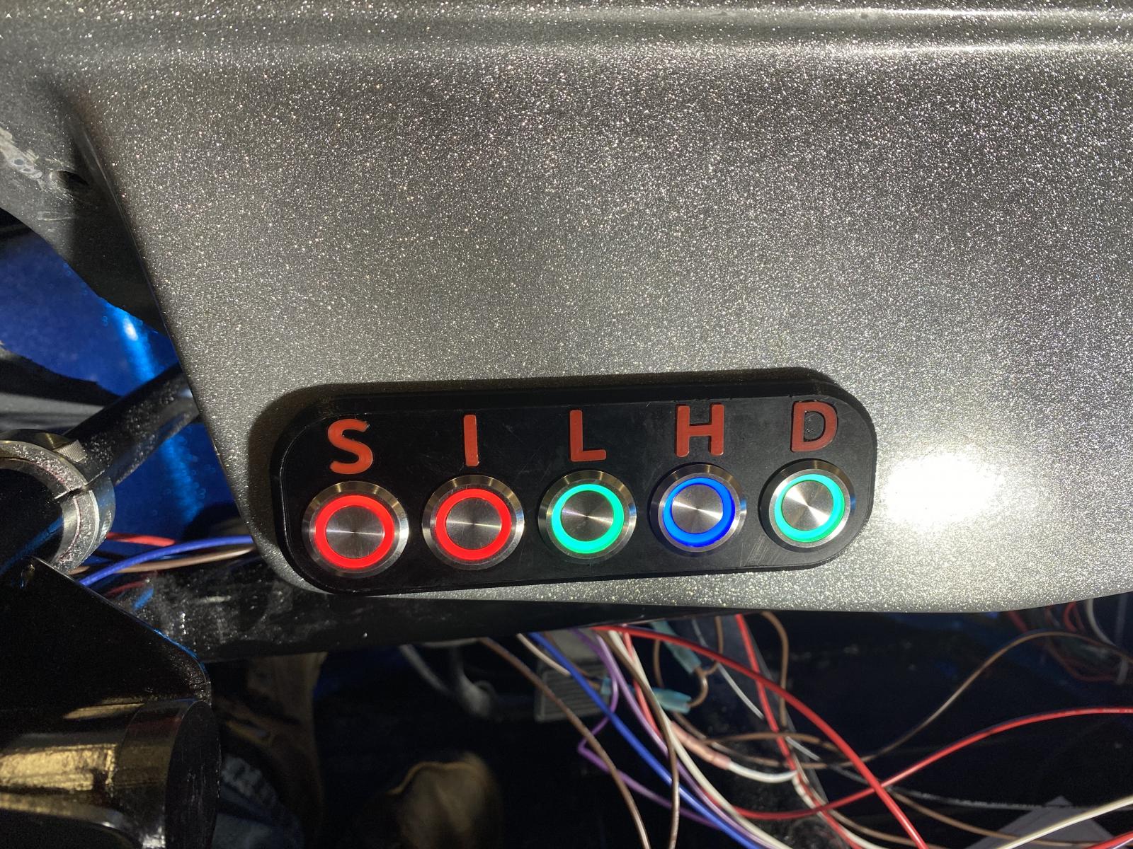

PostPosted: Sat May 22, 2021 10:03 pm    Post subject: Re: Manx II “2-Face” Ecotec IRS Bus 091 Reply with quote
More wiring today, just have to tie/loom everything up and install the horn button. Tested all electrical systems today and they are good to go.
I used a whole bunch of diodes to control all the lights and switch color changes. It was quite a bit of work but it was worth it I think. Also heat shrunk everything so it should last a good while. My plug connectors worked too, I wasn’t sure how they would be to install but I didn’t have any issues.

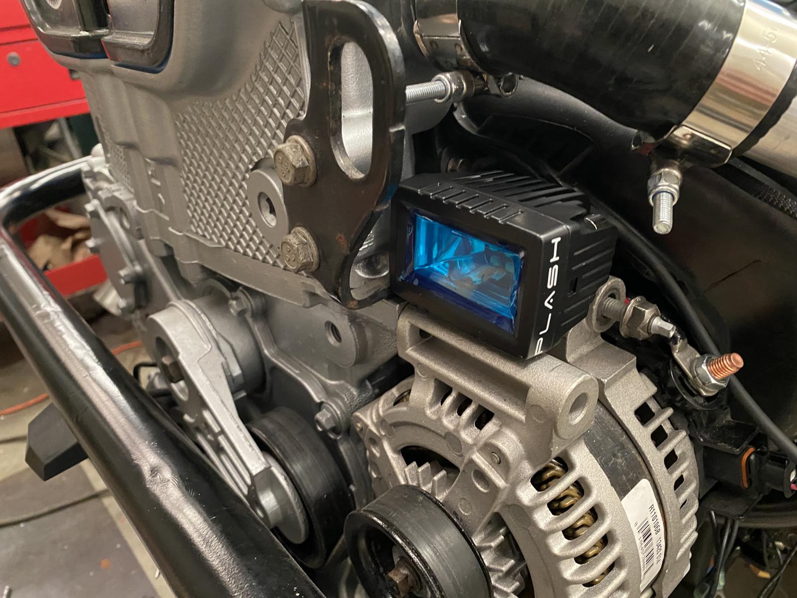

Also Made a little mount for a white reverse light (more of a flood light) over the alternator. I don’t need this to be street legal but it will be nice to have

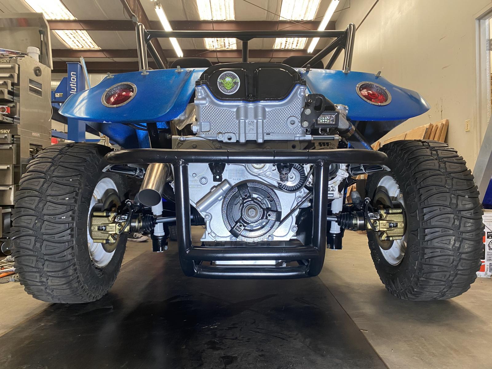

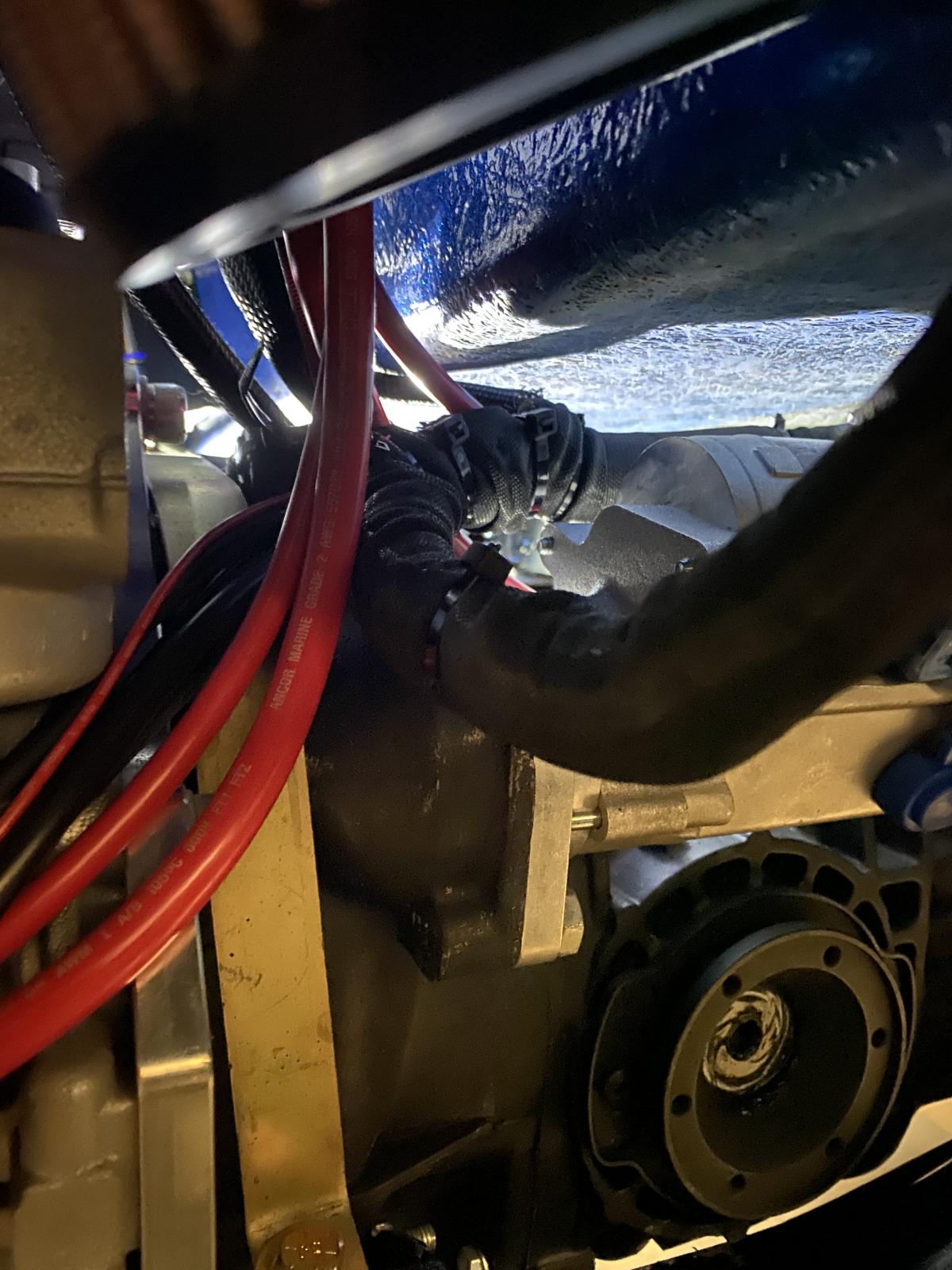

PostPosted: Tue Jun 01, 2021 9:39 pm    Post subject: Re: Manx II “2-Face” Ecotec IRS Bus 091 Reply with quote
Engine and transaxle back in, all wiring except the battery and grounds on, intake on, fuel line connected, Bowden tube in place, same as last time... LOL but I was able to lay the wiring harness out a bit better and it fits/looks better.
Pics because maybe they will show something that could be useful to someone... but really just more of the same

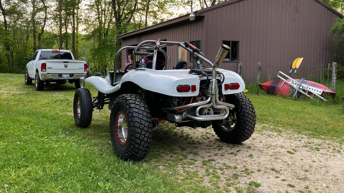

Man that suspension is just right on that thing, nice! That is very similar to what I want to upgrade to maybe next winter.
it's more fun loud and dirty

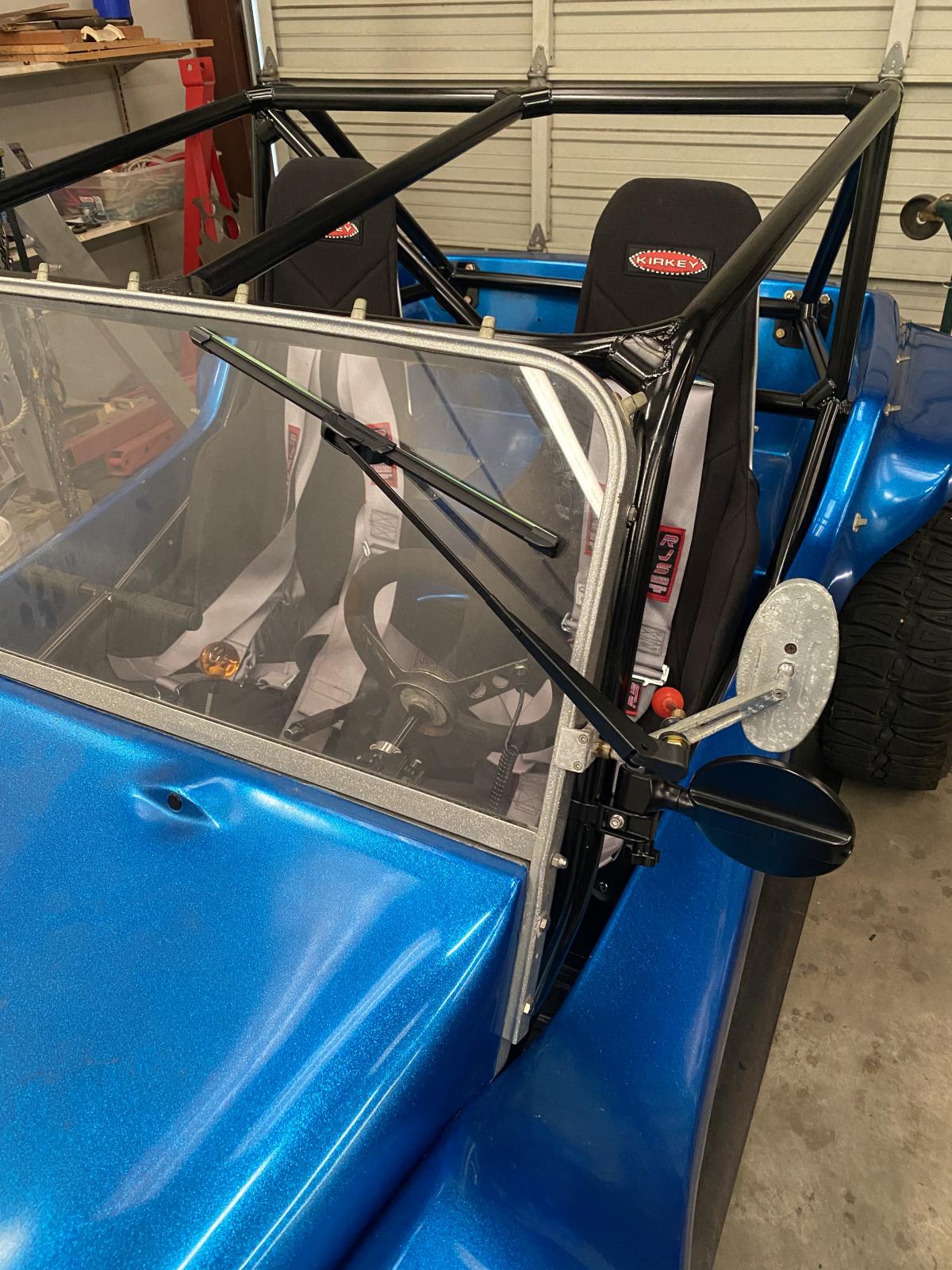

Modified one of the old rear view mirrors to mount a cheap manual wiper, which is required in Texas of you have a windshield.I need to trim the extra arm and mirror off but it works like it is
Fixed a small oil leak on the water pump cover, otherwise it’s running great. The fans don’t shut off once they come on due to the lack of a vss signal so I’ll have to come up with one and pin it to the ecu and tweak the tune, but it’s staying cool so far

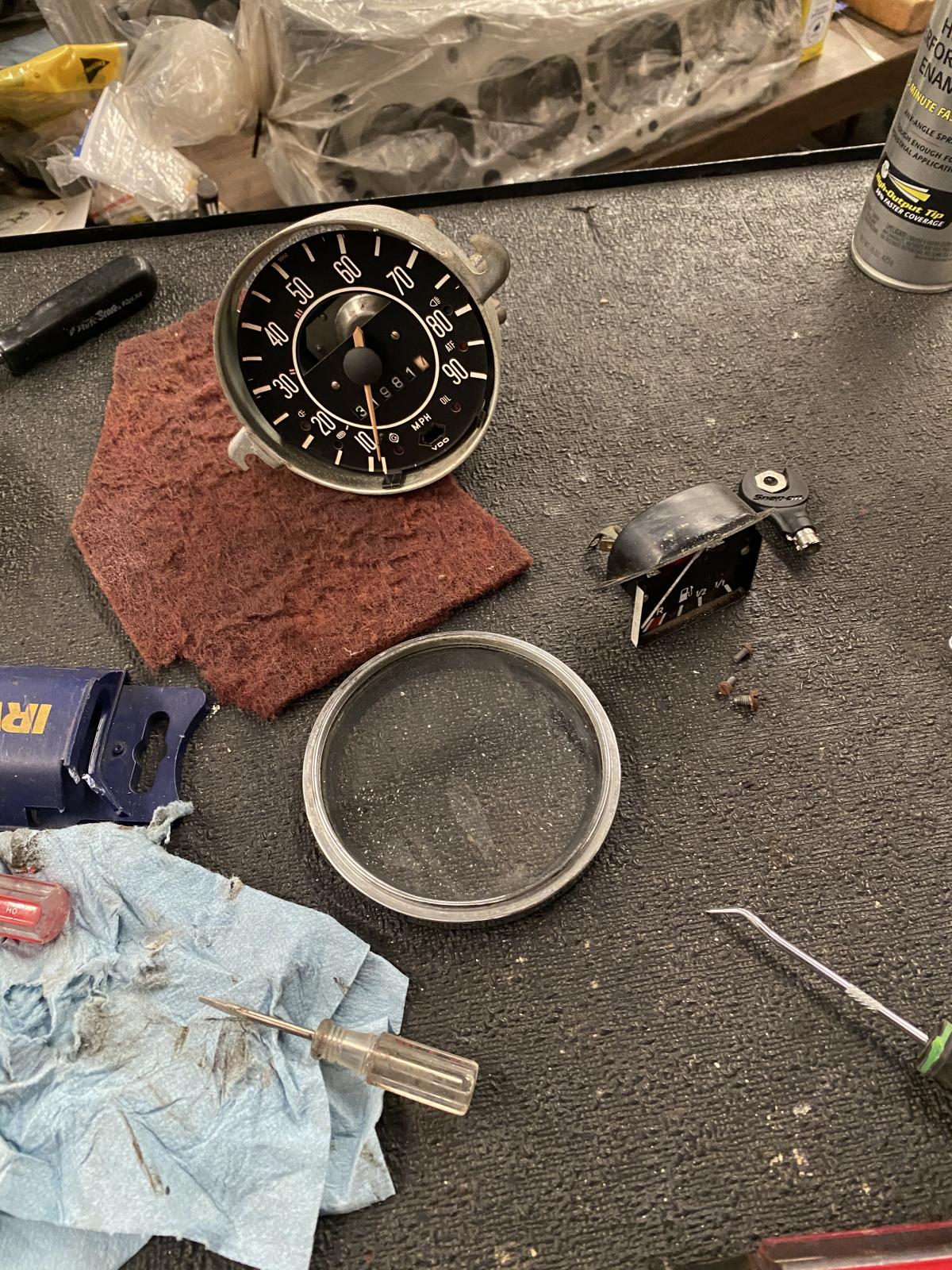

I am also curious about cooling on the highway, and under higher load at low speed like off-road driving. I am trying to get it titled and insured - then i can really start playing with it.
NORRA ‘22 will be fun if I can make it happen. I will have to do a second “build” to get it race ready.

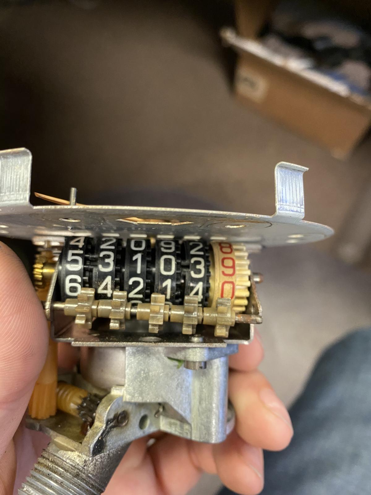

I almost have the speedometer ready to go back together, miles are reset, cleaned up a bit. I really like the old school mechanical gauge look
