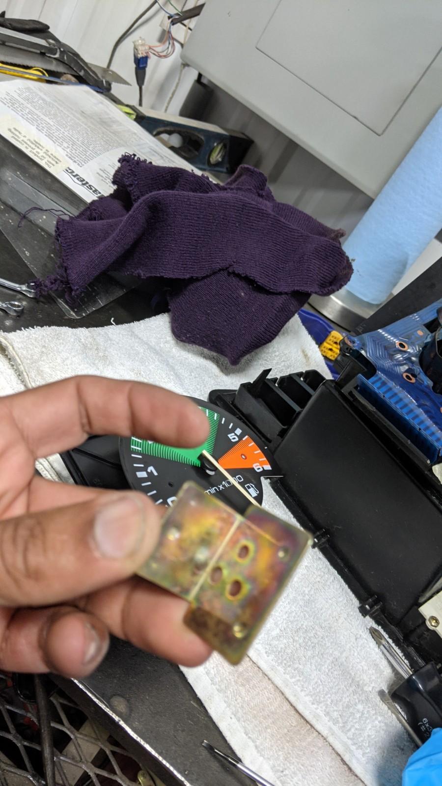

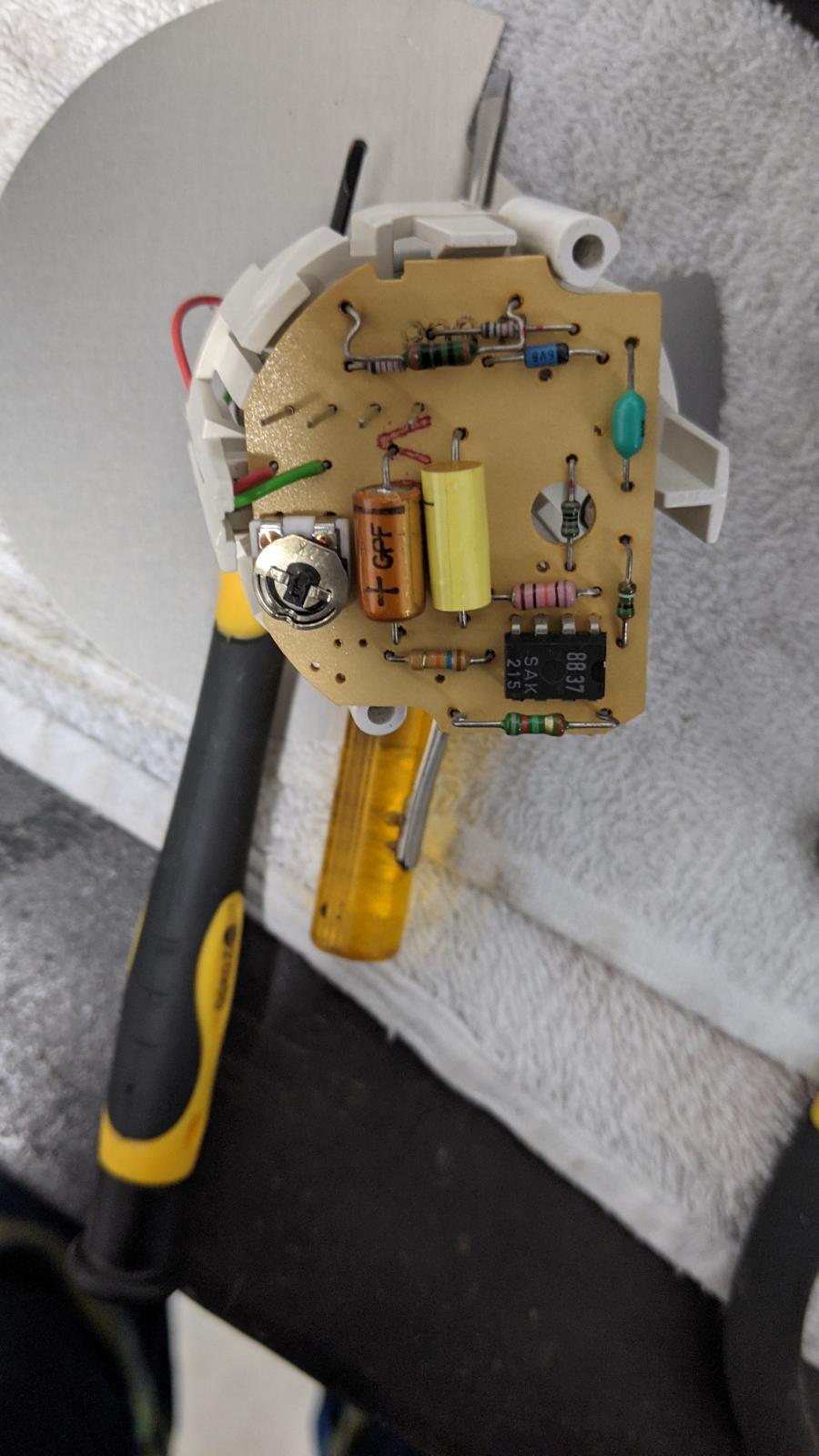

I'm trying to do the Tachometer Modification. I'm following the instructions in the manual to the best of my ability.
1) I've got the tachometer out of the instrument cluster - but I think the needle for the gauge is preventing me from accessing the circuit board. Has anybody else run into this issue?
2) A mystery gold bracket fell out of somewhere(???) when the tachometer was removed. I'm unsure how it re-attaches into the assembly. If anyone could provide some insight or direction it would be greatly appreciated.

I’m not sure what is required of the mod, but I’ve used a dinner fork under the needle to remove it. It will take quite a bit of force. This was at the recommendation of Christopher at T3 Technique in the plasma gauge upgrade.
I just looked at a spare tach on the shelf and don’t believe the mystery bracket is part of your tach assembly.

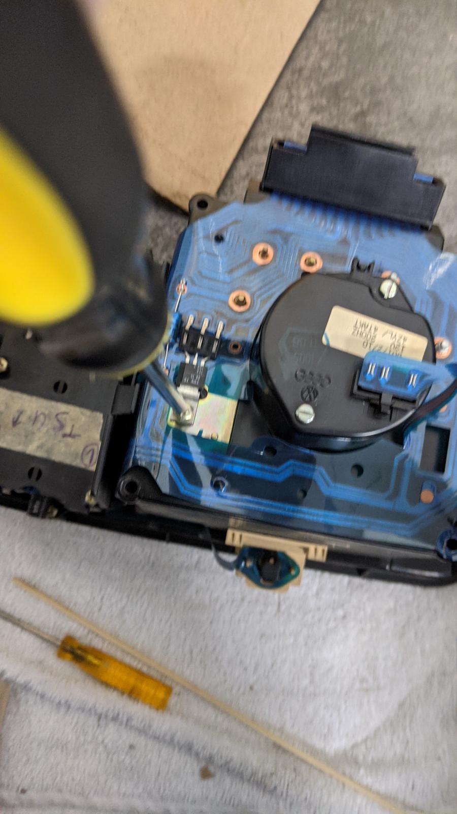

You don't need to remove the needle at all. When you first remove the instrument cluster the circuit board to be modified is visible (circled in red below). It looks like you've already removed it?
I'm not sure what the bracket is for.

Thanks for the replies. The tachometer is in a plastic case. I managed to slide out, remove and get to the circuit board behind.

I'm still fumbling with the tachometer modification. I've removed the tachometer. I've identified the resistor's to remove.
1) In the manual, the new resistor to be soldered is brown(ish) with yellow/red/orange stripe, and positioned at 12 o'clock. Image attached.
2)The only resistor I could find was with the MIL. It's blue, and positioned at 9 o'clock. (rotation, oops) Image attached. Is this the correct resistor?
3) With the MIL Installation instructions, I see no mention of a resistor
Can anyone comment if this resistor is part of the MIL set-up?

I fumbled upon tach answers. I'm posting answers to my own tach questions (bad form?).
1) The blue resistor is the proper resistor to solder in.
2) The 'mystery' brass piece sits behind the blue paper. Pictures attached from :
Bentley manual
and my re-install.
3) I would not recommend de-soldering/re-soldering. I broke the needle off my tach. Upon further samba research, it looks like some people use an empty peanut can or glass to ensure the needle is not snapped when removing old solder. Bostig sells a tachometer signal converter (http://www.bostig.com/tachometer-signal-converter/), which might be a better route to pursue.

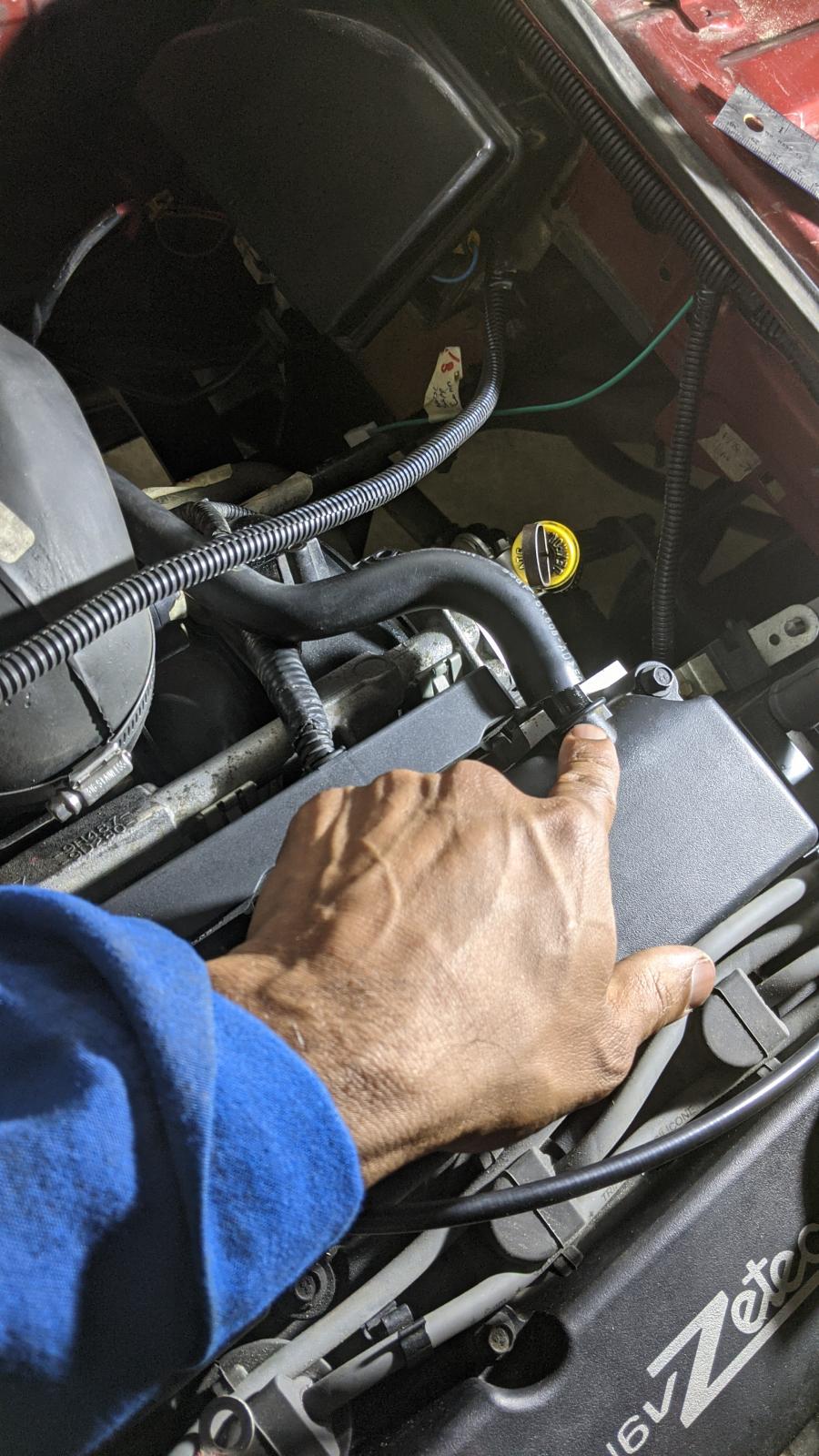

I believe what I am pointing to is the cam cover breather
that is supposed to be connected to the airbox with the 16'' hose.
If anyone could confirm this, it would be greatly appreciated!
Also, are people using clamps to hold onto the cam breather? The hose keeps on slipping off what I believe is the cam cover breather connection.......

dunno about the Bostig in particular but in general the breather is attached to the air cleaner INSIDE the filter box so that if it DOES suck back under negative crankcase pressure, it is filtered air. some vent crankcase pressure to the outside... it keeps the airbox cleaner but at the expense of increased emissions, oil smell, and the possibility of reflux of unfiltered air into the engine. don't do it.
what you need to determine is if the Focus engine uses a PVC valve in that line.

Yes, that's the valve cover breather port, line goes directly to the port on the air filter box. Yes, use clamps on both ends.
There should be a small square piece of foam inside the airbox just inside the port. This helps soak up stray oil.
Disregard the extra bit of grey plastic and tubing on mine in these pictures, I was experimenting with getting the evaporation system working.
Just plug it straight from the valve cover to the airbox.
The PCV valve is on the exhaust side under the header.

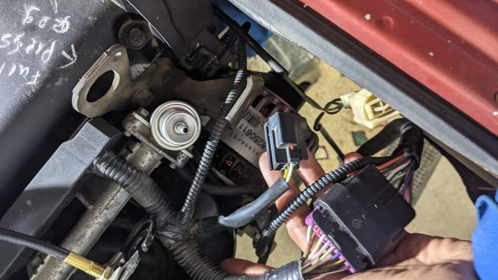

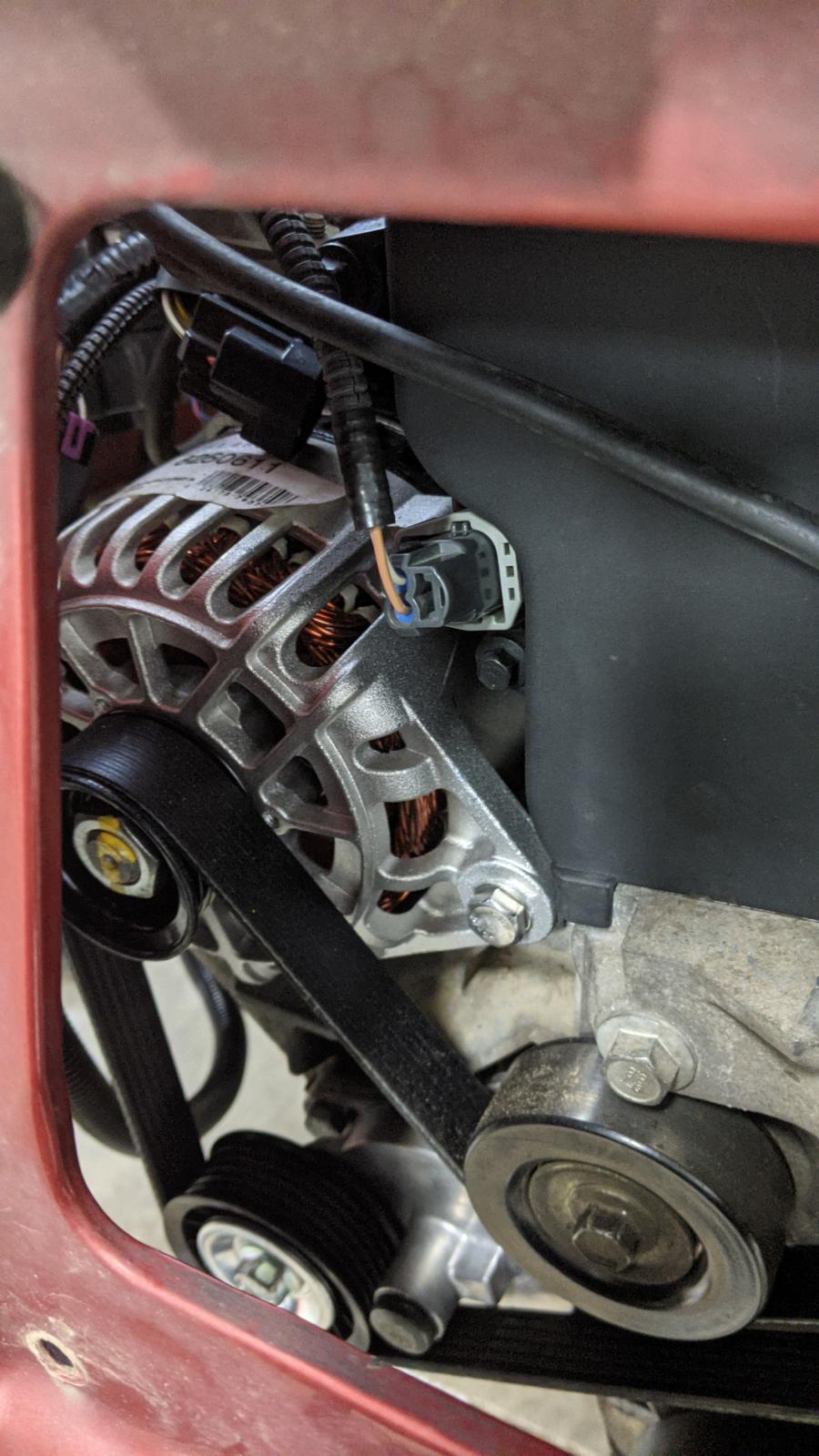

I'm working on SK-W.
On Bostig's harness, the leg that has the injector harness has four (4) connections:
1) Injector Harness Connector
2) Alternator Connect0r
3) One that plugs into the engine, near the cam cover
4) ????
Does anyone have insight of this final connectors home?
MsTaboo
Joined: June 02, 2006
Posts: 4544
MsTaboo is offline
PostPosted: Mon Jul 26, 2021 5:59 pm    Post subject: Re: Bostig - My RG11 build Reply with quote
Unused. Zip tie out of the way.

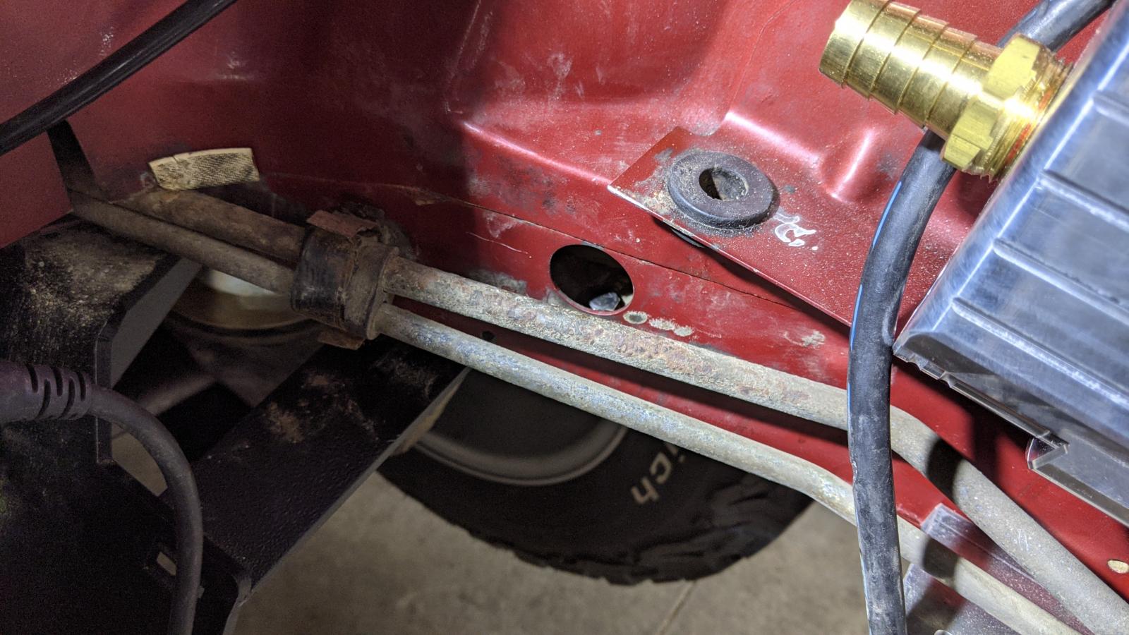

I'm working on hooking up the coolant lines. My van is automatic and has the A/T cooler.
Does anyone know where Jim's scope of supply ends around the cooler?
My original lines around the A/T cooler seem a bit messy - and I'm trying to ensure I'm not going to forget a hose
that is required???
Pictures, if anyone has any, would be helpful.

Tell us--do you have a rear under-seat heater? If not, configure your hoses like a manual transmission. If you have a rear heater, it's more complex.

If by, 'rear under-seat heater,' you mean rear heater core - I do have one of those!
When you say it gets more complex, can you provide details?
