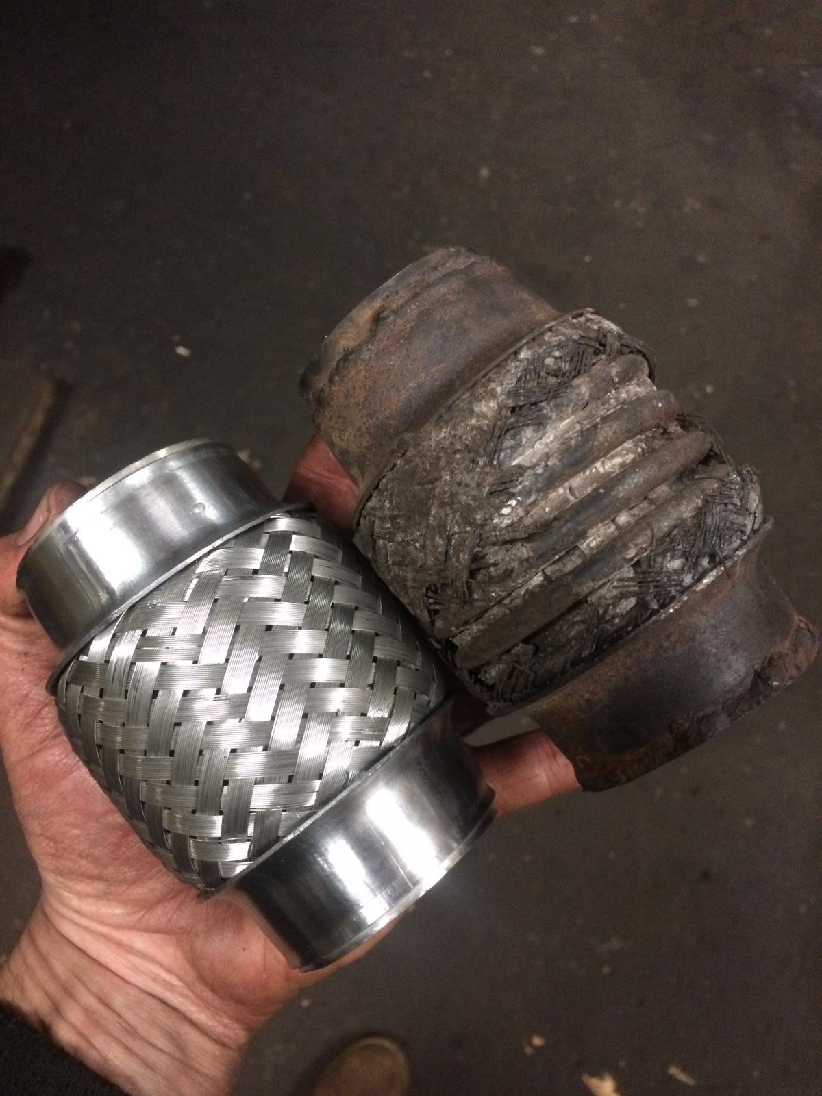

Here's a better view of that flex piece. Again, only three months and three thousand miles on it.
199254 miles on the van and 93 hours on the engine, let's see if this one can hold up to the northeast salt.

does the left rear tire kick up water and road salt toward that bushing?
Neil.
yes it does, still that braided piece should not have crumbled apart like it did.

xoo00oox wrote:
Neil.
Depending on the grade of Stainless, a salt spray that hits a very hot object will certainly turn that coupling to mush real quickly. Maybe wrap it with header tape to keep the salt from penetrating the loose weave and packing the internal ribbed space. I feel that is bound to happen again.

xoo00oox wrote:
Neil.
Though its a somewhat "apples to oranges" comparison, the outside of the bushing on my ABA NA engine still looks ok after at least 10K miles. But then its located higher (closer to manifold) than the bushing you show. But only 3 months and 3000 miles on the bushing you show? I agree. It shouldnt be failing so soon.

jberger wrote:
xoo00oox wrote:
Neil.
I have a feeling it is too. A lot of cars have flex sections like this on the very bottom of the car, Audi for example. They are right before the catalysts. These cars are only a about 6 inches off the ground and get this part dragged through salt and slush for about 10 years before they go bad. I think it was just inferior metal used on the mesh part of this one.
