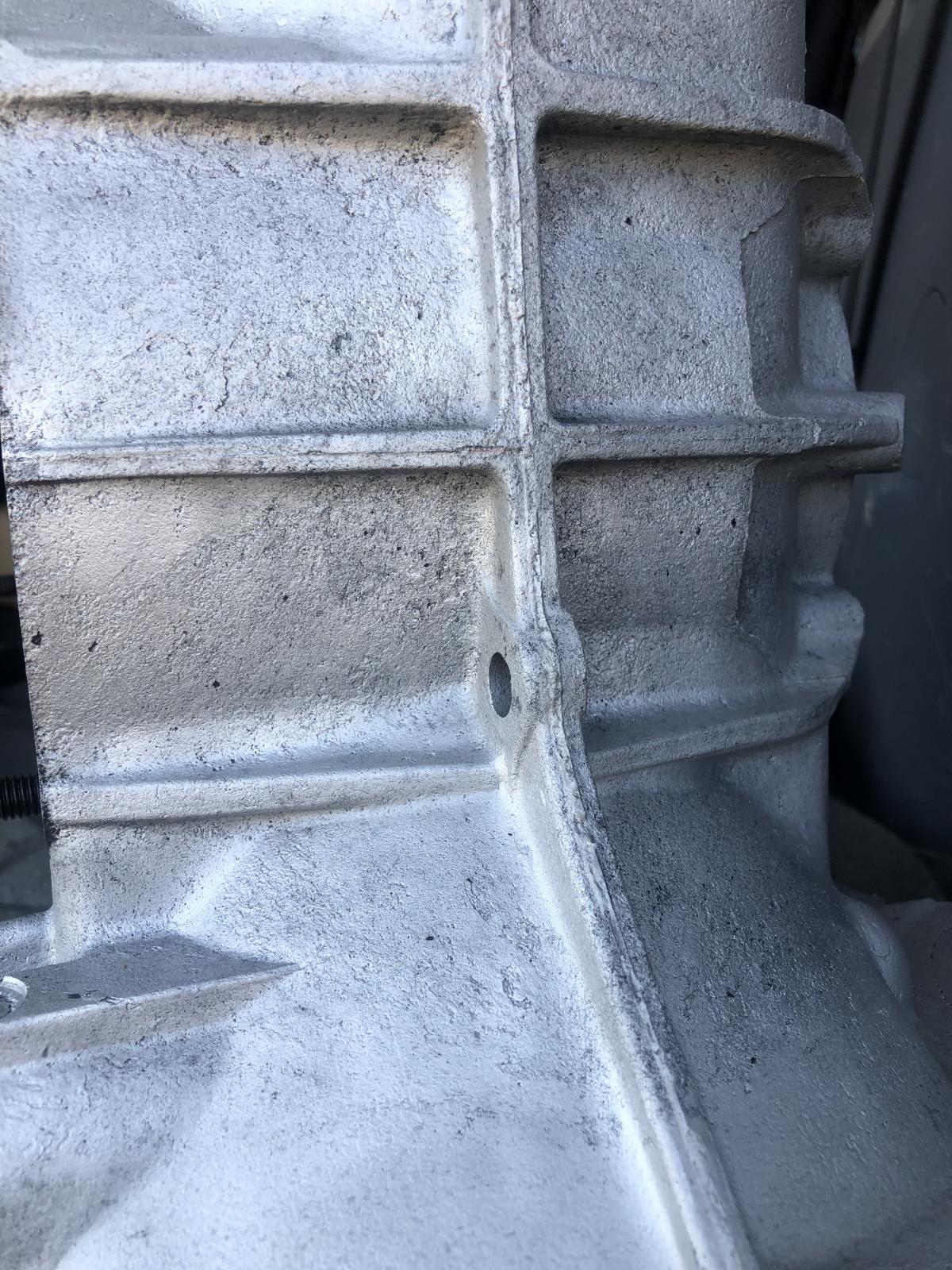

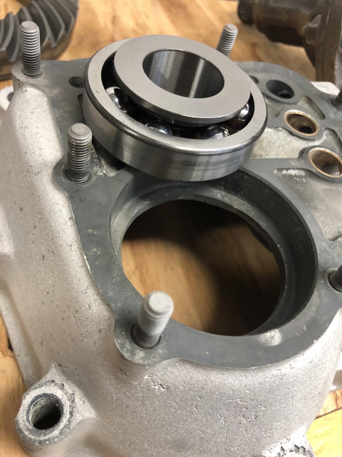

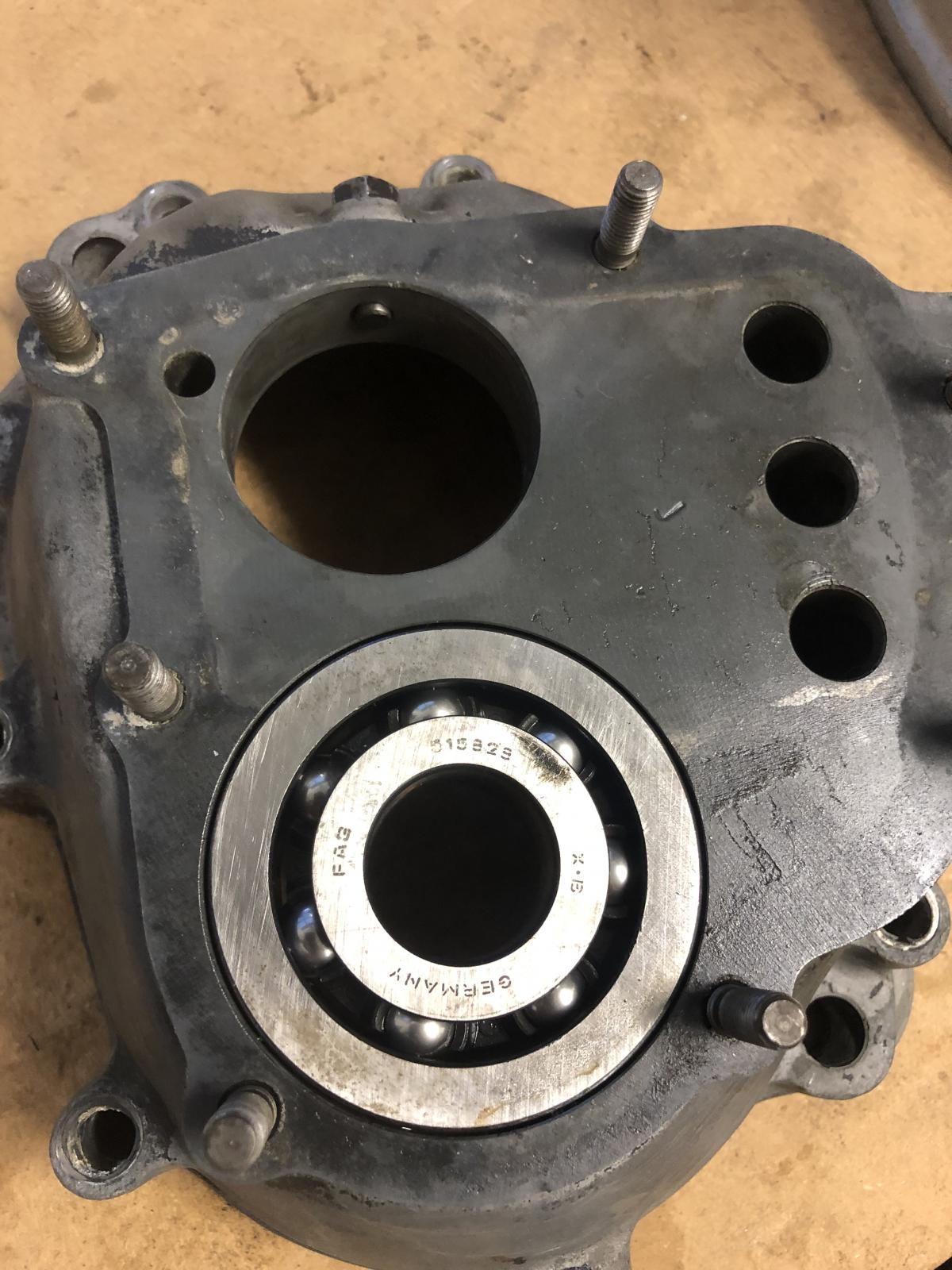

This 091 pinon bearing works with the shift housing with the little 'shelf' at the bottom of the bearing bore, right?
All the other shift housings i have here, the bore for the main-shaft bearing goes clear thru with no 'shelf'.
Like this here.. These parts work together?
(Bearing is upside-down here from how it goes in)
The 091 also eliminates the thrust washer at this bearing, it has the inside race fatter so the thrust washer doesn't go in.
Same with the 091 pinion bearing - thicker so no thrust washer.
Correct?

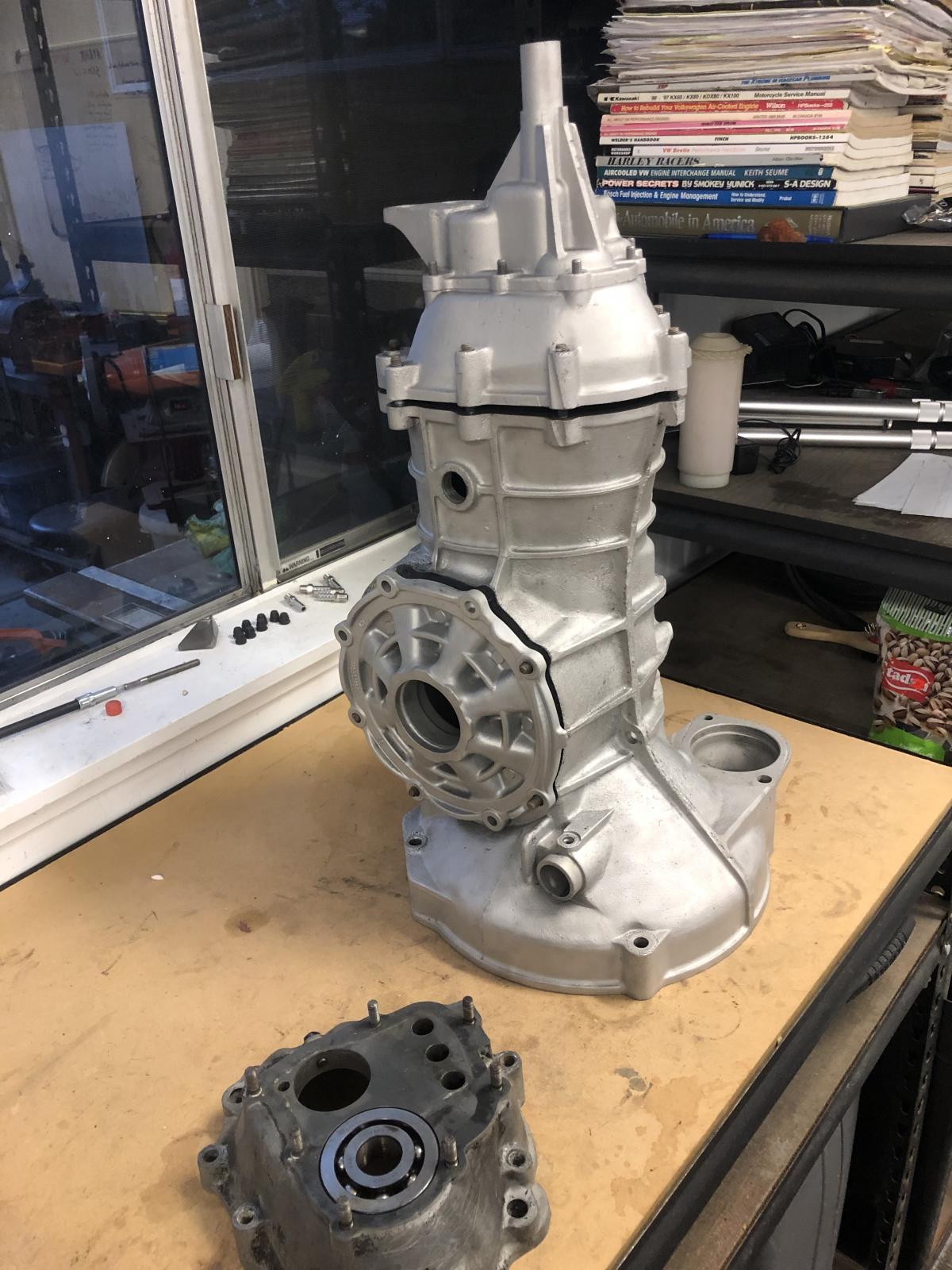

Have two '75-up 'Zig-Zag'/'Shift-rib' boxes here, that i haven't taken apart to make my dream trans out of once i know how.
And that led me to drinking beer and staring and thinking...
(Never a good thing)
And it came to me.
Have the whole IRS diff and parts left over from the Mystery trans to convert one of the swing boxes to IRS.
Both of those swing boxes were good shape and recent rebuilds.
Why not build a box from those parts?
A quick-n' dirty slam-it-together like i shoulda done in the first place! Idea
Then i can get thru one rebuild and stab it in and try it out and see what i did wrong.
The parts are all clean and sitting here.
Needed carrier bearings and diff shims and gasket set and one of those adaptor sleeves for the throwout..
So ordered all that from Weddle, packed away all the nice new expensive stuff for the Dirt box, and broke out the Failed Rebuild box.
Time for the 'ol Quick N' Dirty i shoulda been doing all along!

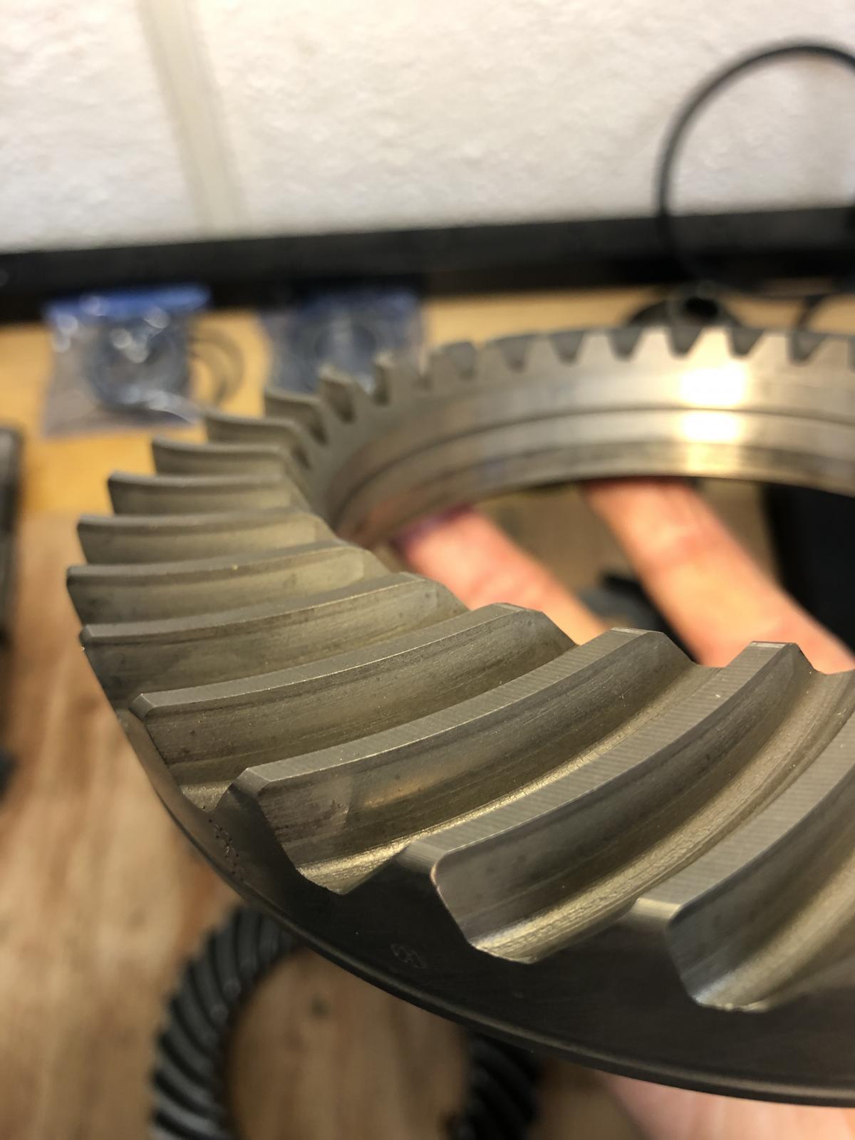

First thing... R&P.
Hoping someone who knows can help look at these.. Pray
Are these OK to run Question

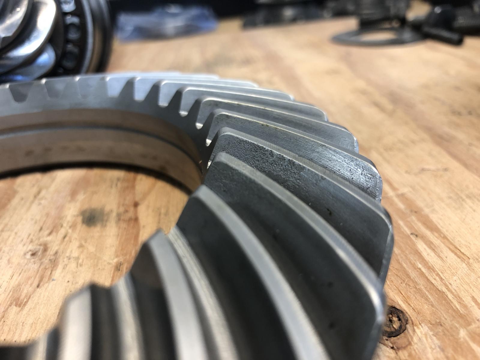

Looking at these two G 4.12 ring n' pinions;
Failed Rebuild on the right (with bearing) Dirt Box on the left (bare)..
Failed Rebuild has these pitted areas. think it's OK?
Seems the Dirt one is better?
What you think?
Are these any good?

They 'broke the edges' as we called it in a prototype machine shop BITD.
A.k.a. the sharp edges of the gears were ground away to a little radius.
Before:
After:

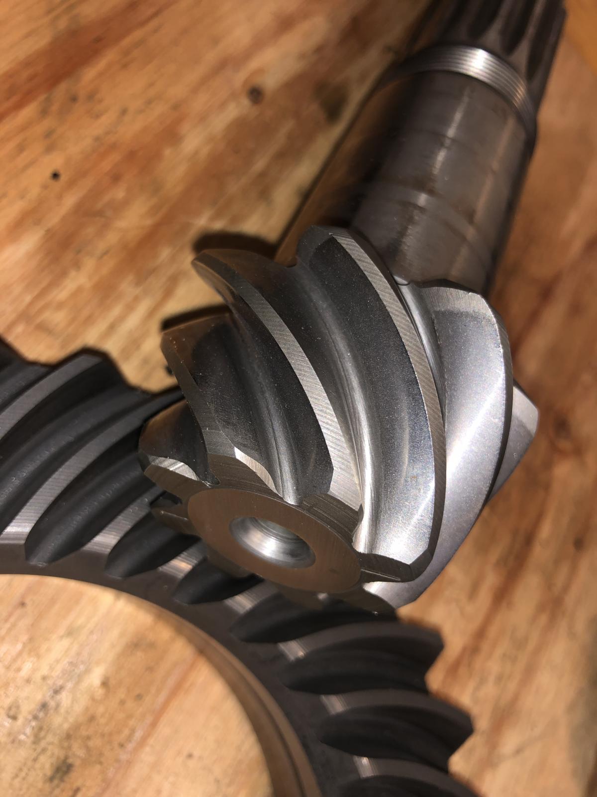

Same with the edges of the pinion:
Looking at the teeth themselves, there is a burr all along the tips of the teeth on the OG R&P,
That was ground away on the rebuilt one.
Is that what Gears and others call "Tip Relieved"?
That's a generally-accepted good practice, right?
To take and round any sharp edges a bit, especially on gear teeth..
Got these diamond-tip Dremel bits for cheap a couple years ago when i did my Porsche trans.
Guessing these are good for breaking the edges of all the gear teeth,
Making them "Tip Relieved"?
Or are these just way too small?
Maybe use a roloc?

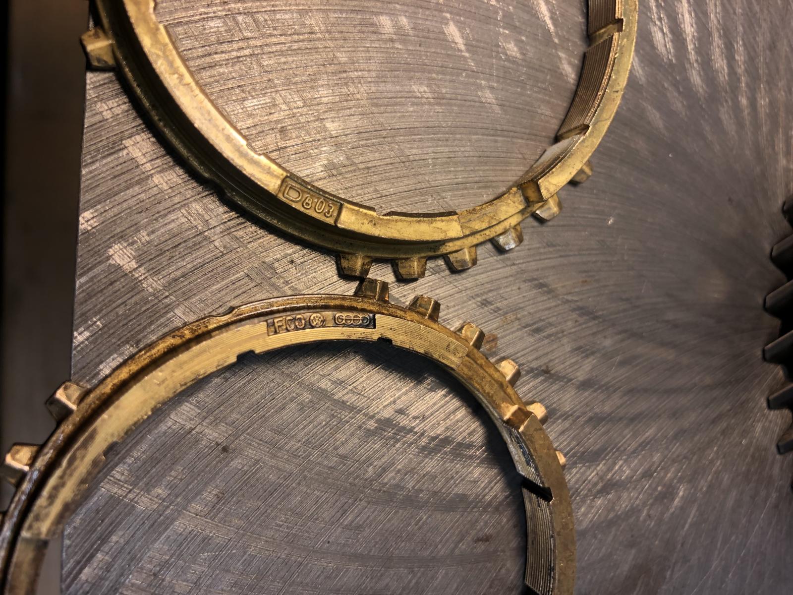

That the synchros were the new Brazil Diehl brand that sit too high on the cones?
Will need to measure the height,
But,
That's what we have here?
The D means new Brazil synchros, right?

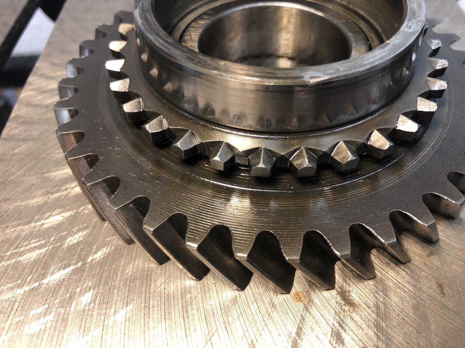

Started playing with a pinion stack:
They didn't get 3rd gear clip very tight.
First gear kind of sucks.
Got a way better one from the other swing core.
Since i bought all new steel-caged rollers for the Dirt box i have a bunch of longer paired-needle rollers in steel cages.
Makes me want to change out this short-needle plastic-cage bearing here.

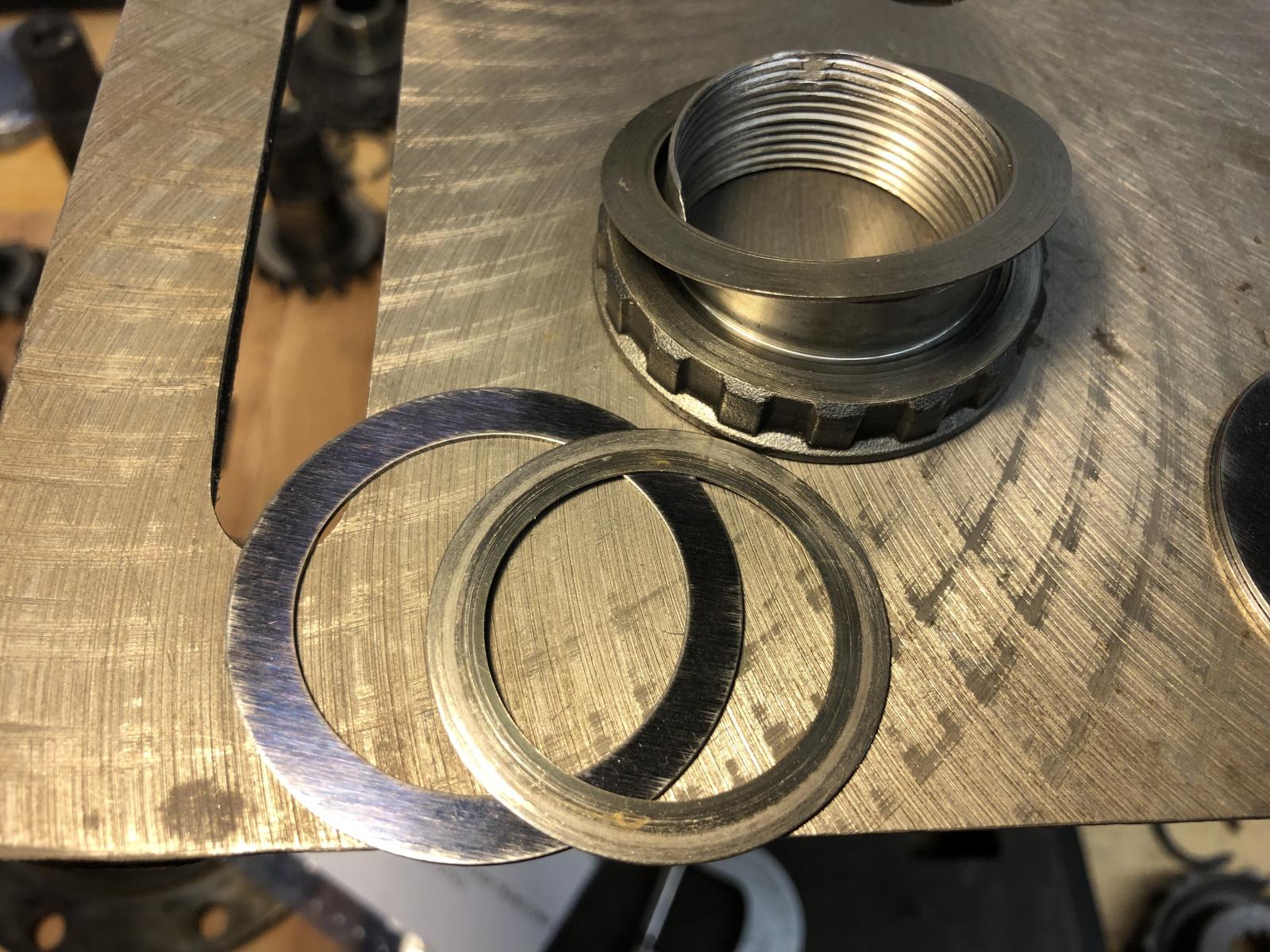

Turns out that these early nuts take smaller shims, and i didn't have any more of those.

And since i couldn't get the nut off to use a later nut/shims, and didn't have any more shims, i sanded down the gear to get a few more thou clearance.
Damn! LOT if humping on the old 220 wet/dry to get a couple more thou clearance! Shocked
Washer under there was pretty crooked, but at least .005 all the way around.
Weddle only has a couple sizes of 3rd gear snap rings in stock and a got a few for to surface grind and get a variety of sizes.
One was SO close! but sanding and sanding i finally gave up.
One from the other box was -almost thick enough to fit tight,
Gave about .003 - .004, which is what the Bible says it should have,
So i went with that one.
No need to fuss getting this snap ring tight on a stock junker box anyways.. Right?
Got the pinion stack assembled,
Drug out the cleaned case,
blasted up some side covers,
And sat there making VROOM noises.

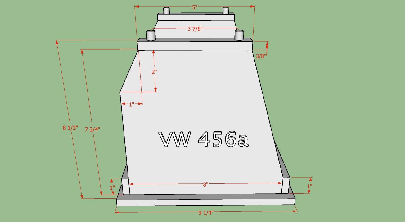

As for my blocks of wood, I'm thinking they might be modified a bit, maybe screw a couple of 2x4s to hold them in place,
But I'm not planning on building more than a few transaxles.
The 456a tool might be easy to build if a guy had his own machine shop...
Got my case back from vapor-blast over the weekend.
It was $50 for the sandblast, then $100 for the vapor.
Woulda cost a LOT more if i didn't have the major dirt crust sandblasted off first.
This particular case spent it's life on dirt roads. It was BAD.
There's still some bits of black goo at the bottoms of pits and crevices.
Plus, they doused it with some kind of thin oil afterwards.
Betting that paint won't stick to it even with a tanking or a couple trips thru the dishwasher.
Maybe I'll try the Gibbs on it after it's all re-assembled..? Think

The oldest swing box from my car had a rebuild at least 25+ years ago.
Looks like they had nice German FAG mainshaft bearings back then.
Low miles and smooth as silk..
Also,
This shows the 'cage flip' that Scott mentioned, right?
