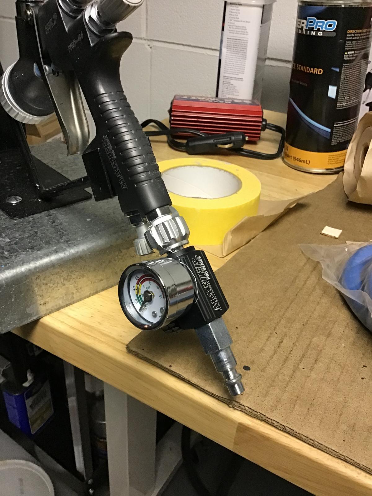

I’m also going to play with my gun settings and concentrate on getting as fine a paint droplets as possible. The pressure regulator/guage that came with the gun only reads 20-22psi when set to max. To my understanding I should be able to set the gun much higher if necessary.

As for the gun, hvlp guns don't need much pressure. 20-25 should be enough pressure. You're gage looks like it does go up more maybe the knob right on top of it isn't open all the way double check that.
The droplet size depends on the tip on the gun. Usually 1.4 or 1.3 with euro clear you could get away with 1.2 but idk what your gun has.
Also more pressure will just create more overspray and waste material so check the tip being used first, then check the fan and material knobs. Check your speed while painting, see what the paint does and then change the pressure as needed.
