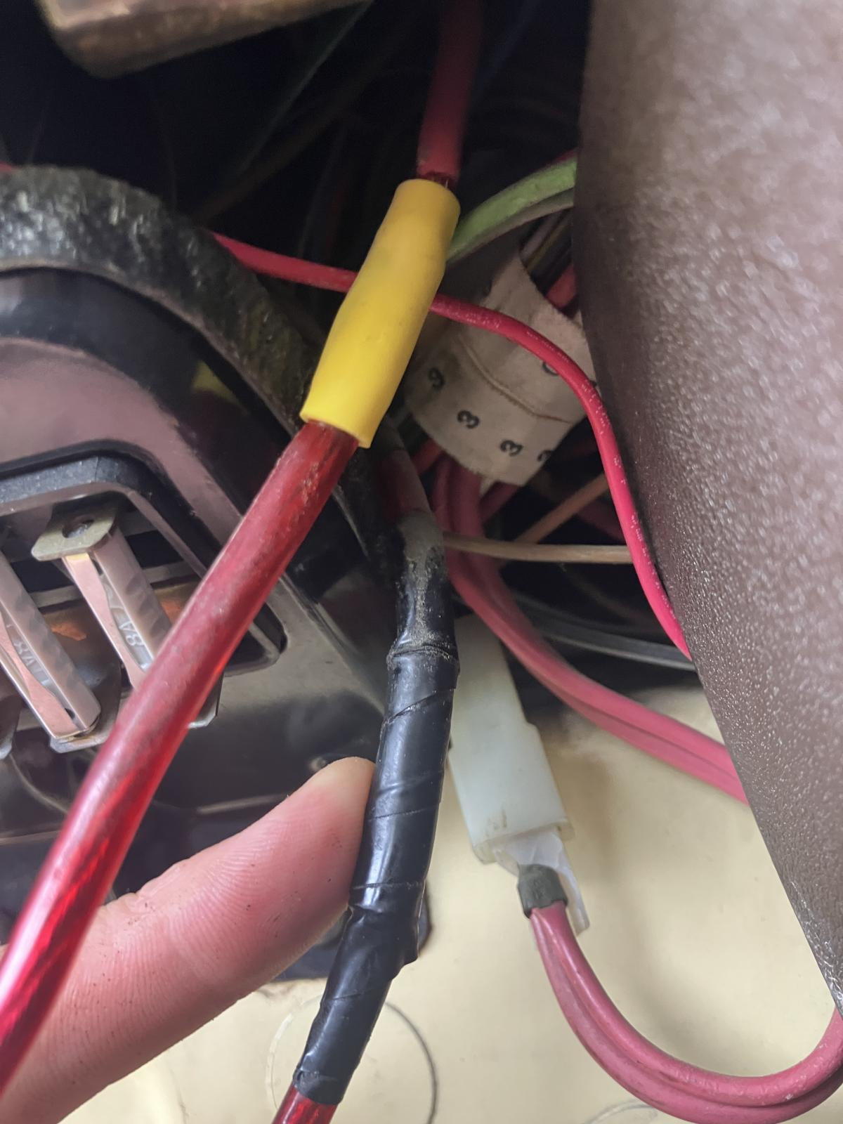

Hey Guys,
I think I've found the correct thread
I have a 1982 EJ25 Vanagon and am having trouble with the RAD FAN fuse. I have the newer 450W Bosch Fan although its not new new but the later years one.
I have a little fuse box that has bypassed the main circuit board but that is heating the fuse really good. So Its supposed to be a 30a fuse. About two years ago it would pop the 30a fuse after the second time the fan would turn on. I have been using a 35a fuse ever since. What happens now though is the box gets too hot and has started to melt the plastic. I had a long road work stop and go the other day and the thing started smoking so I pulled the fuse out and then just monitored the engine temperature like a hawk. Today I started picking the plastic out of that fuse box. I think the wiring looks good, I cleaned the connecters at the fan itself but just not sure where to go from here. Its probably to get a new fuse box cord since this one now most definitely has plastic shrapnel within it no matter how hard I tried to clean. It sounds like this could be a resistance issue now with the heat up.

paulcolorado21 wrote:
Hey Guys,
I have a little fuse box that has bypassed the main circuit board but that is heating the fuse really good. So Its supposed to be a 30a fuse. About two years ago it would pop the 30a fuse after the second time the fan would turn on. I have been using a 35a fuse ever since. What happens now though is the box gets too hot and has started to melt the plastic. I had a long road work stop and go the other day and the thing started smoking so I pulled the fuse out and then just monitored the engine temperature like a hawk. Today I started picking the plastic out of that fuse box. I think the wiring looks good, I cleaned the connecters at the fan itself but just not sure where to go from here. It’s probably to get a new fuse box cord since this one now most definitely has plastic shrapnel within it no matter how hard I tried to clean. It sounds like this could be a resistance issue now with the heat up.
Not knowing how that inline fuse holder is installed, the real test would be to check the amp draw on that circuit. That it was blowing 30 amp fuses out the gate indicates something is amiss.
The one yellow crimp looks questionable. Certainly redoing the fuse holder wouldn’t hurt, but oversizing the fuse could be hiding a problem.
