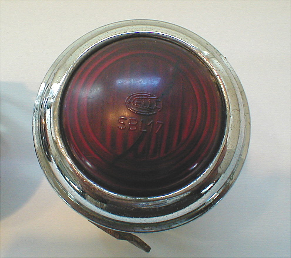

rocketpower wrote:
Great info, thanks. Now if I can figure out the tai lights, if they are sbl 17 or the late barn door style, anyone?
Is it an April 55 semaphore bus? Then it would be single filiment glass Hella K1546. These were post barndoor for all buses until the semaphores were dropped for North America in April/May 1955. European buses ran these to 58?
Non semaphore will be early SBL17 and also have the square reflector holes.
This is a mid April 55 standard microbus. Look up photos from ol36er.

dmuis wrote:
This is almost correct. April 55 would have the flat euro taillights and semaphores as pictured above. If you have bullet turn signals then you need the bubble taillights, but being wolfsburg production it would have had only a Hella logo on the glass and the chrome rings would be stamped VW and Hella as well. Post Wolfsburg the bubble taillights lost markings in the chrome and the lenses were marked SBL17. All bubble taillights had reflectors below them that were mounted in the square holes.

PostPosted: Fri May 28, 2021 5:44 am    Post subject: Re: Post Barndoor, Wolfsburg Bus Features And Changes Reply with quote
Ok got it, thanks ! its a non semaphore bus. So it will need the early sbl17s on it. I guess ill start looking now...
