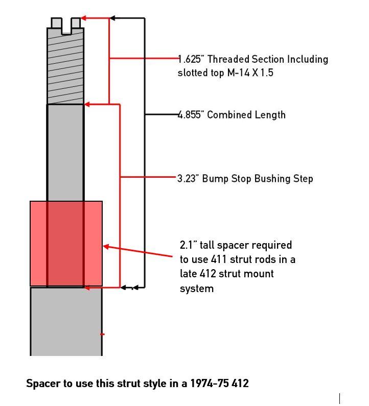

In order for these Bilstein strut cartridges to actually fit a 411 of any kind...they MUST have the shape and dimensions shown on the left above. The one that fits your 1974 412...is shown on the right.
BUT....the early 411 strut cartridges CAN be made to fit in a late 412....with a bushing like the one shown below. In fact...this actual bushing is PART OF THE 411 BUMP STOP SYSTEM.
So in fact....the 1968 to 1973 strut cartridges are the same total length as the struts in 1974 (within a small margin). BUT....the 411's and early 412's have a totally different bump stop which has a steel spacer inside...like the one shown above.
To use this "early" strut in your 412...you need those 2.1" spacers...and about another 12mm of spacer washers that are normally installed on the late 412 strut.
So...make your mechanic pull you struts out and strip them down and show us the "stack up"...and I can tell you what you need to make these work.
