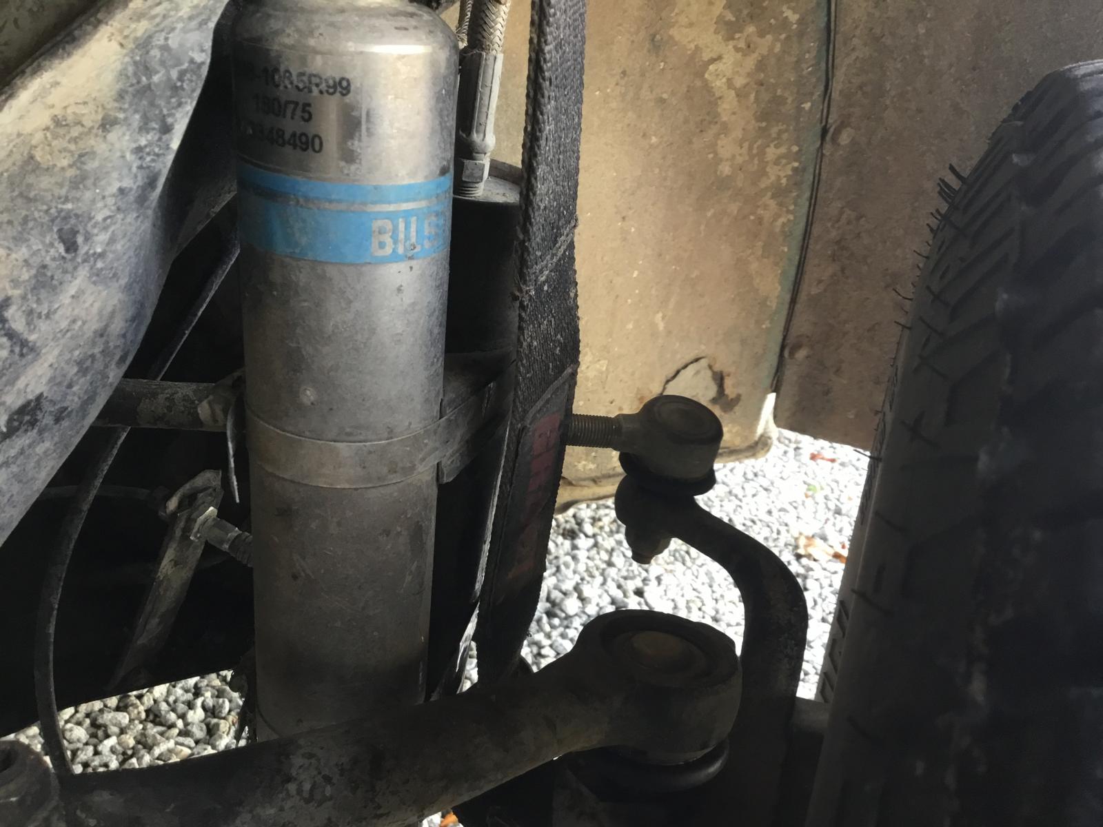

I’ve had the yellow 7100 shock, but felt too much like a buckboard.
I’ve the 7100 with the reservoir. Had them valves with 180/75 and feels smoother. Beam is cut and turned a bit and have 3” raised spindles.
After blowing through ball joints, added the limiting straps. So far. So good.

TD, I may go the hook and rod method at some point. For now, I’m satisfied with the limiting straps.

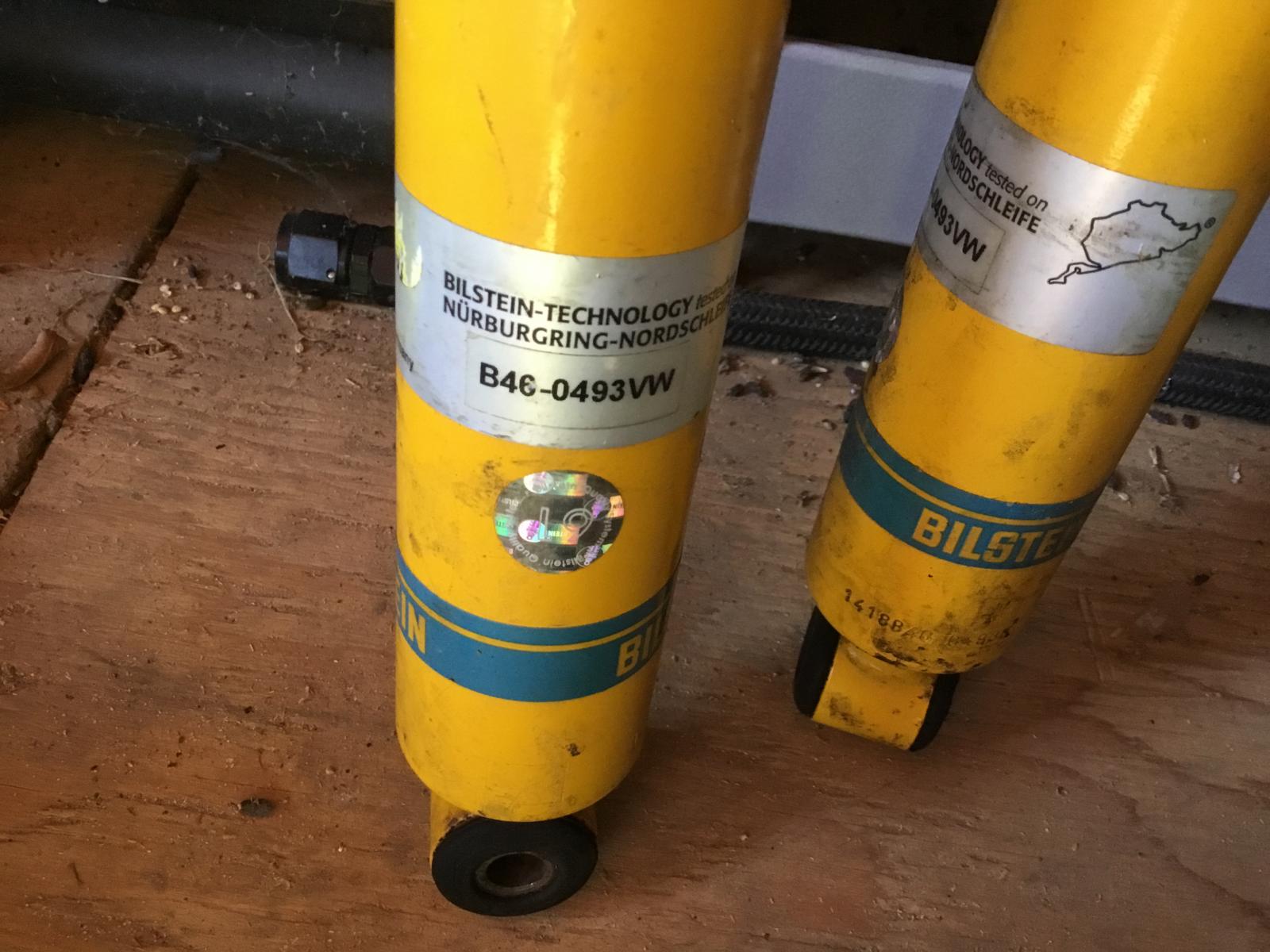

Does anyone on here with the 7100's with the rubber bump stops know if the compressed and extended lengths listed in the catalog include the bumper and washers length or not?
For anyone interested in the 3" longer KYB 343135 shocks I did order some because having a shock I could swing by any autozone and grab a cheap replacement was an attractive idea but as soon as I got them in I saw they weren't going to work. The empi catalog says they fit and I suppose all the other VW parts shops just take their word for it . The issue with them is the lower bushings that are set up to work on old American boats like Vista Cruisers and stuff so they have the hourglass bushing with the 5/8 id. They tell you you need Kit 107 for them to work but Kit 107 just supplies you with 12mm idx32mm sleeves that are too short for the bushing. You'd either have to trim the extra rubber away, or find a longer sleeve which in my opinion would take up too much shock post so you'd barely be able to get a single lock nut on.
Also in my case the compressed length on paper works but once you add the washer and top bushing the compressed length cuts into my ball joint travel ever so slightly so it looks like I'm sending them back and getting some Bilsteins.
I need a compressed length under 12" so B46-0493VW should be the best fit for me but it looks like they also sell the F4-BOA-0000304 which is a little fancier , has a bump stop,. and also claims to be for cut and turned beams, but every site I go to has a different set of lengths listed for it so I dunno what to believe. |

B46-0493VW's inbound. |

I know the catalog lists it but a lot of the places I was finding them to buy were listing different measurements which is what was confusing me. But I ended up going with the B46-0493VW because it should be the best fit, and they were in stock and fit the budget.
Annoying they don't come with the boot, or do most people run them without? Anyone know if the blue plastic accordion bilstein boots work on these, not a huge fan of the smooth ones. |
