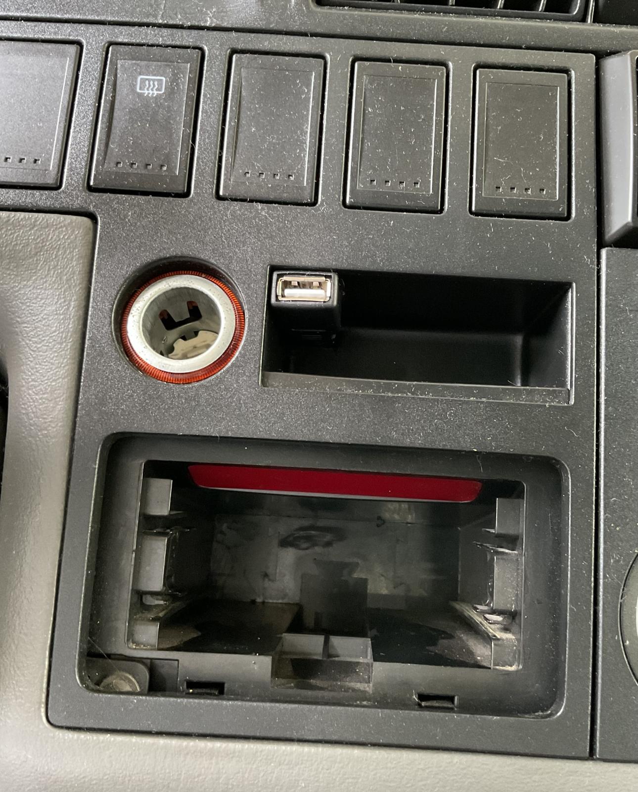

I would really like to mount a fancy double DIN Panasonic unit I already have.
I know this is a bad idea but...
What is that metal support bar that gets in the way? Is it a true structural piece of the front end, or can it be hacked way to make room for a full double DIN unit?

Hi! I'm reviewing your post. I'm so confused tho— the Sony unit spec says it's 4" deep.
I'm measuring the hole in the dash, from flush to that metal bracket in the back that divides the space side-to-side in the center, and the depth I'm measuring is 2 1/3 inches.
But these radios measure it 4+ inches deep.
How did you get that flush?
I'll post this to the original post too. I just wanted to make sure you saw it. I'd love your input on this if you can and you care to please.
Thanks!
Jeff

These Sony XAV units are a bit unique in the form factor, making them a good choice for upgrades to the stock stereo system, with minimal to no permanent modifications. The touch screen is makes the unit appear to be a double DIN form factor but the main chassis of the unit is only single DIN, and relatively shallow at around 4" (+ a bit more for wire routing). The screen actually cantilevers down from the chassis. Hard to describe in words but if you scroll through the pics at the link below you'll see what I mean:
https://www.crutchfield.com/S-lTU2sp4N7eB/p_158XAV1000/Sony-XAV-AX1000.html#&gid=1&pid=5
It may not be the exact model but the XAV family all have similar form factors.
If you're lucky/patient enough to source an OEM trim bezel for the HVAC controls that eliminates the little cubby between the HVAC controls and the radio, you can make this radio upgrade with no permanent changes to your dash. These are hard to find though (european parts/junk yards are your best bet).
Otherwise, you can simply trim the existing bezel (basically cut off the cubby) to remove the interference with the cantilevered screen. If you are careful about cutting and finishing the edge cleanly, it will look "stock" to most any person.
If you're worried about originality, you can always make the mod to the stock trim, source a new trim bezel (from US used parts specialists) to keep on hand with the stock radio for eventual restoration to stock.
