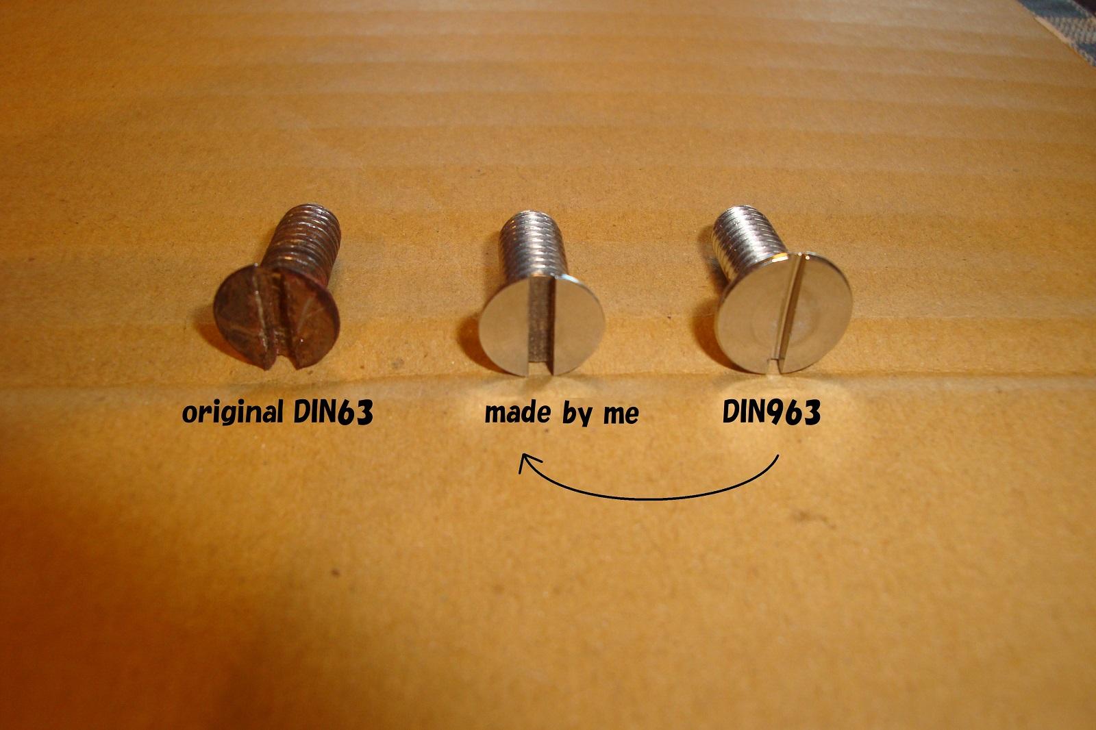

Hello
I want to change the engine lid hinge bolts in my 54 samba.
My engine lid hinge has six "phillips-head screw" and one "minus head screw" now.
Two are lost.
Which one is the original?
phillips-head or minus head.
Yuichiro

Well, yes…M6x1.0, slotted, 16mm
But
1. Original screws had a conical point to make it easier to locate the screw when fitting the decklid
2. Modern day screws have a larger diameter head (11mm) than the old DIN63 spec (prob 9mm or so)
2) means modern day screws don’t seat properly in the hinge recess…they sit high
If anyone has a solution…or a source for the old DIN63 screws…let it be known!
I had some modern screws machined down.
The decklids were fitted when the Barndoors were painted…but the hinge area did not get hit with much paint at all because of its hidden position. As we know, the Barndoor decklid hinge area/decklid fixing point is a rust trap, due to this lack of paint and its ability to hold water. I’d just paint the screws grey, to match the undercoat/primer.
-StockRocks-

I ended up throwing newly available screws on a lathe. not as simple a task as buying off the shelf but did the job

Oh, that makes sense!
Screwhead is 12mm in diameter. I was going to buy it.
slotted of my Samba is about 10mm.
After all the one that bought DIN63 looks good.
I want to change luggage rail screws.
I was looking for similar slotted head.
Is the diameter of head different?
After all the one that bought DIN85, DIN91 looks good.

I removed bulkhead grab bar screw.
Is the angle of the lower part same as DIN63? 90 degrees?
The upper curve is slow.
Diameter of head is around 10mm both.
In DIN63, length is 12mm. It is shorter than 15mm.
In DIN91, length is 23mm. It is longer than 20mm.
Why?
Does Screw sold as DIN91 have a big head now?

No, Actually your screws are fully correct to German DIN specs.
With countersunk screws length is measured from the top surface of countersunk hole ( around the perimeter of the screw head) to the top of the threads.
Obviously this is longer than the threads only. it is just the way countersunk DIN screws are defined.
also the heads ARE different. the screws for the engine lid hinge have a totally flat head. ( because actually they must have for proper clearance when hinge is closed)
The other screws ( mostly those which are fully visible on trim parts) have a slightly domed shape on the head. In German this is called 'Linsenkopfschraube' for a panhead screw like on the luggage rails or as stated in the parts list 'Linsensenkschraube' for the handles if it has a crowned AND countersunk head shape.
They are called Linsen....
Because it has the shape of a lens.

You're right.
My DIN63 is M6x15mm.
My DIN91 is M6x25mm.
Balkhead grab bar originally has M6x20mm.
That means, it is right that Luggage bar Uprights has this DIN91.
http://www.autocrafteng.co.uk/shop/fasteners-fixin...-964_1911/
I think That most of sold DIN91 have size of DIN964 now.
https://www.globalfastener.com/standards/detail_527.html?lidpost=20051#parameter
Screwhead is big. it is 11mm in diameter.
I think this screw to be DIN964 and resemble a photograph by RockStock.
https://www.thesamba.com/vw/classifieds/detail.php?id=2267641
I have to be careful.
When I buy DIN91, It may be DIN964.

Unfortunately that may be true. If the screws are stainless, you could machine down the head surface. the angle of 90° countersink will not be disturbed.
If you have repro grab bar ends, you could drill a larger countersink ( would never suggest that with og parts)
I am not associated with this shop, but they may have what you need.
DIN 91 M6x20
They are chromed and polished too !
The German note explicitly says that they are the 'old style with small head'.
https://www.chromschrauben24.de/DIN_91.php?page=gewinde
they also carry the DIN63 6x16, but they are chrome. ( not og finish for bus)
https://www.chromschrauben24.de/DIN_63.php?page=gewinde
you could as well simply touch them up with a small brush and black paint, once they are mounted.

I made reproduction.
