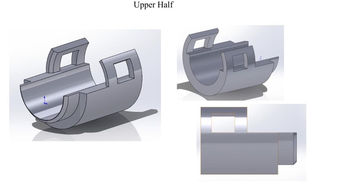

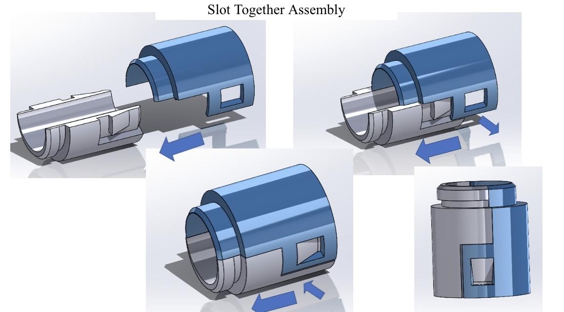

This is what I’m thinking of.
Using the fact that the lower has twice the space for the lip to be placed.
The upper then sliding in from behind.
Connecting like this.
It’s interesting to see that the one at cip has another way to lock in via the threaded rod. I wonder if that would be needed with my rear clip fit idea works.

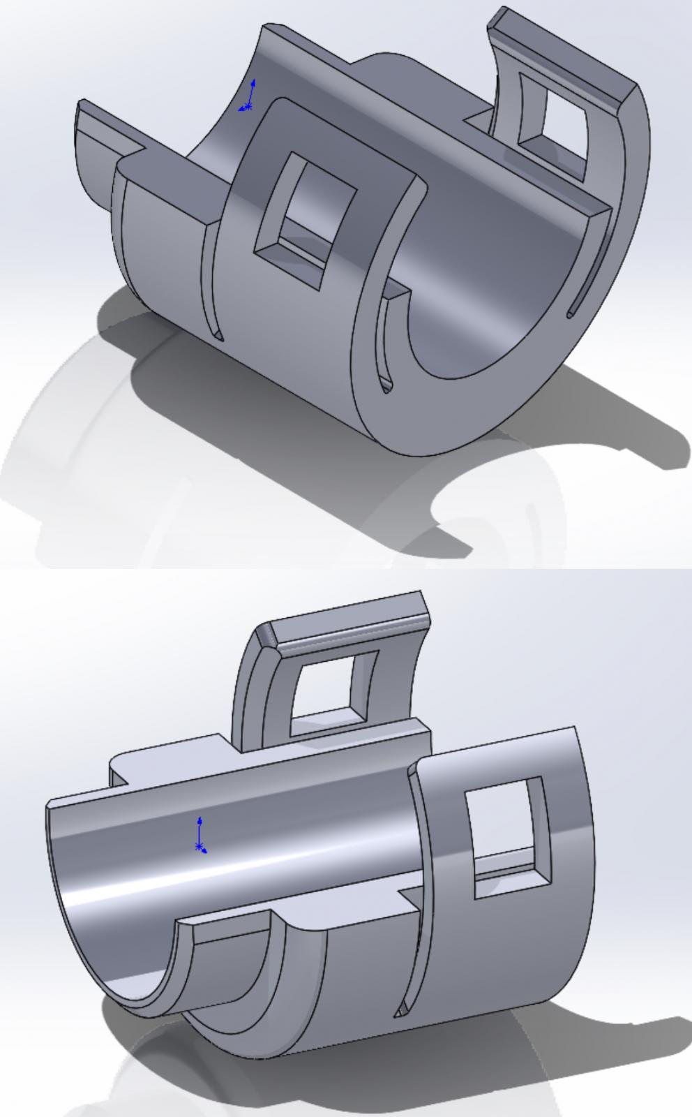

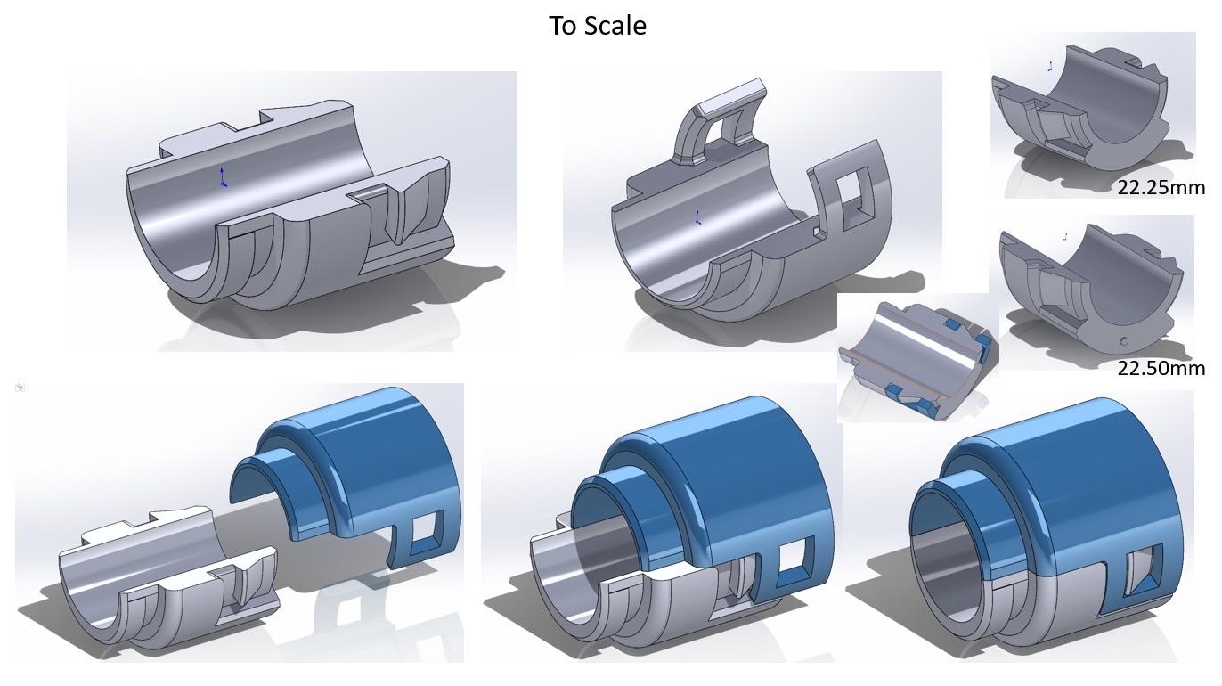

So I’ve started measuring parts up and have drawn two sets of components - one for a 22.25mm diameter shift rod, the other for a 22.50mm shift rod.
Printing will not be amazingly accurate anyway, so it’s going to be measure the printed part / measure the rod and use the closest of the two.
Will print them on Monday, which will give me a couple of nights to sleep on the design. I’m thinking about adding the grub screws for holding / magnet like the cip part. It’s just an added hole that can either be tapped or self tapped.
Any thoughts?
This is where I stand now:

I’ve realised that the leading edge of the design, relies on the thicker U shape part to deform to clip over the one way location ramp.
As this is going to be a printed part, I can make these longer, by taking some more material out of the side wall next to the clip over ‘ear’.
I’m also thinking of adding a very small radius to the leading edge of the internal of the bushing bearing face.

A quick break from painting the basement and tweaked the design to have more flexible ‘ears’.
Guess I better print it tomorrow to see if it does clip together how I think it should…

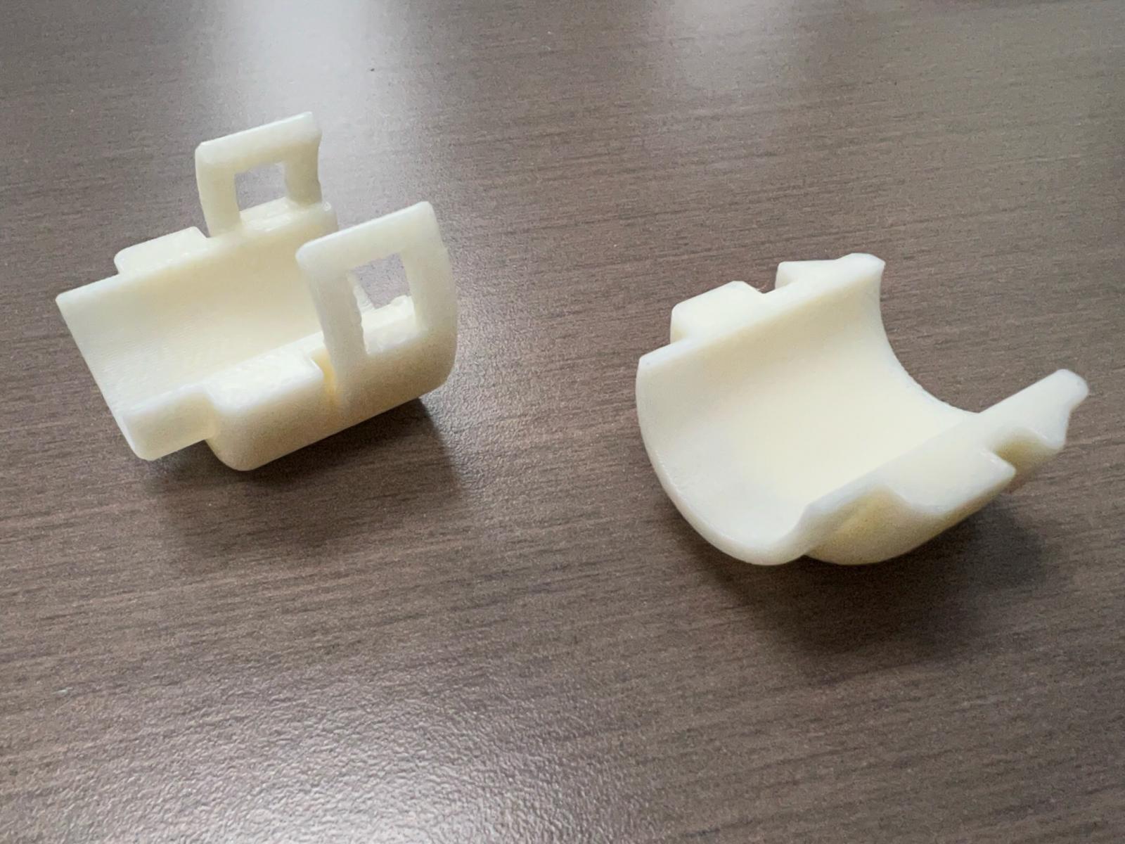

PostPosted: Mon Jan 23, 2023 7:45 pm    Post subject: Re: Shift rod diameter Reply with quote
One step forwards and two steps back!
I got the first parts printed today.
Here they are with the support material still on them. This is from our lower resolution printer, but I wanted to check for any issues.
Support material cleaned up.
And a quick test fit.
I realise that the window opening isn’t wide enough (or the snap ramp is too wide). It’s a bit too tall as well. I think I might struggle as 3D printing tends to have a weakness in the grain direction - where the layers build up on top of each other.
If I print in the best direction for the thinnest area around the bracket, then it’s really in the wrong direction for the flexing clip. And visa versa.
I’m going to try a few tweaks tomorrow and failing that, resort to using a spring clip I’ve just found at the hardware store! That would be a shame though, as I like the idea of a print only solution.
One of the techs at work asked me why I just don’t zip tie it. I told him, I couldn’t bring myself to do that. He asked me who would know? I told him I would! Razz

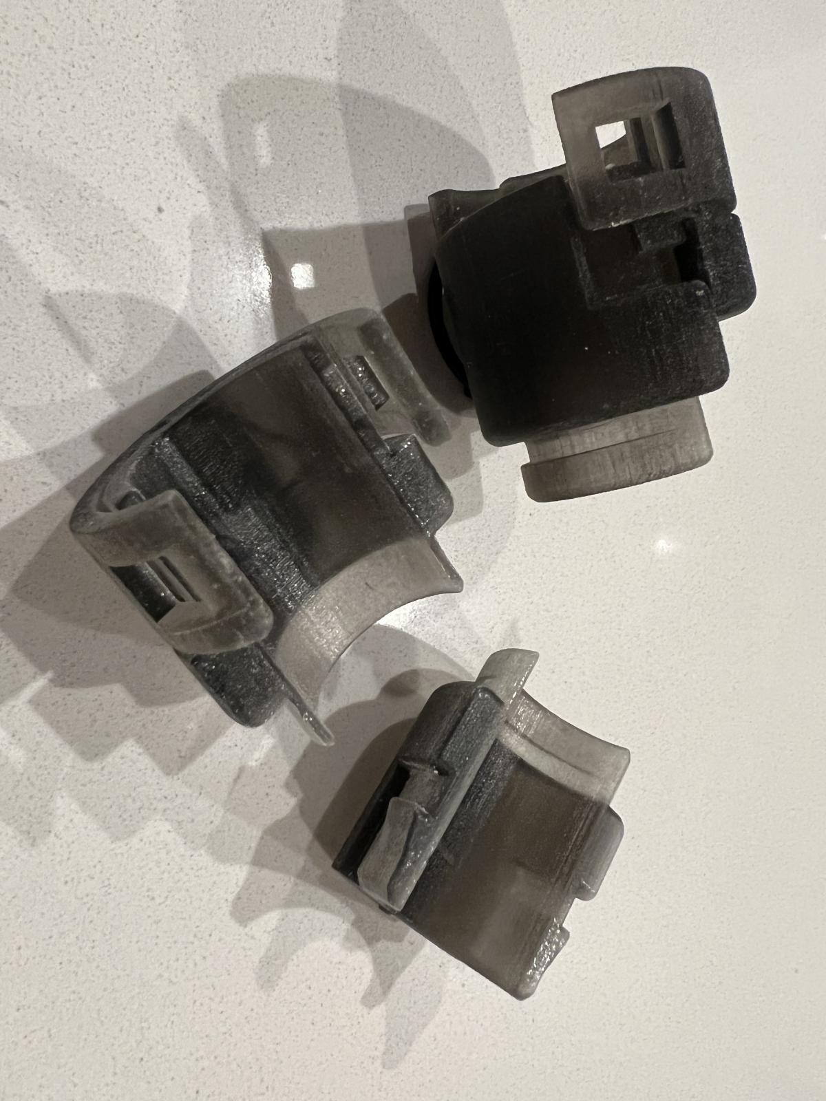

PostPosted: Sun Jan 29, 2023 7:08 am    Post subject: Re: Shift rod diameter Reply with quote
Well, I finally have two concepts that look like they should work.
Not sure which I’m going to use though.
I printed them on a better quality printer, though the carbon fiber filament printer was busy, so it’s on a high res printer.
The first one, is the self clipping one that I have been working on since the start of this thread:
And the second is plan B which uses a metal clip, over the top of the two halves to hold it together.
I haven’t decided which one to use yet. The first has the advantage, that it just holds itself together and has more wall thickness for wearing in general (though the section around the hanger is identical on both. The down side is that the clip material is untested - will it last 5 years of use?
The plan B has a thinner section where the clip is, making it possibly more likely to wear, but I imagine that as the clip material is metal, there are little concerns about its longevity of holding together.
I won’t get to fit them for a week or so, as I have other weekend work to do on houses first, which will give me time to think!
I printed 2 of each, so there will be three going spare if anyone wants one and I’m more than happy to share the file, if you want to print your own.
