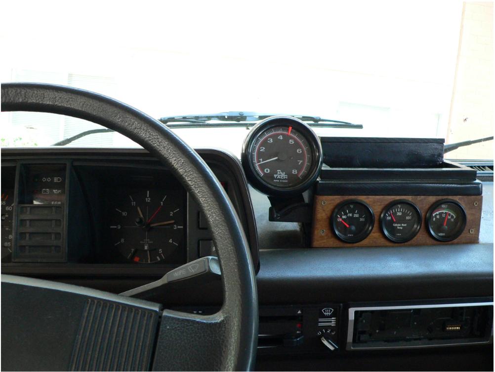

Or Changing the Clock into a Tach.
When I first added my gauges I didn’t give much thought to how I was mounting them. I just need to monitor the engine till it ran the way I wanted. So when I mounted the tachometer here I just needed to be able to see it. Lately it had started to rub against the dash pod and it has been bugging me. I have an 81 Westy and had thought about getting a tach from a newer waterboxer but that tach also has the temp gauge which I can’t use, plus I didn’t know if I could get the gas gauge to work right, and I needed that to work right. I have an extra gauge pod I got off Ebay, I bought it for the switches, but it was complete with a clock. I got the idea of trying to put the tachometer guts into the clock. The more I looked at them the more it looked feasible. The Tach I bought from JC Whitney for 25.00 awhile back, and I already had a working clock. So I figured I didn’t have much to lose if I broke the tach, the extra clock or both of them. Of course taking the tach apart I broke the bezel, so it wasn’t going back together without some visible glue. Then when I took the extra clock out of the housing I broke one of the terminals, nether one of them was going to work the way it was supposed to anymore, so I was committed.
I won’t go into the details for putting this particular tachometer in. I basically modified it as much as I could without unhooking any electronic stuff. I used to be a jeweler and this small stuff is fun for me. If you like this tedious kind of stuff you to could stuff a tachometer into where the clock goes. I also made this so I could put it back to stock without a problem. Now I have to figure out a better way to mount the four VDO gauges I have.

Wow!!! Excellent job!! Man, that makes me want to put my tach up on ebay and get a set up like yours. That turned out really good!! I am impressed!! I have never been a big fan of the tachs that you previously had (and that I currently have) - they are so big and bulky. Anyway, I might be asking you more questions about it. Excellent job!!

Oh, just a thought, but your 4 other gauges might not look too bad if you purchased one of those gauge mounts that go up and down on the arm between the driver door and windshield. But I am sure that you'll figure out a great set-up - just post it for us, k?

Now that's cool. I always wondered why I needed a big fekking clock in the cluster when a tach would be a lot more useful (especially in a manual Van). I may have to try this...

That's great. Especially as stock tachs are getting hard to come by. I put a stock (1985) tach in my "clocked" binnacle. I forgot to write it up but it was pretty easy... I used the '85 mylar, tach and indicator lights and even cut a hole for the digital clock (that turned out to be a waste of time!) in my '84 binnacle. The later model oil pressure circuit was ignored and all the lights went in the right places! I only had to run a new wire from the dizzy to the tach as there wasn't one in the harness. (some ding-dong mechanic "fixed" the extra wire for me recently by cutting a foot out of it, thanks, ape!).

Could you just take a later dash (say from an 8Cool and drop that in? Or are the wires wrong? I'd be cool if you could wire up the water temp gauge to read CHT.

Thanks guys! pocvw, good idea on putting them on the piller, my only problem is on of the POs put that black wooden thing in as a radio mount,
and cut a hole that big in the dash (it did make hooking up the radio easier) so I got to cover it. The one thing I will say about the big noisy silly clock was mine kept good time so it wasn't all bad. I have a clock on the stereo so I didn't need two, and I sure don't watch the clock when camping. I could't use the water temp gauge because I have no water to take the temp of, guess I could have hooked to the tank for the sink.

i was just mulling this over. my thought was to rotate the tach guage so you can re-use the clock numbers - of course it should line up. the guage mightyart used is a hair off, but pretty close!
