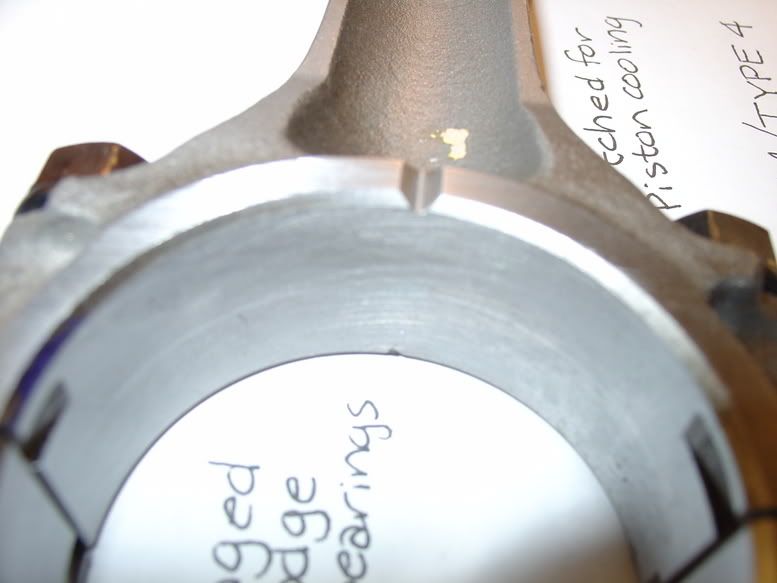

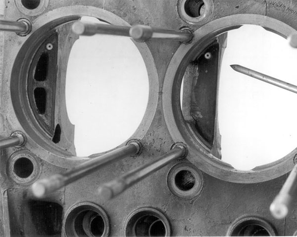

http://www.thesamba.com/vw/forum/album_page.php?pic_id=209081
http://www.thesamba.com/vw/forum/album_page.php?pic_id=209082
Considering that you can make a mess of a customer's case in quick order, $160 is cheap. That's about what we charged over 15 years ago. Reduction in piston temperature is estimated to be around 100 degrees F.

Thanks everyone that answers my questions. And $160 does sound like a bargain if the squirters are $75 and the precision that is involved with installing them correctly. This picture also enlighten me because the previous one looked like it was just tiny holes drilled in the case. It is not a home project, better left for the pros or junk cases to practice on first.
