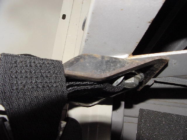

I think that the DC also had little rubber "latches" behind the rear seat that kept the seat belts from getting tangled up. I can't recall ever seeing them on busses.

Man, how can I describe them...I pulled them off my 71 DC and sold them to a guy in San Jose last year. Unfortunately, I didn't have my 69 DC yet and they weren't on there. Mad
Open the 3rd door and lift the seat that your back leans on. Approx. 2 feet in you will see a rubber plug, or a provision hole for one. Just to the left of that you will see another hole. Reach underneath and you will feel the bolt hole of where this bracket goes. It looks somewhat like an upside-down shoe horn. Steve Savilla of San Jose, if you're reading this take the darn picture already Smile !!!

Here's what the rear bench seat belt anchor looks like:
Don't Believe The Hype.

Hey Tristan, I thought you said you couldn't post pics...looks like a good job to me. Very Happy I've never seen that seatbelt mount. A local shop has a DC parts truck and I'm going to see if they have those. Here's another shot of it from Tristan:
BTW, my seatbelts were bolted to the frame the same way, only without the "anti-tangle bracket".
