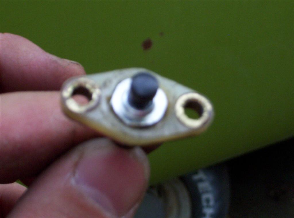

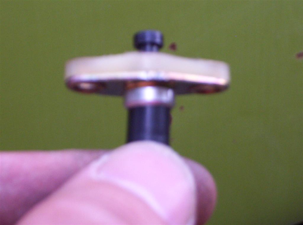

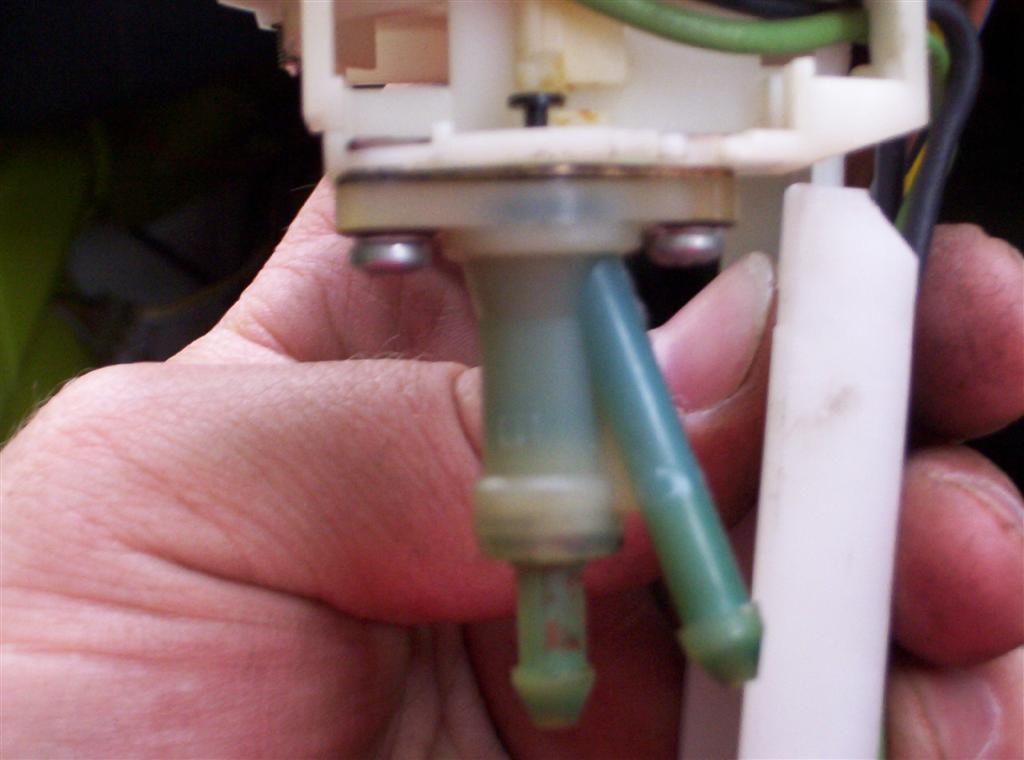

While I don't have intermittent wipers, I am one step closer to having an electric washer pump. I had to remove my steering wheel anyway to install my clock (another story) and figured while it was out it would be a good time to install a washer pump switch
Here's what the original switch looks like when you remove it from the column
First step is to remove the old switch. You don't have to remove the brass nuts, they just usually fall out
I picked up a pack of micro switches from Radio Shack
Now here my camera messed up and lost a couple of pics. First you have to cut the old switch off of it's mounting base and drill a 1/4" hole thru' the metal plate to insert the micro switch
And drill a bit bigger (15/32"?) into the plastic for the nut to go into
And here's the finished project
I then soldered wires to the tabs, covered them with liquid electrical tape, and ran the wires down the steering column when I put it all together. It works like original, and has been confirmed by multimeter. Next I'm putting the pump in the original washer bottle. Peace!
