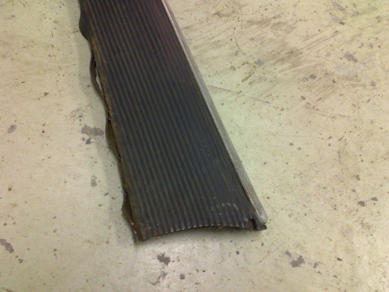

Look at my June 1952 Split running boards. They don't have V-profile rubber, it's square profile and the ends are not similar than Oval has.
Area under trim is smooth as well as area on body retaining side.
This must be special series? What kind of rubbers Zwitter has?

Look like split from the under brace on the bottom and the grooved trim, maybe the rubber was replaced later at some point.

I think they used different kinds of rubber from time to time. My 51 was exactly like that as well.

My Oct. 51 had those as well. It was only driven until 62 and they were attached with the factory rivets so I am pretty sure they were original to the car.

I don't think that the rubber has been changed. I have an 53 june bug with exactly the same runningboards except for the ribbed molding. The car is very OG. Paint, interior ect. I also bought kaefer-nostalgie's runningboards for my sept 52 split, and mounte "regular" split ribbed rubber. Maybe I have to take it of and replace it with the rubber virtainen has now showed us??

I think vw switch to this type of cover in late 51 or 52 and used them up to at least 56 or later. If I understand your pics right it's the type were the square shaped ribs end tapering down to smoth ends.
My all orig 55 convert has this type and I have seen it on at least 10 other carsranging from early 52 splits to 56.
Btw I have two nos covers like this, but thet are both the same side, cant rember which side right now.If anyone has some to trade to make a l/r set let me know.

They are NOT typical "Oval rubbers" with smooth ends. The Square ribs continues fully to the ends of board. If I calculated right, there are 20 ribs starting at front end.

my June '52 standard also has the same rubber as in the photos, original car, original rivets holding it on, the difference is that the rubber is very thick compared to anything you can get now, easily twice as thick as the later stuff

My April '52 also has this type of rubber, factory rivets. The size of the square ribs is differant from oval rubber. I know of a few other original cars that had this type also. My car was delivered to Casa Blanca when new. I don't know if this had any effect on which type of rubber on not. But all the small rubber pads, mirror, seat, and front hood badge, were of the V shaped rubber. How about yours?

I visited a friend yesterday. He has a very nice an untouched split from march 52 with excatly the same runningboards as Virtanen.

Yep, I have the same.
