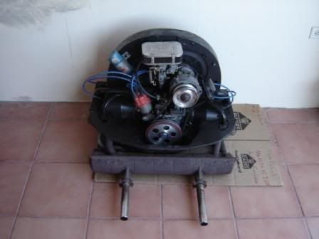

Motor out:

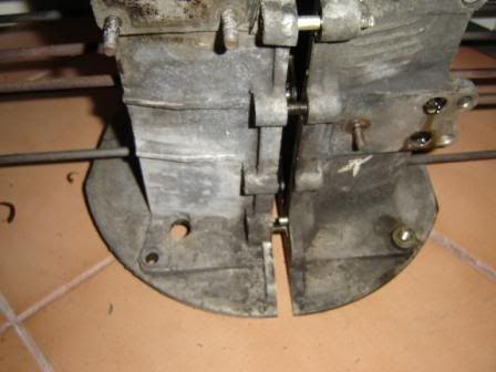

This is how the case looks:

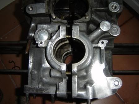

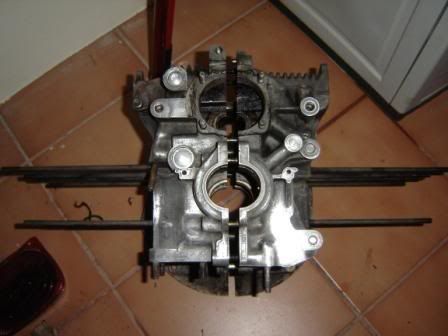

A little sandpaper:
It will take some time but it will finish with a smooth surface.

When you polish the case you close the pours and reduce the surface area.
In other words the engine will run hotter.
Glenn

A wire wheel could clean off the gunk while leaving the outside surface rough.

I washed mine with some degreaser and that's it.

Triple 000 or higher steel wool always does the trick.

You really only see 15% of the case. is it worth it?

That finish won't last very long either.
i had a type 4 engine fan housing bead blasted,was really shiny but it was all pretty oxidised again after 6 months.. lesson learned. Wink
Glenn Premium Member
Mr. 010
Joined: December 25, 2001
Posts: 79939
Glenn is offline
PostPosted: Tue May 22, 2007 3:08 am    Post subject: Reply with quote
oorwullie wrote:
That's aluminum and the Type 1 case is magnesium. It will start to darken in days.

I'd spend my time and effort on cleaning/painting everything above the case. Just a thorough cleaning makes a huge difference. If you paint the tin, fan shroud, intake, etc. it will look really nice.
