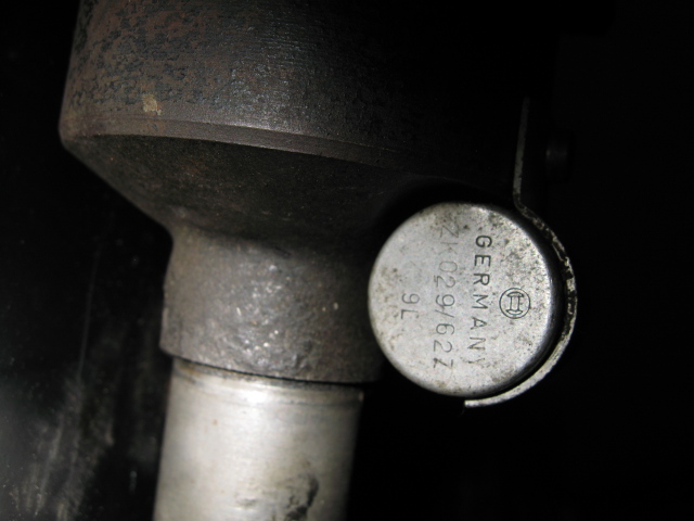

Glenn wrote:
Splitdog wrote:
It's only a capacitor. Any one would work. It just needs to mount properly.
You are 100% correct.
But then many want to have a "correct" part since it is visible.
Not Oval window stuff but since you are referring to VE4BRS383 here´s how the original condenser looks like. Old stock is the only correct option. ZKO29/62Z as in Sept 1950 parts catalogue.
Glenn Premium Member
Mr. 010
Joined: December 25, 2001
Posts: 79441
Glenn is offline
PostPosted: Sat Jun 09, 2007 6:02 am    Post subject: Reply with quote
Yes.. .383 condensers are larger and very hard to find.

HeSa
Joined: January 15, 2007
Posts: 466
Location: FINLAND
HeSa is offline
PostPosted: Sat Jun 09, 2007 6:22 am    Post subject: Reply with quote
Glenn, do you have the 1-237-330-xxx part number for ZKO29/62Z? I´ve got some NOS condensers of the correct design but most of them are with the "new" part number.
