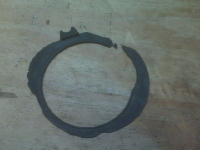

Not sure what to call it or have a part # handy...it's this black plastic ring that fits over the front of the alternator. Engine is a 2.0L type IV.
I can't find it on the fiches but if someone can point me in the direction of a part number or source for buying a new one that would be great. I'm not sure if it's integral for keeping the alternator cool or not but I would like to have one in place.

Well I was just browsing through Ratwell's gallery and he has a photo of the seal with a part #: 022 903 203.
Looks like this is it from Bus Depot? http://www.busdepot.com/details.jsp?partnumber=022903203

that's it. they are NLA. if you find a new one for sale, grab it.

That one in your picture is the later one. It will not fit early tin. Read about K here: http://www.bus-boys.com/aircoolsystem.html
Even though Bus Boys shows a price for the later tin.... do not believe it! It is NLA. They need to update the website.
K. 021-119-281U Alternator Coverplate, Used 1972 to 1974 CALL
K. 022-119-281 Alternator Coverplate, New 1972 to 1979 $21.11
K. 022-119-281U Alternator Coverplate, Used 1972 to 1979 CALL
Note: When using the 022-119-281 plate as a replacement on 1972 to 1974 models, the plastic gasket for the Alternator must be replaced with newer style - order 022-903-203.

I made a replacement by cutting up and antifreeze jug. Been there for years now and has given no problem to date.

Well, people have them, but I would wager that most are in service, or part of a parts stash.
But now that you mention it, this would be a good candidate for 3-D printing. It's plastic, mostly flat, and would be easy to do.

SGKent, I drew up a CAD model based on the trace drawing and your photo posted above. Do you mind having a look to see if you think that is close?
Questions I have:
- check the overall dimensions
- thickness for 3D print I set at 3.5 mm -- I'm wondering what the VW part measures at
- what's the height for the lip around the inside circle?
I'll share the STEP file once it's dialed so people can print their own.
