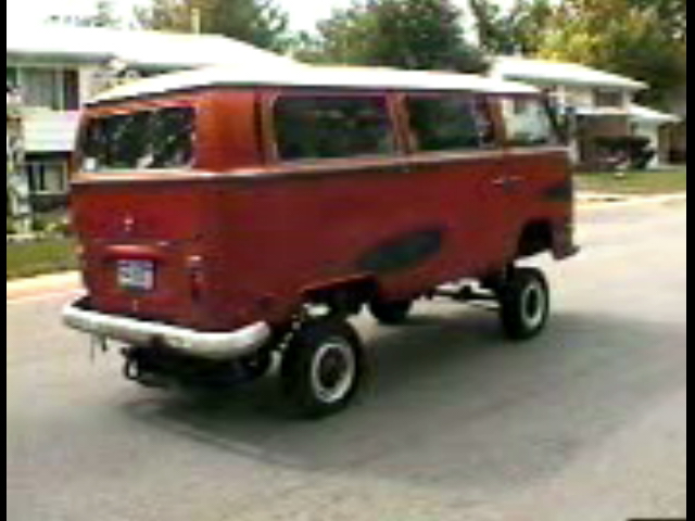

Has anyone else even come close to this 9" lift with the original bus suspension?
Read this guys story! It's super sad Crying or Very sad
http://www.planetgoofball.com/lifted_volkswagen_bus.htm
Here's the bus in action!
http://www.planetgoofball.com/lifted_volkswagen_bus.mpg

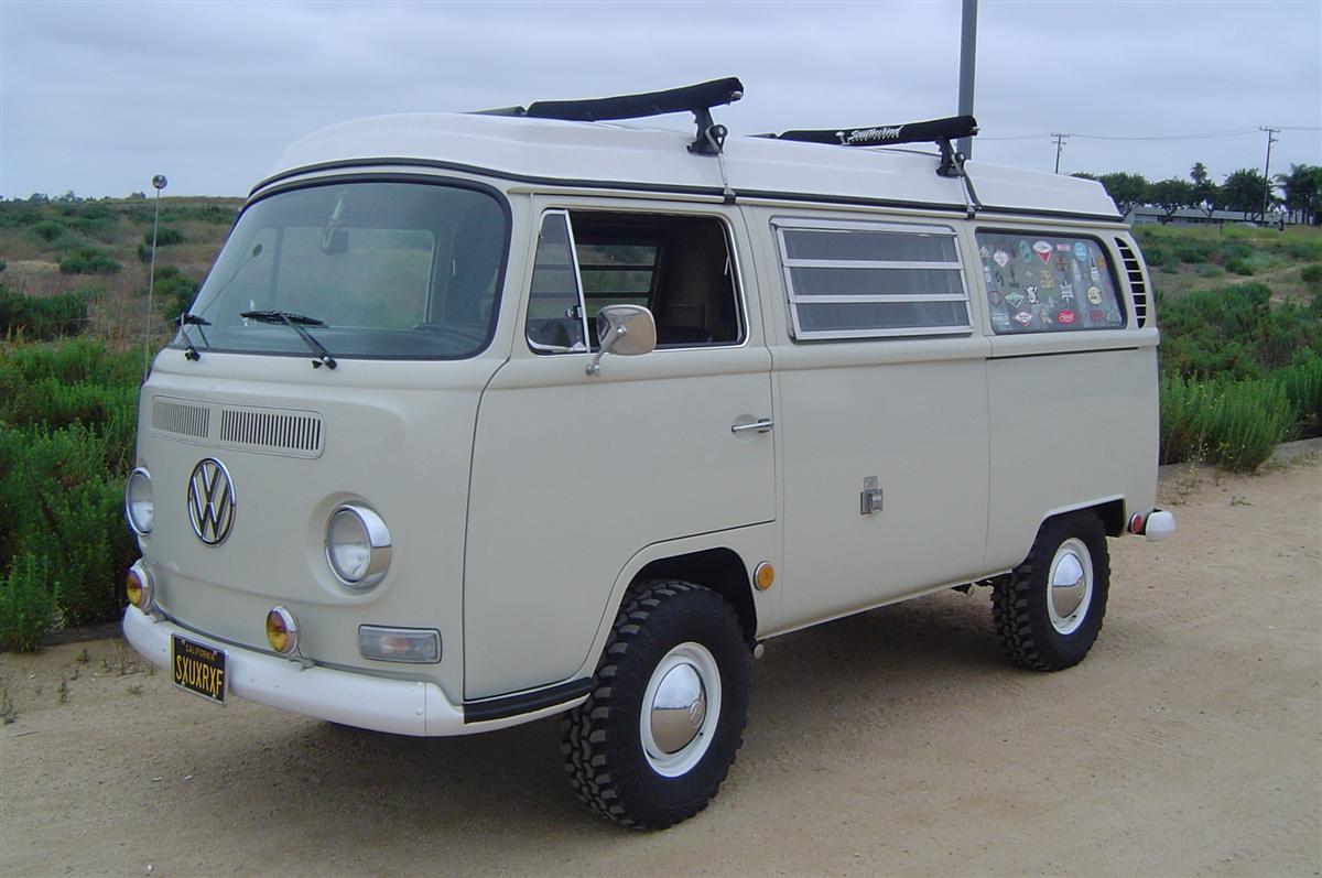

This is the only other one that I have seen.

Wow,that looks so unsafe.That certainly wouldn't pass a safety I'm sure.
Billions of Bilious Blue Blistering Barnacles!
RZAR
Joined: September 01, 2007
Posts: 725
RZAR is offline
PostPosted: Sun Jul 20, 2008 9:01 am    Post subject: Reply with quote
It was probably a shadetree hack job. So many corners cut he was lucky he didnt die driving it on the freeway.

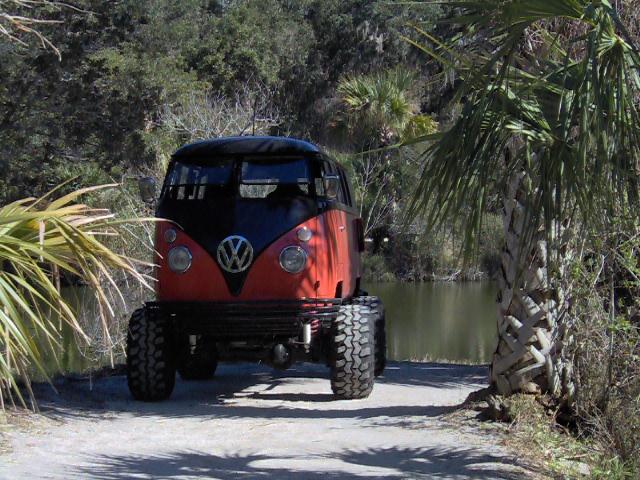

Someone out there made a monster truck out of a double cab splitty, I can't find it again? Anyone out there have a photo?
Here's something else for your viewing pleasure...

a nice, running, early bay RUINED at the hands of a two bit hack.
next time, get a chevy.
P.S. do you really think that VW shop crushed that VW? Shame on you

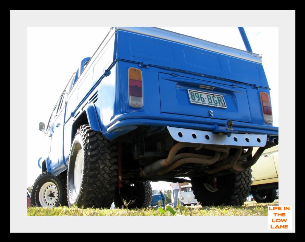

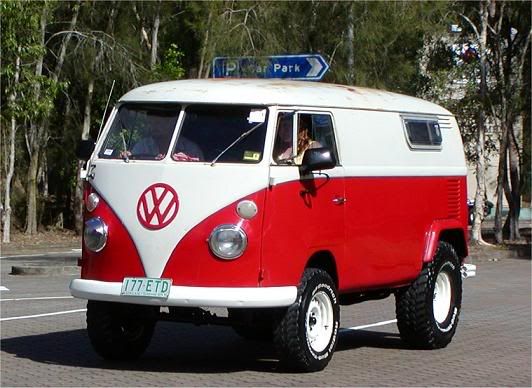

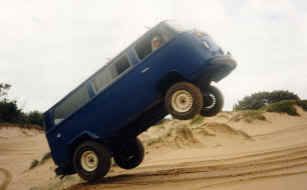

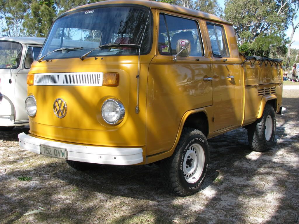

My family has been setting Kombi's up for off road especially beach work for decades. Bay windows are best as the chassis under a Split isn't strong enough and you can bend it(we've done it a few times LOL) front end in reloacted in the chassis and the rear is adjusted on the torsions and modify the stops etc etc. cutting the guards on the rear has to be done in accordance to the size of the tyre chosen. All these cars pictured are of members of my family and all still run type 4's and modified Kombi boxes some with locker diffs. Split screen panel van has bay window running gear under it and has a Renault 5 speed gearbox with a 2.0L type 4 pushing it. goes just about anywhere and further than you could put a 4WD.
11R Mud terrains on front and 12.5 35" Mud terrains on the rear.
215/75/15 mud terrains on front and 10R mud terrains on back
Cousin's Split Panel van. runs all bay window suspension, engine and a Renault 5 speed transmission. 235/75/15 on front and 12.5 35" on rear.
