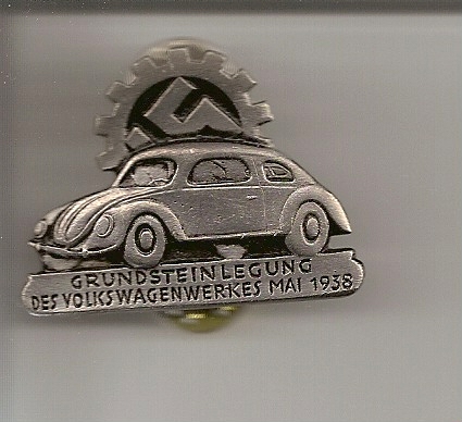

There are known examples in collections that go back 60+ years with direct ties to the actual event. Those examples are in "Tinnie" construction style........... very light metal with no markings. These original badges were never intended for sale and are therefore not marked with required Ges Gesch, RZM or maker-mark designation. Do a search in here and you will see several pages of information. Ask Gary to contact Steven Wolfe if he has questions...................He will know who Steven is and how to reach him.
If you buy it, you will probably not be able to re-sell it at anywhere near that price............and neither will Gary. The few originals that come up for sale very very rarely sell in excess of $500. Gary's price would be high for a perfect reproduction, even at the Australian exchange rates. It is obviously cast, very much UNLIKE any other 3rd Reich badge/medal...............and that alone should have sent up a "red flag" to him. The German contact and known "world" expert on this pin is Simon Mitchell and he can be contacted through this site. (if you need more information) http://www.thesamba.com/vw/forum/profile.php?mode=viewprofile&u=19295
As soon as you get to see and hold an original.................you will know exactly why the EKM one is not even close. The quality of the original material is amazing.

Here's a reproduction pin that I have. This one came from Terry Shuler and features two post mount pins on the back and is very crude on the back with no writing what so ever. Also note that the casting is entirely different from many of the others you see.

He wants $250 for THIS!
http://www.ekmilitaria.com.au/Catalogue.htm
Dan |
