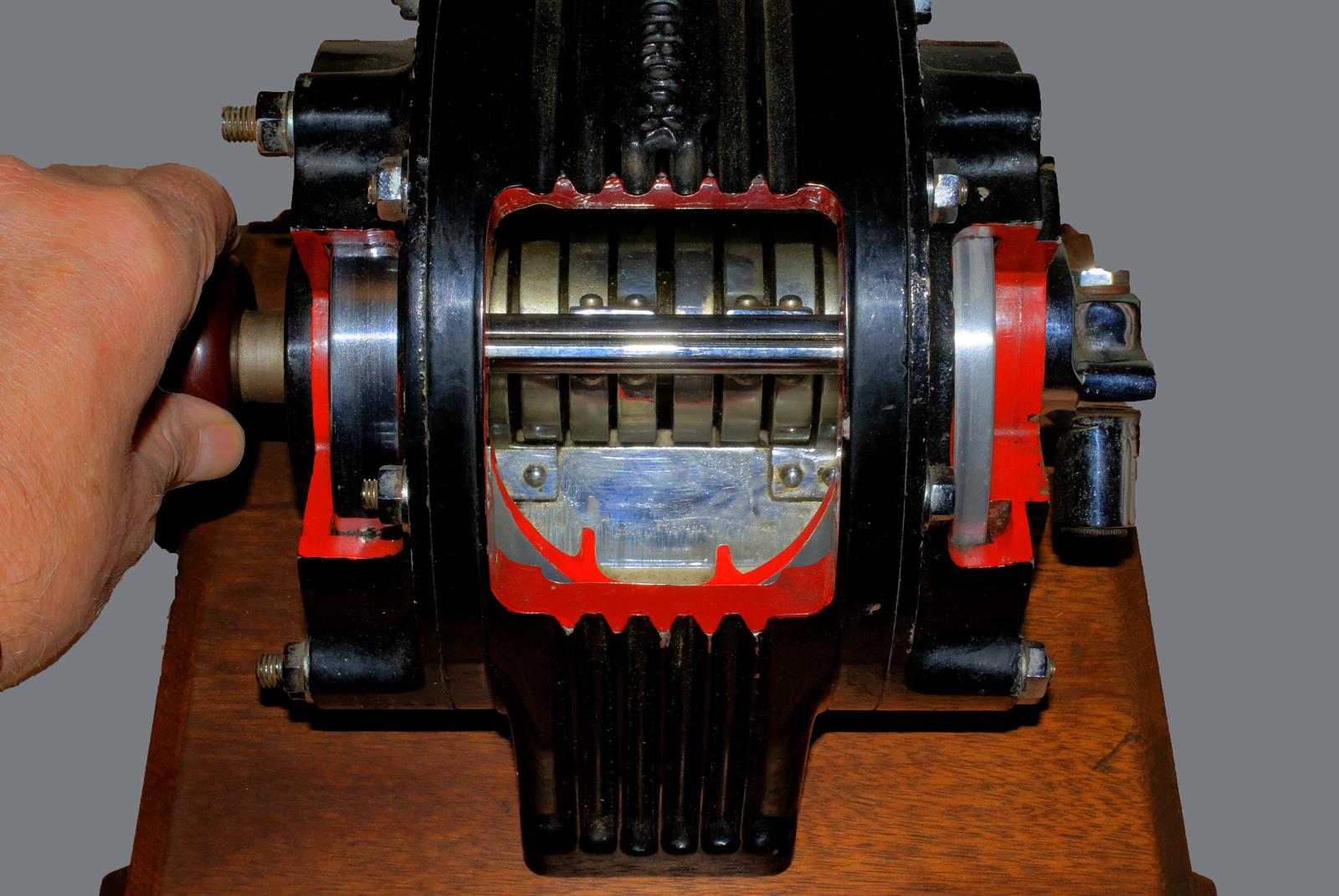

Here’s a couple of hop-up kits from 1950-51. There’s no date on the Kompressor article but the twin Amal carb set-up is dated 1951. The pictures are supplied by Andy Sparks.
The blower article mentions "Italmeccanica-Kompressor" which, in a previous Samba Topic about these articles brought this information from Coad:
coad wrote:
By far the most popular, and apparently the most plentiful, of early blowers is the italmeccanica/S.CO.T. This small, good-looking, dual-lobe, Roots-type supercharger was first produced in italy as the italmeccanica and was imported as late as 1951 in complete kits for american cars such as Ford and Merc flathead v-8s-chevy 6s,Crosleys, And Studebakers. These blowers were made in different sizes for different engines. The "I.T." blower, as it was often called, produced six to eight pounds boost and increased horsepower on a stock 59A Ford V-8 from 82 to 150 at 4,000 RPM in one reported dyno test. Later, American versions of this blower were assembled in New Jersey (using American thread and bearing sizes) and were called the S.CO.T. (probably for the Supercharger Co. of Turin.) Larger versions of the S.CO.T. were subsequently made for Cadillac and Oldsmobile OHV V-8s in the early 50s.
The general consensus from the previous Topic was that it was, in fact what later went on to be the Swiss MAG Supercharger.

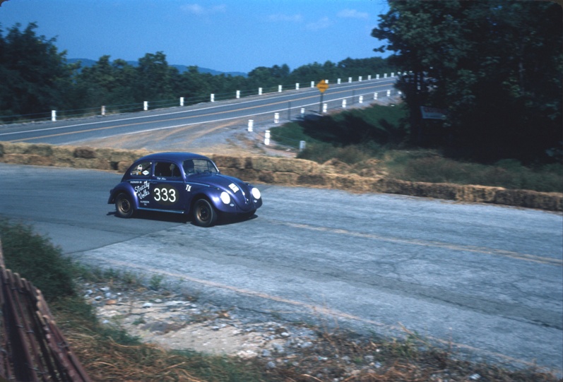

I posted these elsewhere, but can contribute historic photos, especially PA Hill Climbs...I'm the Historian and Archivist for the organization.

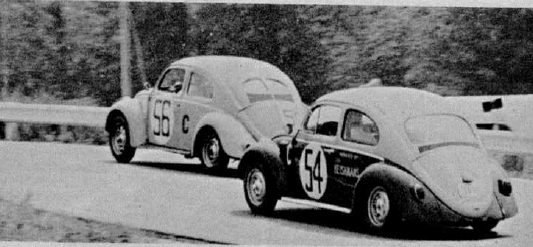

These photos...along with the cover above show PA's Jack Rabold (#56), road racer and hill climber.

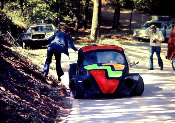

Maybe you won't want these posted here, being modified and all….but it was a beast! Here are the details from the guy that built it!
1957 vw, full length wheelbase, final form - body
chopped 8-10 inches - not shortened, body welded to pan. front sway
bar -16mm 356 -B stock bar. Front axle 57 vw, shimmed for more
caster with torsion leafs modified for softer rate. Steering box 356-
B. Front hood - vw with panels cut out and replaced with Al. Gas
tank - Sears moped - 1 gal. Instruments - oil pressure and 356-B
tachometer, no time to use, launch 3-5 grand on up-swing. Shocks -
Konis. Rear Z-bar off 1500 series vw. Transmission - 356-B original,
first-fourth BBE3C, 644 1&2, 741 3&4, Ring and pinion - 7: 34 last
one vasek had, with limited slip, 1500 drop 2-3 & 3-4, not much better
combo - only hewland. Engine - 356-C case, 356-B heads, small valves
with 8mm stems, pistons - worn out 150" over MC's, approx 1730 cc's,
10.5 to 1. Cam - Elgin 316-In, 320-Ex. Vertex magneto from Porsche
industrial motor re-curved. Flywheel-180 mm, 5lb. Carbs - 46 IDM-2
Webers from a 356-B GT and later Carrera Arbarth GTL using 587/2
Carrera 2 liter motor, in l963, ( info from Gmund #14 1984 - 904's
used 587/3 series Carrera with 48 mm Webers). Motor mounts - solid.
Brakes - 356-C discs all around. Wheels -Front - 8" wide, 13" dia.,
Rear - 12" wide, 13" dia., steel by greenville wheel and rim and very
heavy and cheap. Tires were qualifing compound takeoff's from open
wheel formula car, one of Penske's, very light and very thin
sidewalls, from Phila . Also had set of deluge rains, very soft,
from their european formula car effort, tires $ 20 each.
Driving style - point - shoot - shift and hang on. Red line - when it
stopped pulling, probably 7 plus. Safe? not very. Car built
originally by Gary Davis, Don Dietrich, and Tom Davenhall, last ran in
Pa. by Denny Frick and Harvey Davenhall. Paint design by Milton
Bailey in Atlanta, {kids called it the puzzle car). 0-60 was probably
in 3,s, 60 was roughly top of 2nd gear. Will have some more pics when
figure out how. Also, no generator, cooling by 57 chevy defroster
blower- small battery. oil cooler was old condenser mounted on roof.
I do have the details on the Rabold car…just can't put my fingers on them right now.

Ralph Chase 1967 Spring Hershey Hill Climb
