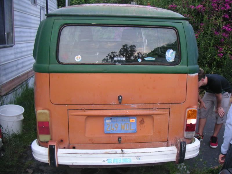

After waiting for a trillion years, I finally got a bus. Its a 1978. It doesn't run but I will have it running soon.
It looks to be in great condition besides the sunroof and windshield, and I'm going to be restoring it in my high school auto body class next year. But so far I just need to get it running and driving. The lady I'm buying it from said that it needed valve work that was $350 back when it was parked in 2006, but I really have no clue.
Can somebody help explain to me how to put the sliding door on? I need it to be on so I can get it on the tow truck and start working on it already! I'm so excited...this is my first bus. For some reason I didn't take a pic of the engine Confused Thanks guys
Pics:

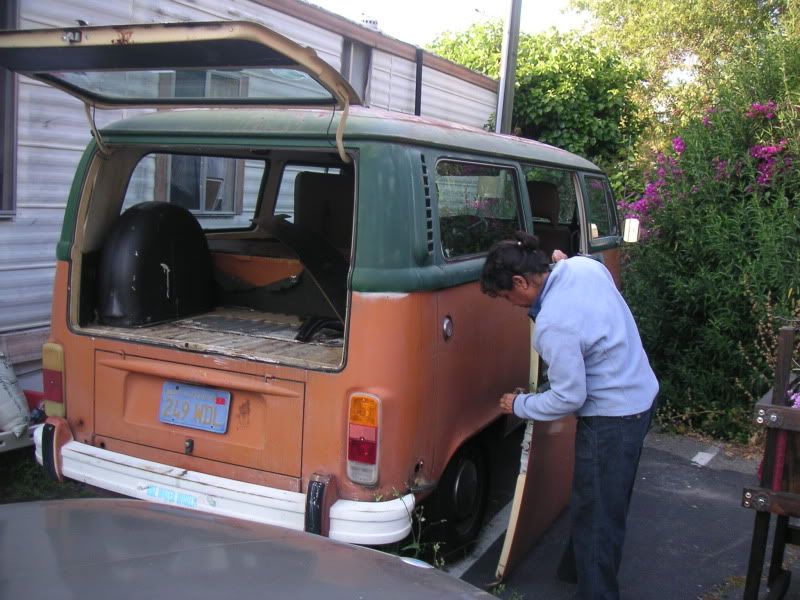

Door isn't on the bus. Can anyone help me figure out how to put it back on? I need it on to tow the bus away. I tried today with my friend and we couldn't.

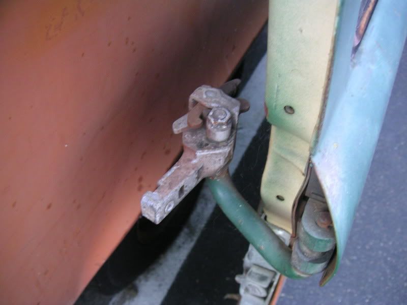

The hinge...
Front is all covered in bushes.
Inside. It has all the seats.

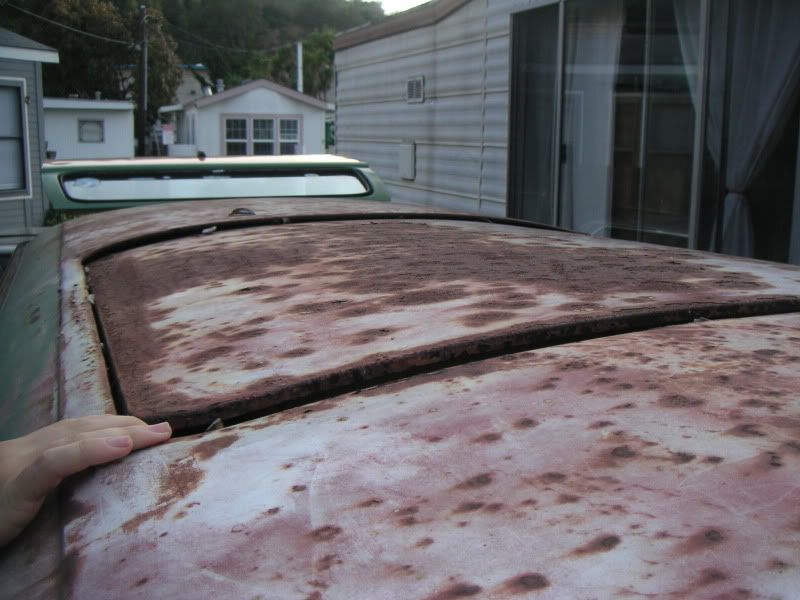

Rusted shut sunroof...oh no

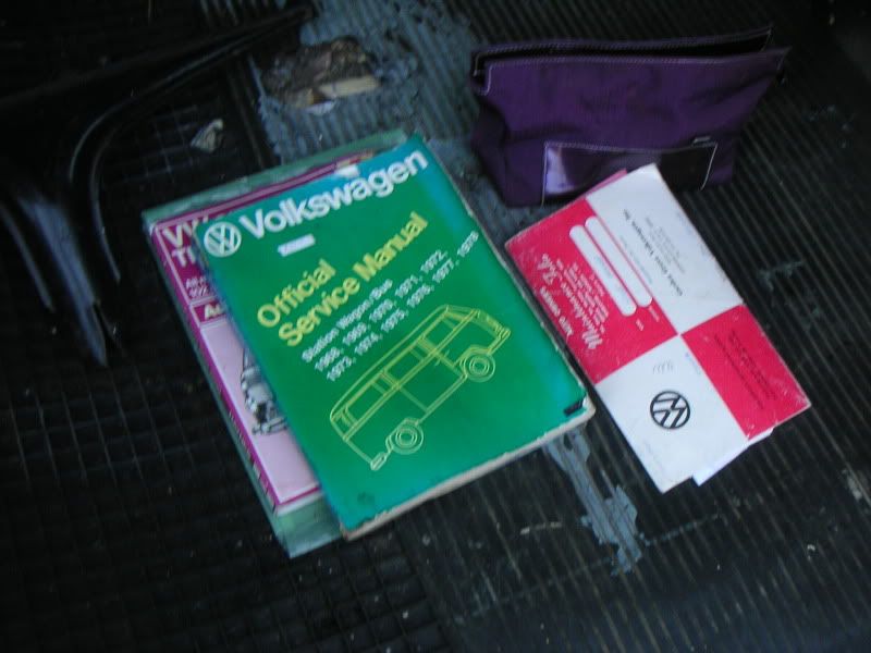

All the original stuff came with it...and some handbooks as well.
Rear end Very Happy
Please help me get that door back on.

As far as the door, just stick it in the bus and tow it home. What's the problem? To put the door back on, you will need to remove that slider track cover under the rear right window. Getting a door working properly can somtimes be a pain so I wouldn't worry about that till I had it home.

Putting back the sliding door takes 30 seconds with some experience, and can be a pain when you've never done it. First, slide bottom lil' roller in the sliding door rail, door being at a 45° angle with left side pointing down, and door being at 45° too away from bus. Then, when bottom part is in, move back along side of bus, and put the top part in the rail (top of sliding door). And then, behind the slider track under the rear window, you'll have to find a recessed point on the rail (the rail under the slider track : middle rail). The recessed space allows you to put the wheel of the hinge on the rail behind the track. Once this is done, your door is ready to slide again. Check condition of lower frame in the bottom rail. If it's dented, or frame has a big groove in it caused by the lower roll, the door could slip out of its place and fall on the ground Shocked . Not good if that happens while towing. Hope this helps.

The sliding door removal/installation procedure is in Chapter 1 (page 19) of that nice green manual you have there also. Smile

Nobody mentioned that you're missing a key part to make that door work again-there is a nylon slider block that goes on the rear roller assy you have a picture of there. Search the forums, there are plenty of threads already on it.

Here is a pic and a vendor for that plastic hinge guide mentioned above.
http://www2.cip1.com/ProductDetails.asp?ProductCode=VWC%2D211%2D843%2D368

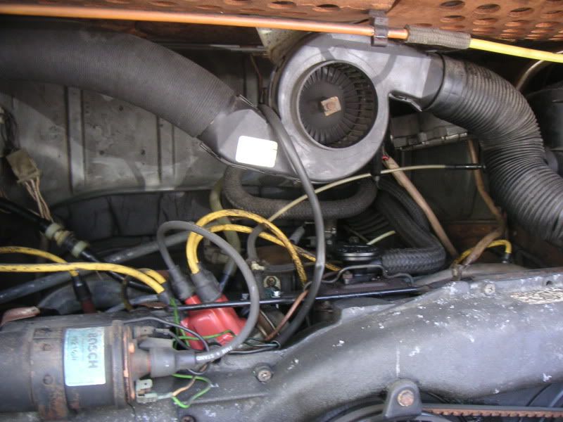

I got more pics today.
The engine.
Looks pretty good.
There is this hole cut in here. Anybody knows what this is for? Apparently her nephew cut it to fix something...weird.

Don't know why he cut it out (access the flap?), but you REALLY need a new piece of tin for that or your 3rd and 4th cylinders will overheat... probably one of those or both that need the valve work that the PO mentioned.

Welcome & congrats on the new bus! While the door is off inspect all of the rollers and moving parts on it. When I got mine the bottom inside roller was missing and the hinge/spring was also not working properly. Pretty much anything you need you can find here:
http://www.thesamba.com/vw/classifieds/cat.php?id=33
Though you will find people here very helpful and often share their spares. I too have this part you are missing, If any of the others don't pan out let me know. Cheers

Pierre G
Joined: April 28, 2007
Posts: 1771
Location: New Caledonia
Pierre G is offline
PostPosted: Tue May 19, 2009 5:46 pm    Post subject: Reply with quote
so-calvwdude wrote:
I always thought that busses had a upright engine? Im assuming that the fan with the tubes coming off of it is an extra fan to cool the engine? How does that work. I want to come see the damn thing.
Busses from 1972 had T4 engines in the US. The extra fan is not for cooling as T4 cooling is efficient enough. It's to provide more heat.
