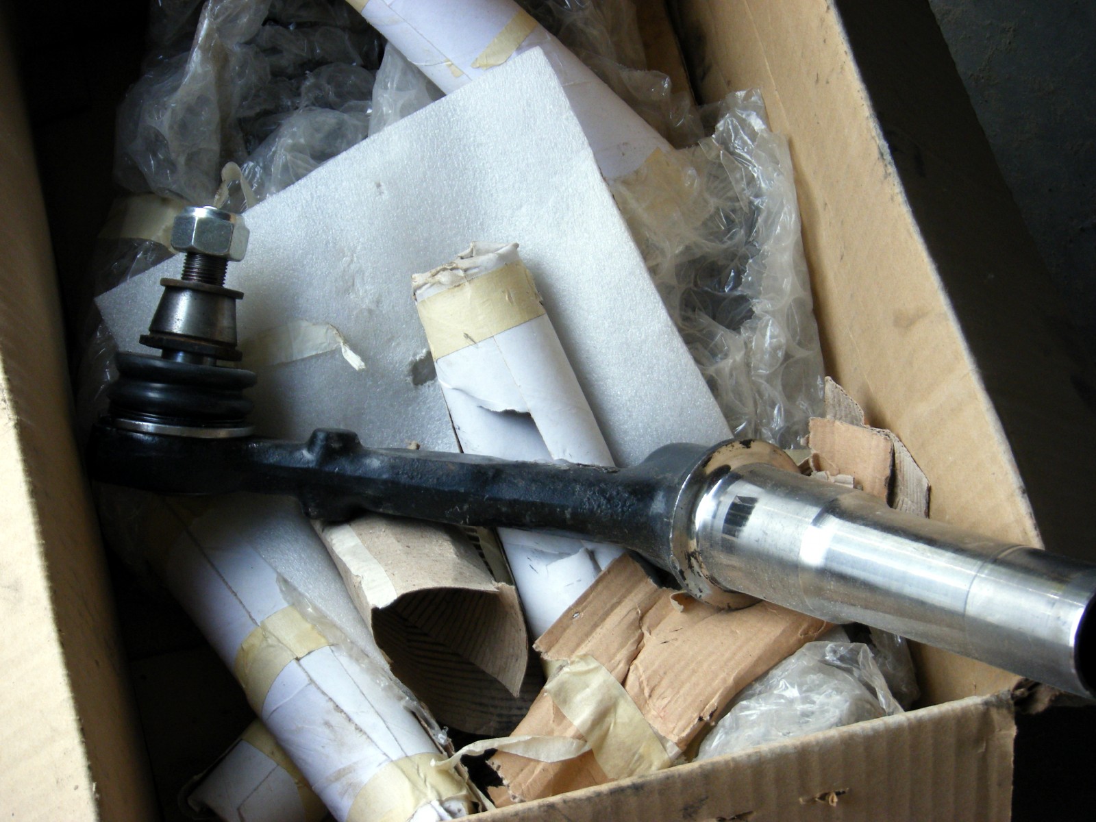

As previously stated I ordered ball joints from Scott to do it myself. I have a 15T press, and a friend of mine has a 50T. I don't have VW 459 for removing and installing the joints. Looking at the arms I could possibly fab the tools needed to do the job. The other option would be removing them with heat and a hammer then using the correct sizes Sch. 80 pipe to install them trying to make sure you get them indexed correctly. I've thought about this long and hard. My final decision was to go ahead and order the arms from Scott and have him cancel the ball joints. There is no way I can practically justify the labor doing it myself for one bus considering the difference in cost. I hate it because I would rather do it myself, but you have to pick your battles. Wink I think you've made the right choice.
- wise decision.
It is a pretty straight forward repair. You will want to follow Bentley. I pulled the torsion leaves to be sure they werem't broken and then used an old spatula super glued to a stick of wood to get the old grease out of the tubes and to inspect the bearings. Getting the arms off just go slow and take pictures as you go. Follow Bentley. Use a long crowbar to release the torsion arms that are sitting on the stops. I lift the arm with the crowbar and then pull the bumpber stop out with long pliers so that I don't lose fingers if the crowbar slips. Then with it resting on metal and the less tension I use either a lead / brass hammer or a piece of oak and a small sledge to drive out the arms. Going back together is similar except you have to lift the arm a little with a jack and prybar. Do not hit them with a steel hammer. Use only a brass, lead or piece of hardwood to absorb the blows.
Those shots of arms look really nice. Where did you get them? They look like they are a 9 or 10 on a scale of 10 whereas the ones we got from Wolfgang were a 8 on a scale of 10 due to pitting and prior wear.

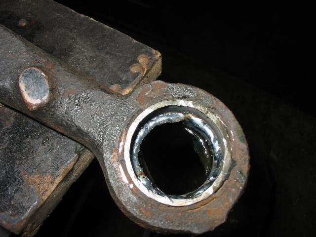

I've used this method:
http://www.youtube.com/watch?v=PZLxPyRdAbY
On the bus ball joint, use a grinder to grind the top cover off the ball joint.
I used a tool similar to this to press the new ball joints in:

nakata is fine. Why not get a set from Scott at German Supply? I got mine at wolfgang. They were Ok but I had to clean and polish the races.
fyi - cherry red changes the temper of the arm and makes it more prone to bending under a hard jolt.
who said anything about heating them up till they're cherry red?

Heating to cherry red might not be good. Lower temps would be less chance of changing the temper. I learned a little about heat treating and metallurgy in school a long time ago. I'd say that quenching in water is a no-no, too.
(like is shown on the Youtube video.)
These arms are alloy steel. Probably heat treated. Some of the strongest steel in the car, along with the crankshaft, rods, tranny parts, front and rear spindles and axle shafts and cv joints.
