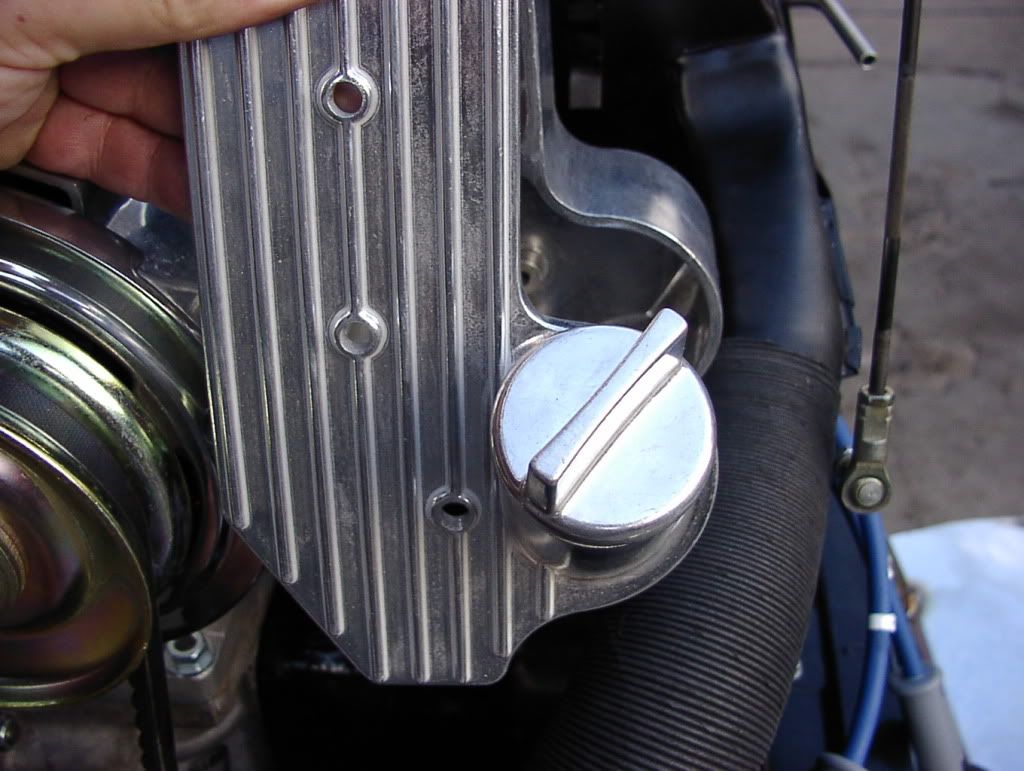

I just bought and installed this CB Performance breather box onto a 2007cc type 1 engine I'm building for a 1968 bus. Here's the question. After getting the lines run to the valve covers and installing the box I noticed that when a person goes to fill the engine with oil now through the new cap on the box the oil will most likely flow right down the breather hose and into the valve covers before going into the engine case. I assume that when the engine gets started then the oil in the lines will be pushed back to the breather box and eventually make it's way to the sump. Should I be concerned or just forget it and hope for the best?

I used the top holes on that same breather box to run lines to the valve covers. I just plugged the bottom two to avoid that same problem. I guess that they are good for a return line to the sump or something.

The CB box is just fine.
The breather lines on the bottom of the box make NO difference AT ALL.
When you add oil, the oil that goes down the breather lines will go into the valve cover, drain down the pushrod tubes, and into the case.
The only thing that can make it not work well, is if you route the lines with excessive length and end up with 'low spots' in the lines that will collect oil like a P-trap from a plumbing system.
The lines entering at the bottom is the better design as it does offer more oil/air seperation before it hits the vent to the atmosphere.

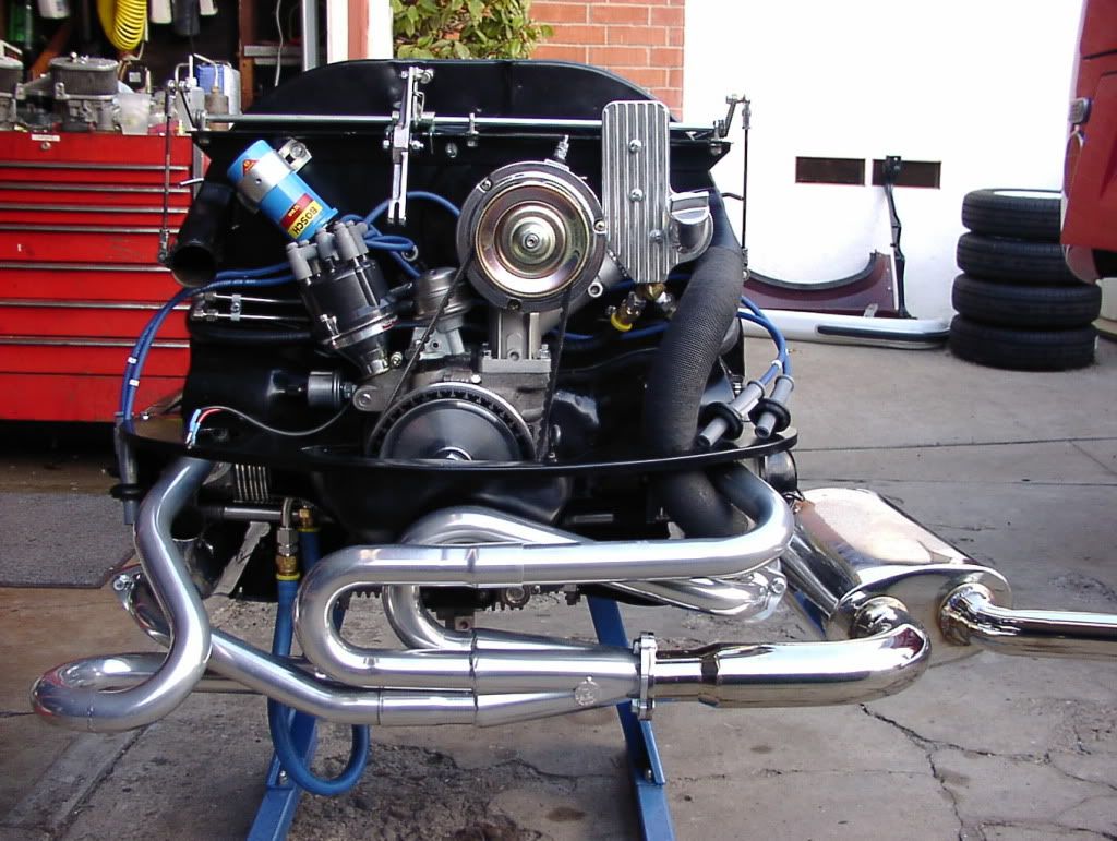

My box has 3 fittings all at the top. Two come in on the top side and one on the very top next to the fill.
Sorry... I ground a picture and the valve cover fittings are about half way up.
I stand corrected.
Glenn

That is a quality breather... And designed correctly.
Nice engine Glen. Cool

PostPosted: Thu Oct 22, 2009 7:25 pm    Post subject: Reply with quote
It's all in the details... thanks
