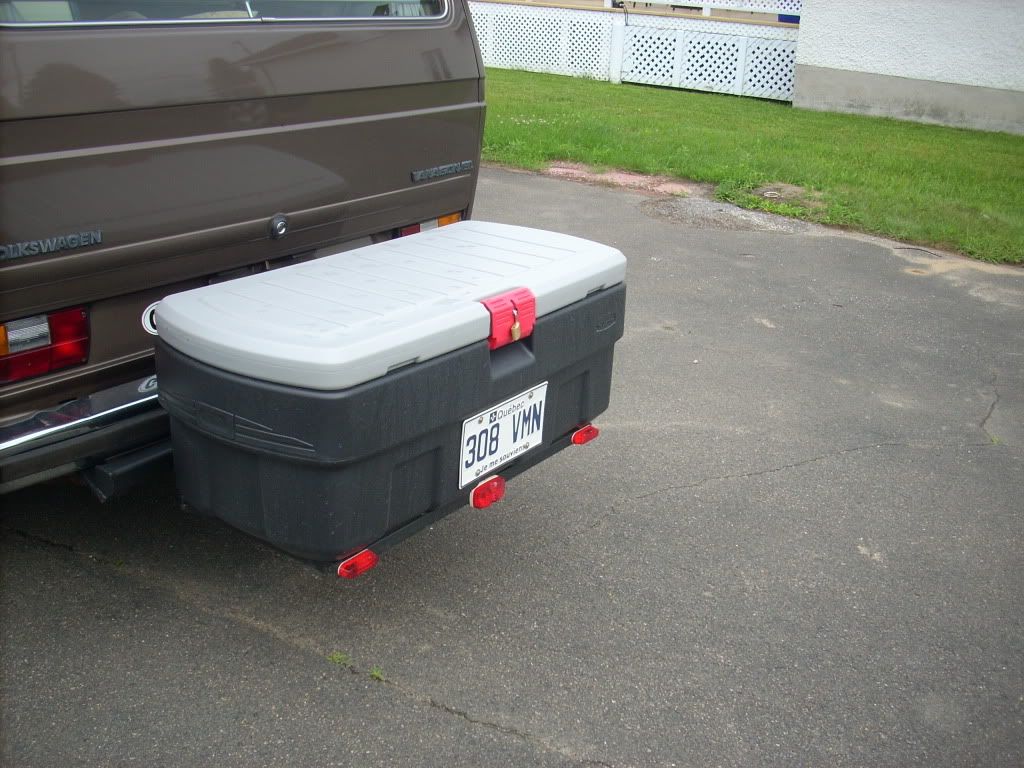

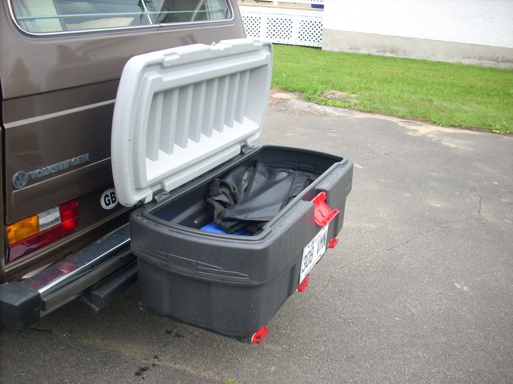

PostPosted: Sun Feb 07, 2010 12:30 pm    Post subject: Reply with quote
It's maybe not exactely what you need but that works for me.

PostPosted: Mon Feb 08, 2010 12:26 pm    Post subject: Reply with quote
Yes that is something that I'm thinking of. Can you put a pic in without the container? or is it fixed? Can the platform be folded up? Could a bike carrier be added?
