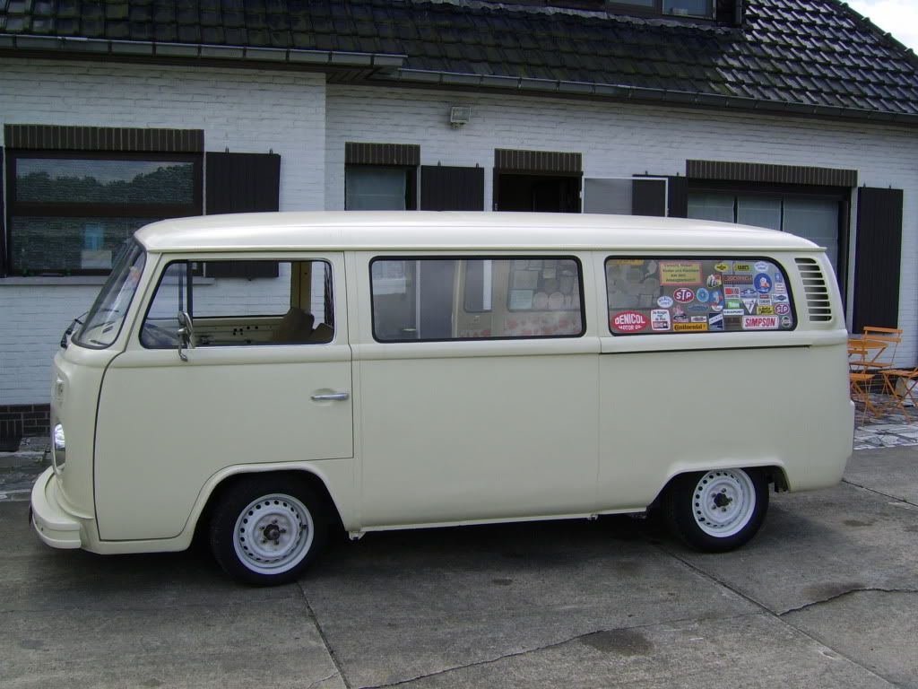

hi everyone, this is my first post on the samba! long time viewer, first time.... i apologize for the long intro! just some background info:
i'm from Belgium , and have a '74 1600 bay window bus, i bought it a year ago , it was far from original !
i replaced the front discs, new calipers (incl new pads) all from ate germany, new soft lines and hard lines, and in the rear new softlines, brake shoes and cylinders!everything but the master cylinder and the booster !
my wheels lock up after a short drive (say 15 to 20 minutes) the front go completely stuck, the rear ones also ,so i bought a ate master cylinder and replaced my old one, I checked everything beginning with my pushrod (shortened it again), it looks better now but still have a drag issue, they are not stuck now but after a drive they tend to drag more, sometimes I drive 200 kms and don't have a problem , other times only 25 km's and i can feel it in my performance, not to mention the smell and the hot wheels and brakes
Could this be a brake booster / SERVO issue ??
my booster isn't connected to my engine,(it's a bug engine) i don't have a valve in my vacuum line, when i changed my MC i noticed a booster with filth in it, but from what i understand is that a disconected booster shouldn't be a problem ?the rod in the booster was moving !
