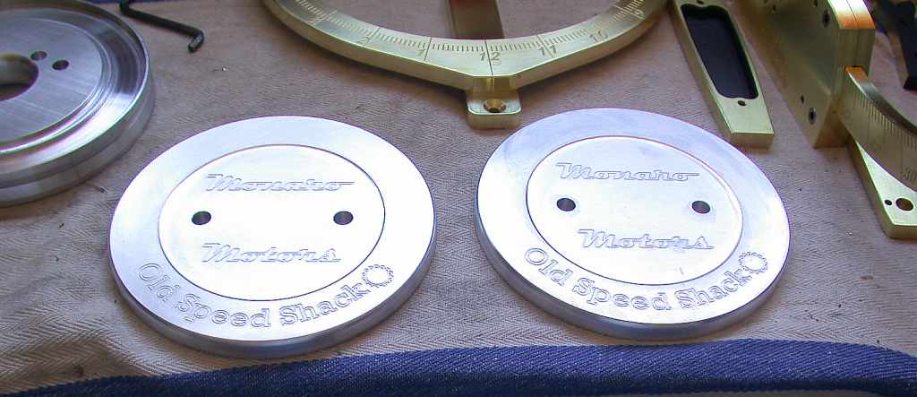

Also took the time to find some nice air cleaners made up, as the cheap chromed units just seemed like a waist after all the work.

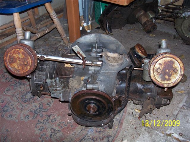

These are of a Gentleman named Dean H. from Oz
As you may be able to tell many of these manifolds have been modified over time to fit there owners needs. The set that we rebuilt had brazing on the manifolds, linkage and a “nub” brazed onto the balance tube(not sure why) along with having 3/8” chunk of the balance tube cut out. We can only assume that the cutting of the balance tube was to fit it on a 40hp motor, though when installed on a 36hp the tube ends to not touch.

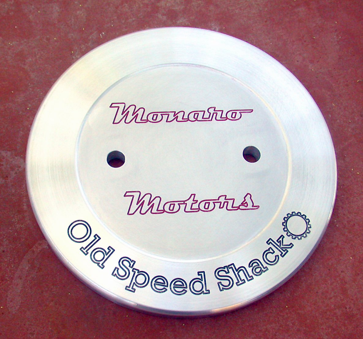

Here is a couple of pictures of the air cleaners for the H1 SU carburetors that are on the Monaro Kit.

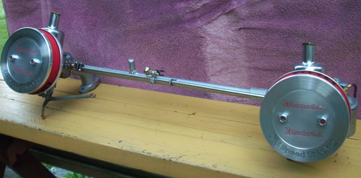

Here are some after pictures of the Monaro kit. I have not found an acceptable option for the clear rubber that is connecting the balance tubes and am still working that one out. There is a close up of the linkage and the air cleaners installed
As of now i am not sure if it will throw it on the OG 58 36hp that is going to power the beetle for the summer or not. May do it as that motor sounds very healthy, much to my surprise.
There is currently a 1300cc 36hp based motor being assembled for this dual carb kit to run on. The heads will be worked over by Jeff Denham with stock valves and HD springs, short block by Mr. Motorhead(69.5mm stroker crank by DPR) and guessing i will have Tiger wipe up a merged header(1 3/8 ) to handle the exhaust. This motor will be the one that i use to in the planned drive from VT to OR via US route roads next summer/fall. At 1300cc the H1 SU carbs will be pushed to there breathing limits and from there one would need to go up to the H2 carburetor, which does not have the same base as the H1 and will not bolt on. I will be talking to the gent that rebuilt the carb this winter about some custom manifolds to support the H2 carbs.
Would love to get the kit installed on both motors and dyno them to see what it can pull in stock from and as a stroker motor. Guess i should look around VT area for a dyno. Laughing
Mr. Motorhead will be posting build pics when he gets started.
If/when i get the beetle back on the road ill take the time to make a video of these running on the stock motor.
