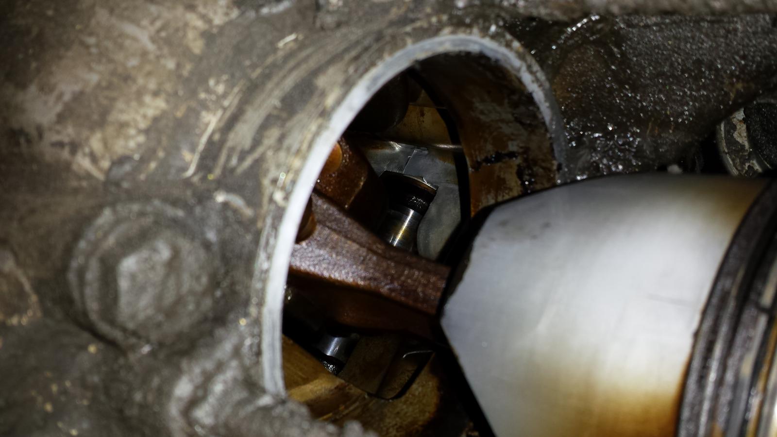

PostPosted: Thu Mar 12, 2015 3:36 pm    Post subject: Cam shaft lobe wear. rebuild Reply with quote
bus is a 75 westfalia with a 78 2.0 fi gd engine hydraulic lifters. lost compression on #1 cylinder to prompt the teardown.
I have stripped my engine down to the short block to do a top end rebuild and upon removing the pistons noticed some bad cam lobe wear. pics below
there is a big difference in the wear between the inner lobes (narrow lifter wear path that has pitting, and the outboard lobes (wide even wear that is smooth and shiny).
The pistons and cylinders looked very good, some oil infiltration but the pistons had no scratches, etc. and all the rings looked good. Cylinders still had slight hone cross hatches and were bright and shiny, indicating a recent top end rebuild...
here are the pistons: all 4 look identical, down to the carbon buildup placement and thickness etc.
Am I looking at a full rebuild now? cam crank etc.
Thanks for any advice.

PostPosted: Thu Mar 12, 2015 10:52 pm    Post subject: Reply with quote
Hard to see the cam. Maybe pull the lifter out and take a picture threw the lifter bore.

PostPosted: Mon Mar 16, 2015 1:40 pm    Post subject: cam lobe wear-rebuild Reply with quote
Here is a photo through the #4 cyl exhaust (I believe). The wear looks worse to my eye through here then through the cylinder hole (other side of same lobe).
Thanks for any comments.

Tcash
Joined: July 20, 2011
Posts: 12846
Tcash is offline
PostPosted: Mon Mar 16, 2015 5:01 pm    Post subject: Reply with quote
The cam needs to come out. With that pronounced of a pattern. I would be willing to bet it worn beyond service.
You can take the lower end parts including the flywheel to a machine shop and have them Mic them.
Good Luck
