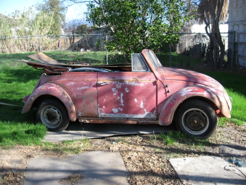

Here are my current two
My 58 Chassis no 1930040 confirmed built 2 may 1958 Motor replaced with an original NOS 57 Firepump motor 122035528 Originally L258 Inca Red Body number ? 45596 Motor OG number 2345430 color now Fiat Rosso smalto Base and clear
Before
After
My 58 Donor shell Chassis number 2070730
My RHD OG 59 Chassis number 2475055 OG color L 473 alabaster now Fiat Rosso smalto
Before
After
Lots of lessons learned so happy to provide any advice ..

Sounds like a good idea. I am doing a '60 'vert and have a lot of questions.
what questions do you have Dan?
On the pans, I have new ones to weld in. I know I need to cut iff the jack point, but what about the metal piece under the pan that the jack point is partially connected to.
Also, I am doing the reinforcement rails next. How do you guys remove the old ones and are the new ones welded in on both sides of the heater channel?
Hey Dan, that extra support panel can stay if you want as long as it doesnt stick out past the edge of the pan, but it should be removed to be correct. you may have to trim the edge of the pans with shears or a grinder to avoid scraping the inside of the support rails while dropping the body on the pan.
as for the rails, the spot welds can be drilled or simply cut off the whole support rail with a cut off wheel. is the heater channel toast too?
I have a great book from House of Haselock in the UK which has a great step-by-step covering vert sill replacement. its best to do it with either the doors on to check for the body clamshelling, or make some braces from the door hinge plates to the door lock striker plate mounts. I would complete one side at a time and make sure the door is acceptably aligned after tacking, before your final welding. the door can be adjusted later at the rear shock mount with rubber shims if necessary. let me know if you want to borrow the book, or I can copy some pages for you!
Yeah, Brett, I could use that book. I've never done rails before. The heater channels are solid (luckily). So, I will have to trim off the flange that goes around the outer edge of the pans to fit the rails? Are you going to the Jamboree tomorrow? If so maybe I could get the book from you then?

hey Dan,
I wont be at the Jamboree, prior activities planned , but i can pop by your place and let you borrow it when I get back. I still need to measure your vert seats upholstery, maybe I can do it then? havent you got the rails for your vert yet? which ones did you you get? Ive heard theres even ones just a hair oversized, just big enough to slip over your originals so you can just weld them on and have more sthrength than replacing them.

hey Dan, havent you got the rails for your vert yet? which ones did you you get? Ive heard theres even ones just a hair oversized, just big enough to slip over your originals so you can just weld them on and have more sthrength than replacing them.
Worst thing ive ever heard. Want to replace your rails in 2 years time thats the way to go, leaving all that rot in there to eat the new metal. YUK.
Cut them off replace and have a long time before you need to look at it again, unless your flipping the car then buyer beware. Yes Im biased as i produce copies of NOS early rails but there are a lot of decent ones out there.

No, I've not bought the rails yet. Who makes oversized ones? Would look kind of odd wouldn't it with larger than normal rails? Who do people suggest as the best source for rails?
