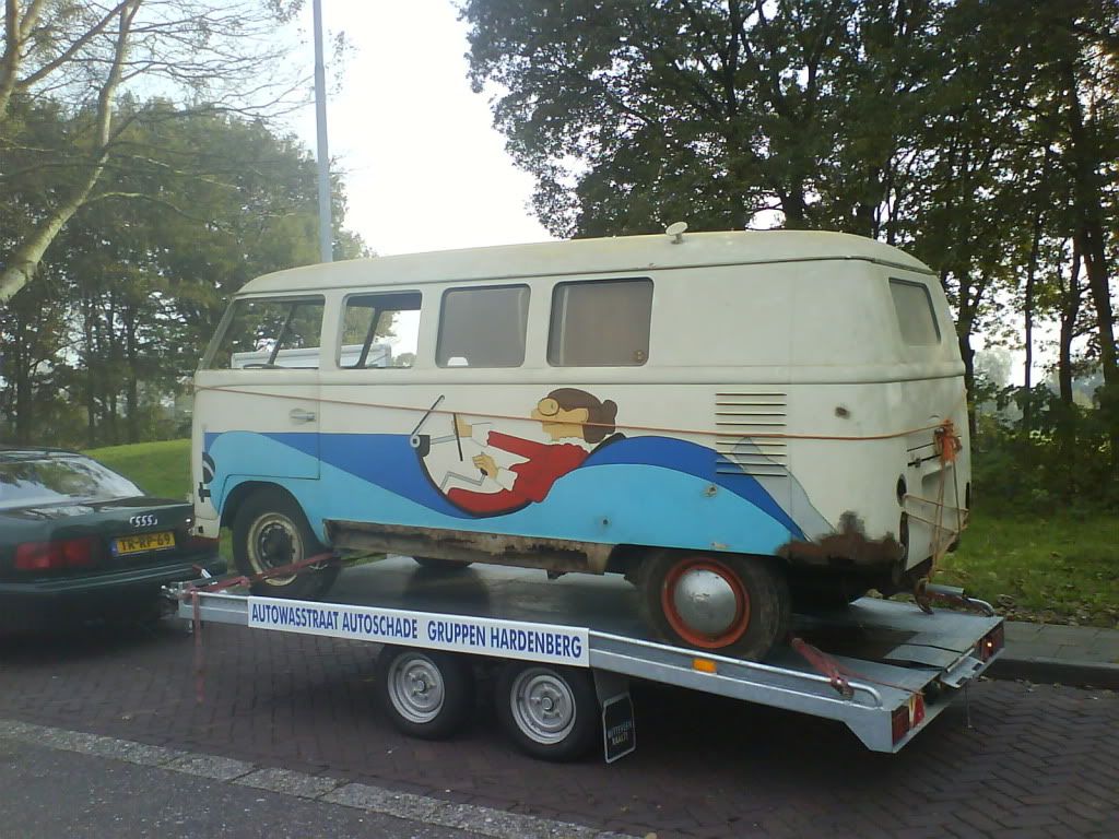

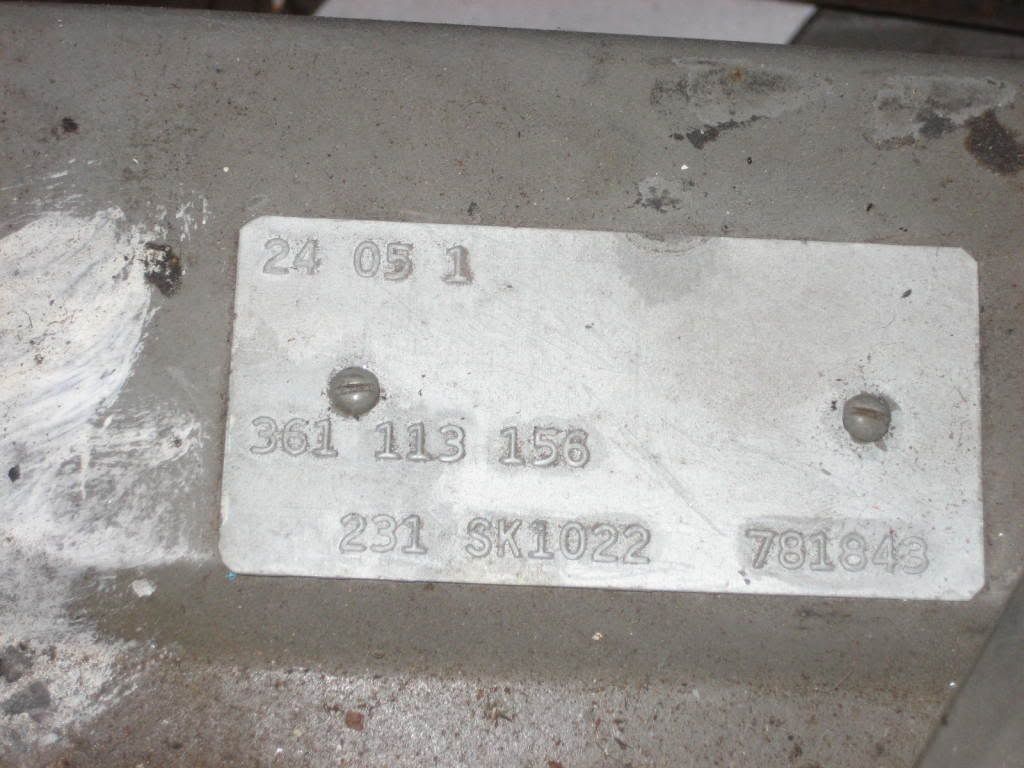

After months of searching we found the car I was looking for. A May 1961 Westfalia SO-35 with factory Safari’s. It should be Mouse Gray / Pearl White SK1022 with Mouse Gray dash.
All the cabinets where there in decent shape, flipseat was there, all the bedparts and original headliners also. Fairly complete so to speak.

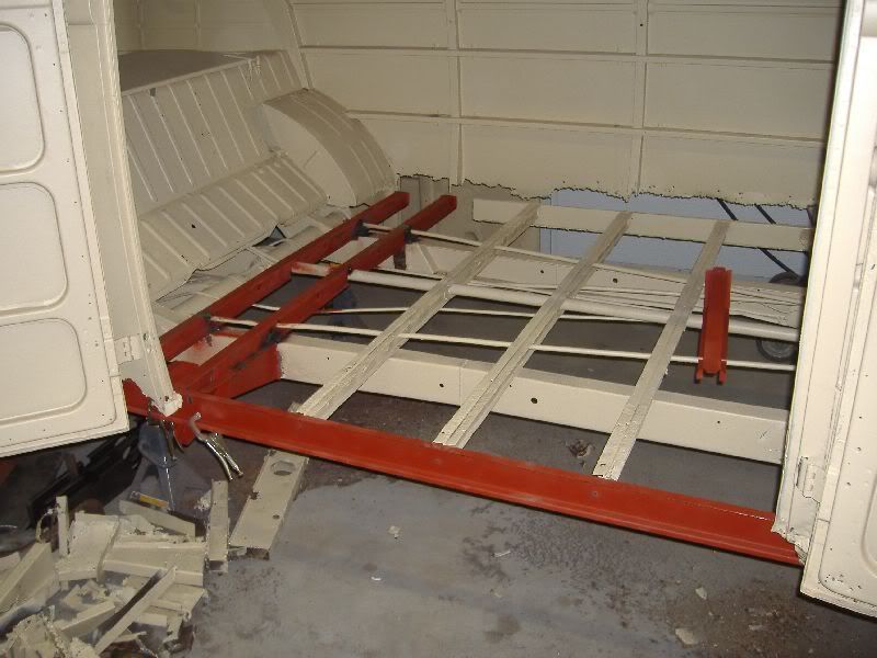

Less pretty was the amount of rust. The body was nice but the floorsection was in really bad shape. We thought the price was right so we bought the car after all.
Although the bus looks funny with the old lady, she really had to go. We want it to be as original as possible. The only improvements will be a dual 12v powersupply, bigger engine and csp diskbrakes. And maybe a dormobile top. But our subhatch roof is in mint condition, don't know if i'll ever regret this 'hack'. But the girl loves it, that's something to think about too.

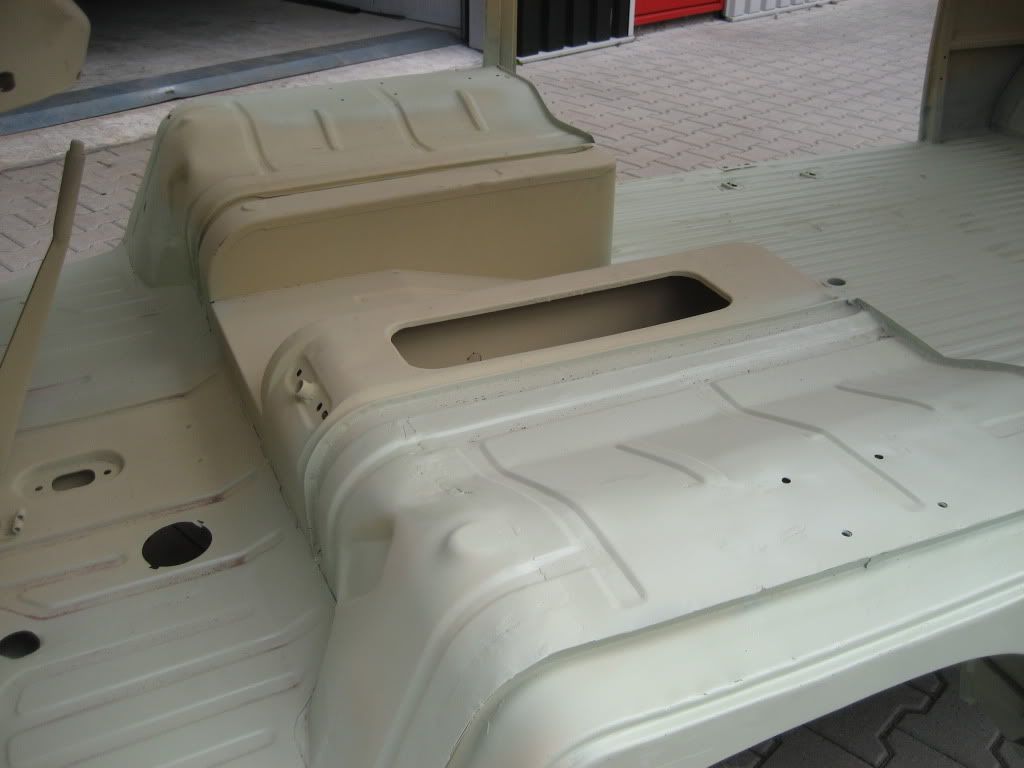

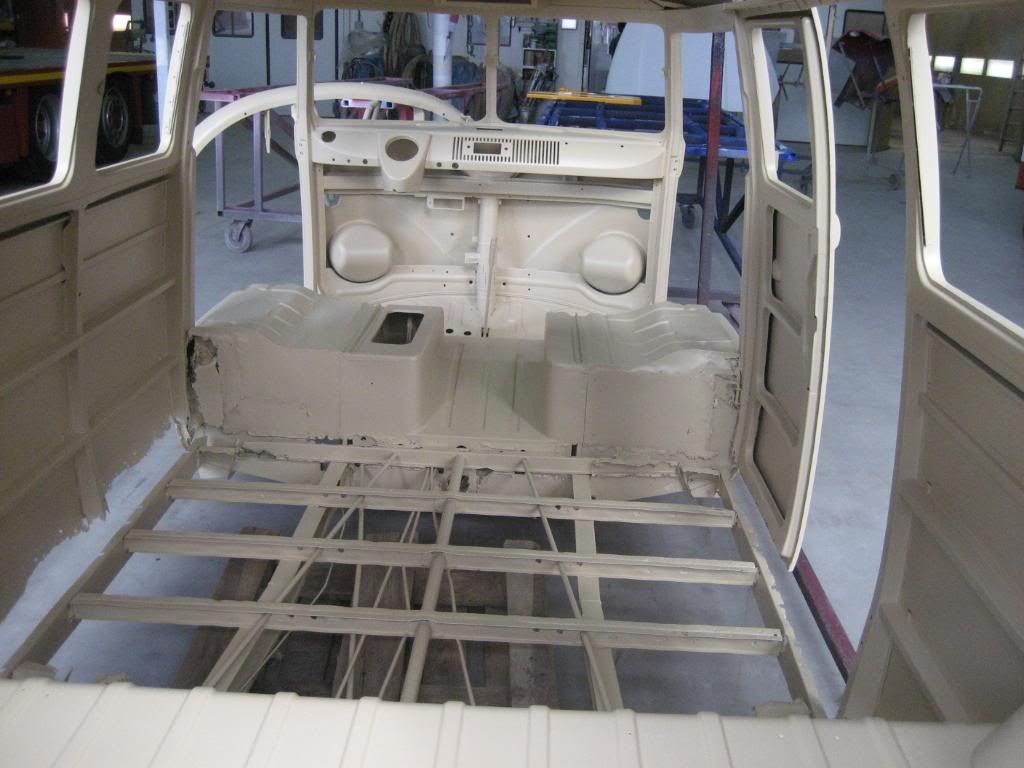

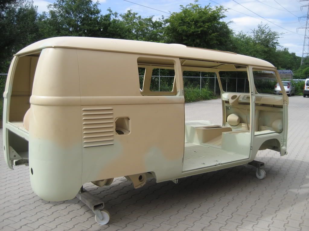

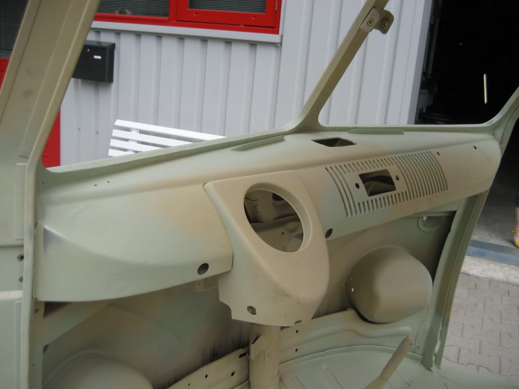

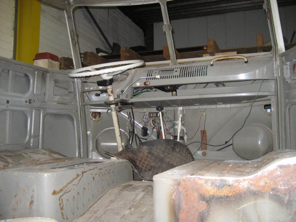

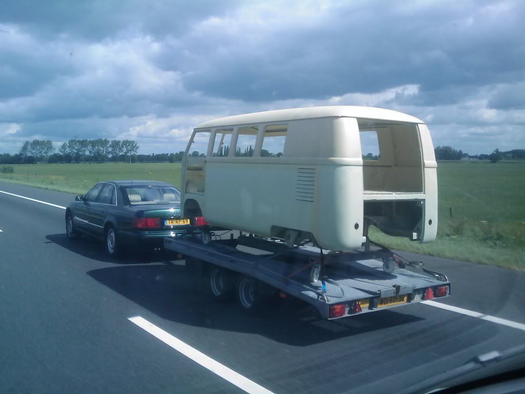

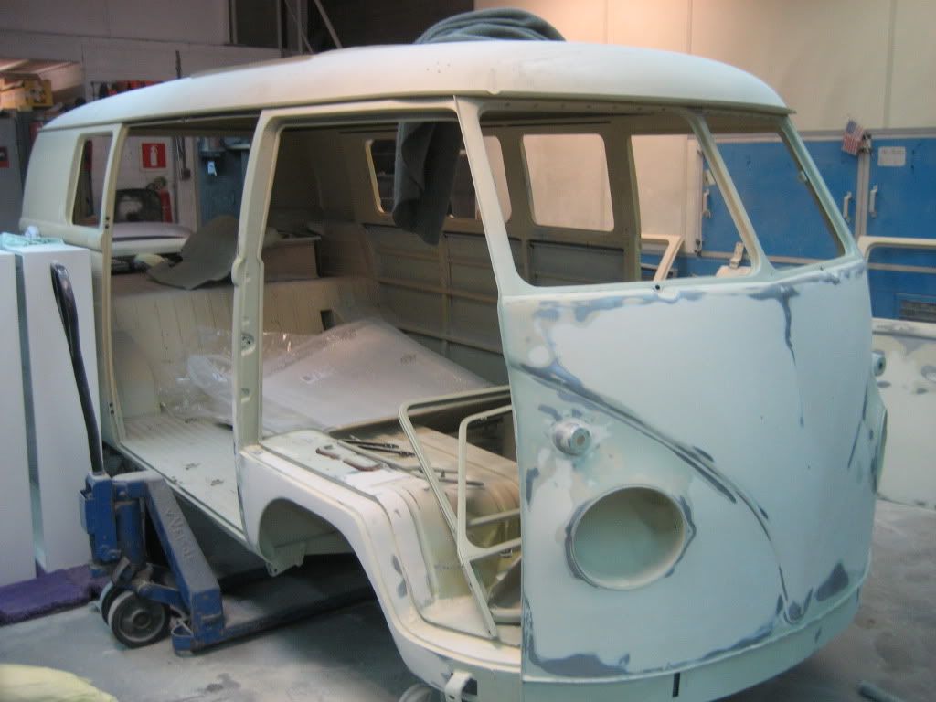

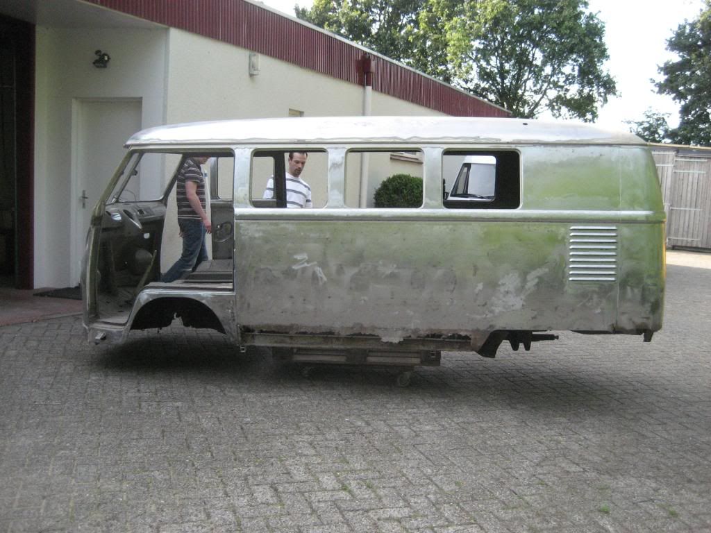

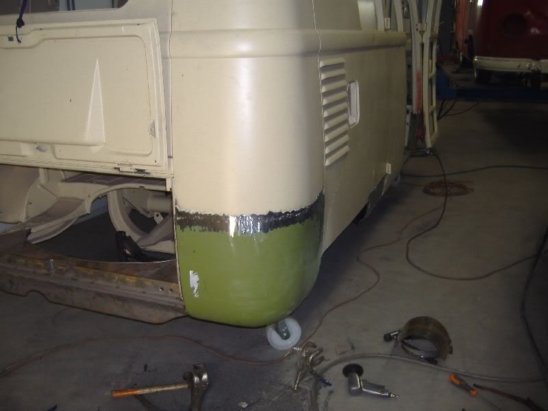

So we started our project. It all started with disassembling. Took some effort, a lot of nuts and bolts had never been touched. Next job was stripping the paint.
The car had to be sandblasted because of the rust in the frame. This was not something I was happy with but it had to be done.

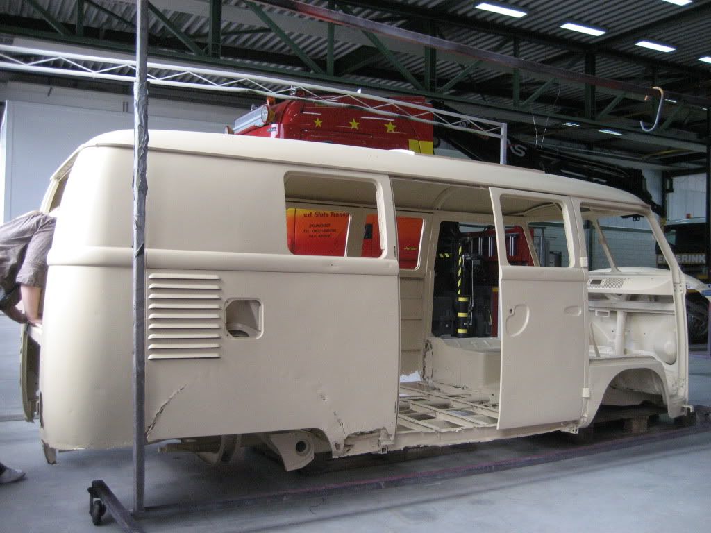

The result is a bare bus-shell in 2K Epoxypaint.

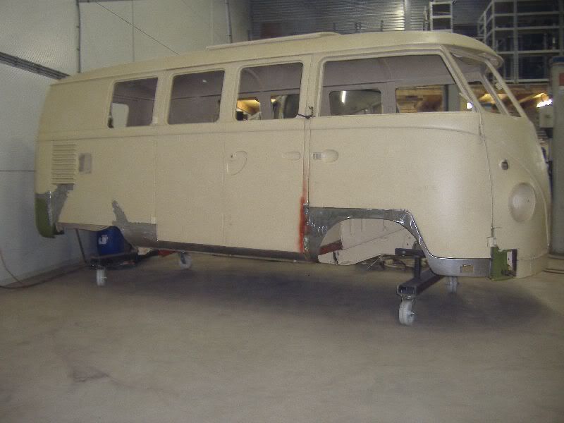

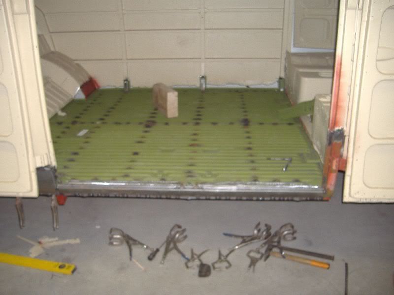

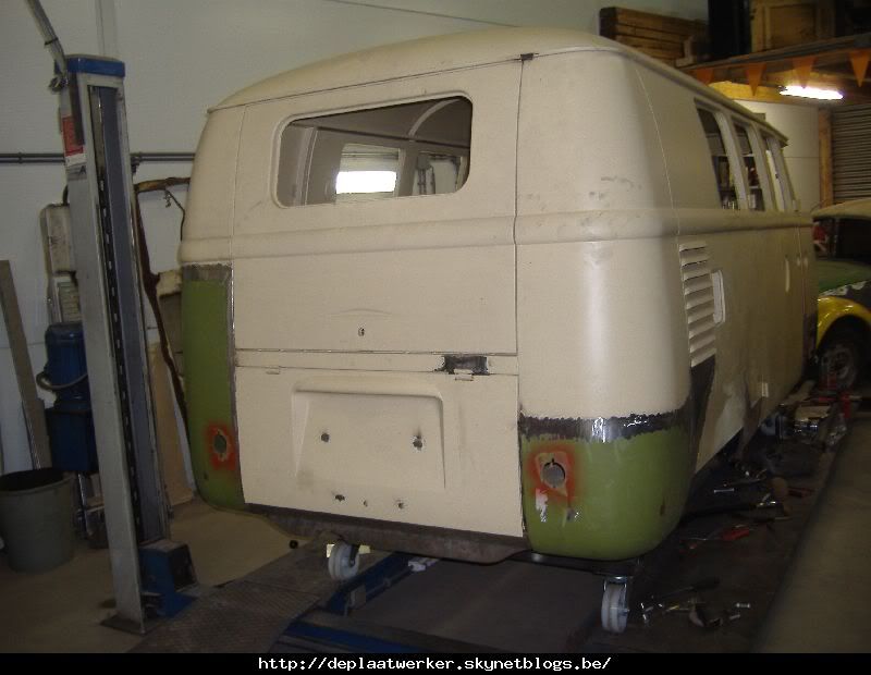

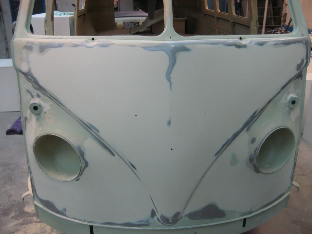

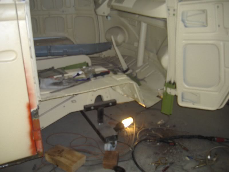

Now the car was ready for phase 2: the welding. We chose not to weld it ourselves. The amount of welding was huge and I do not have the skills to do a job like this. I did buy all of the sheet metal myself to be sure everything is A-quality. A lot of Funky green and Autocraft had been used and also some OG metal. Some bits had to be made by hand also.

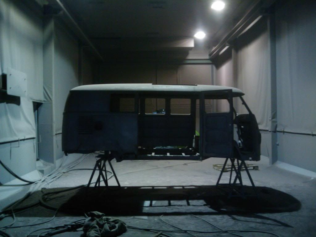

And off we go! Next stop is the painter. Fase 3.

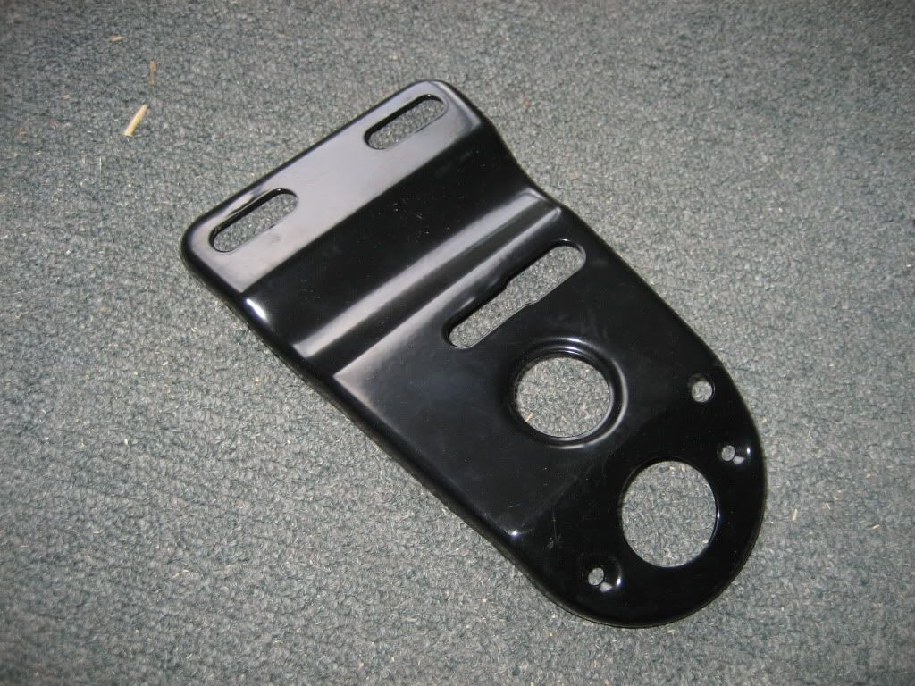

During the time the bus was at the welder I had the time to fix all the parts that needed attention. Also found and bought some missing parts.

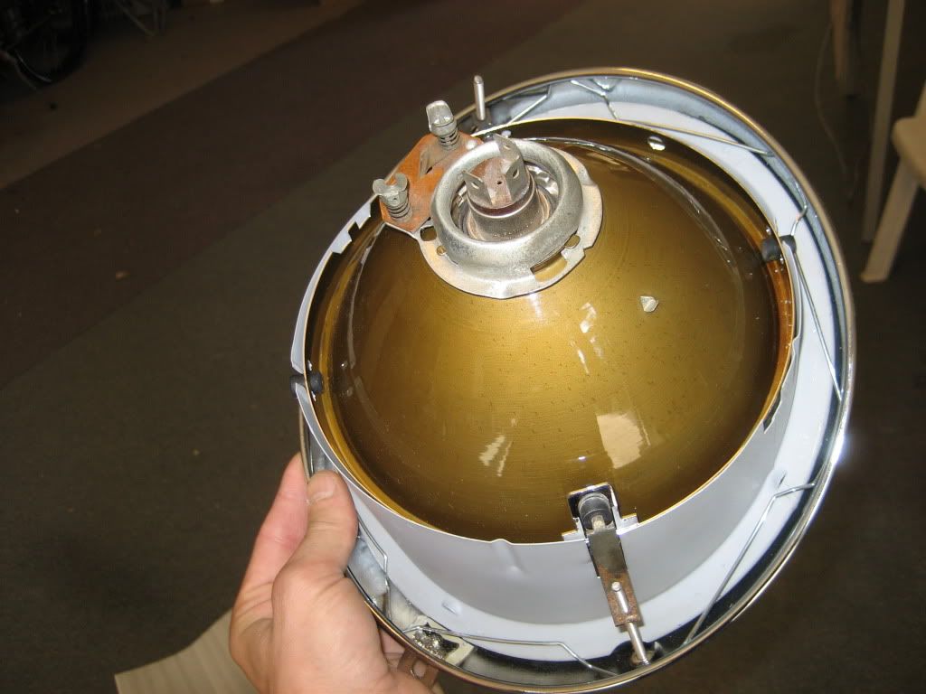

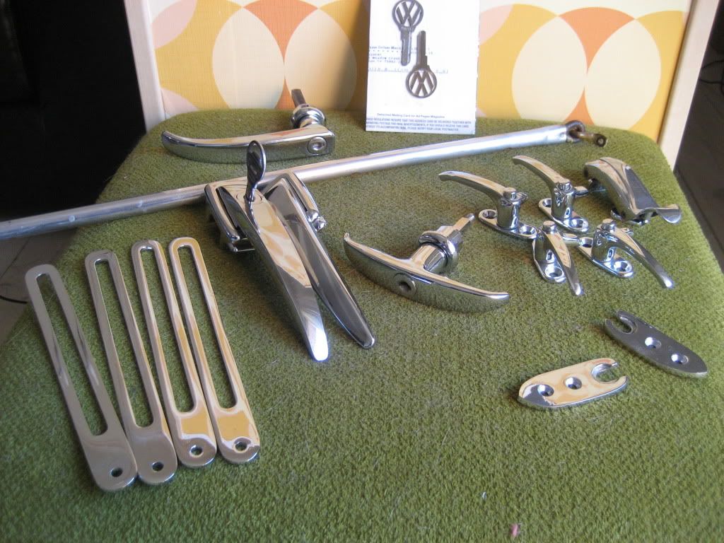

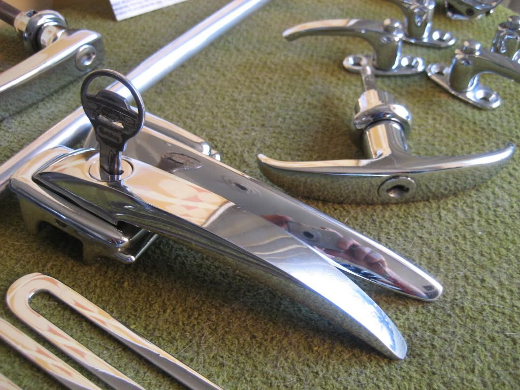

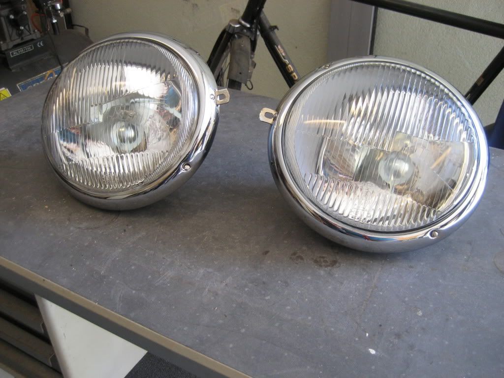

Rechromed parts:

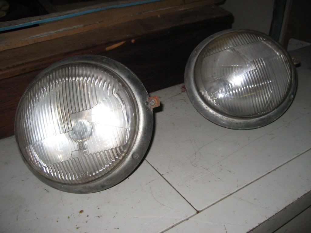

Headlights before:
And after:

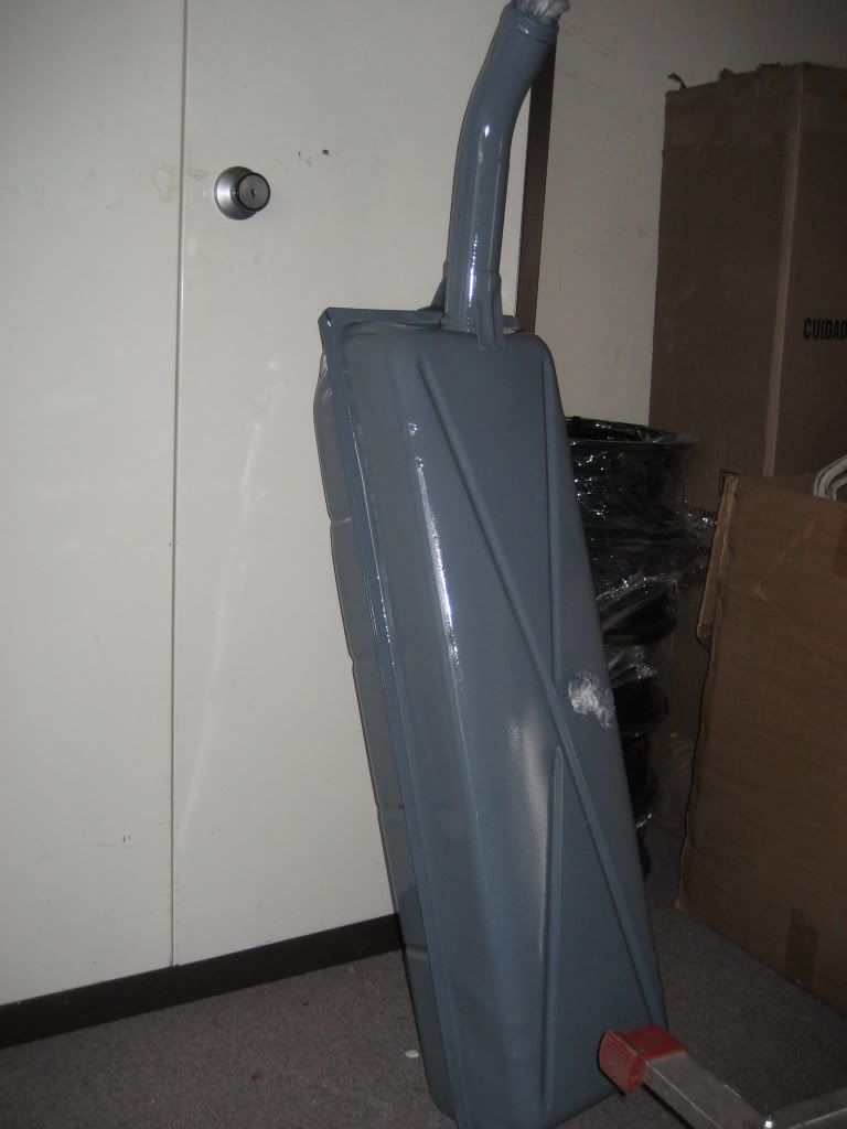

Fueltank painted:

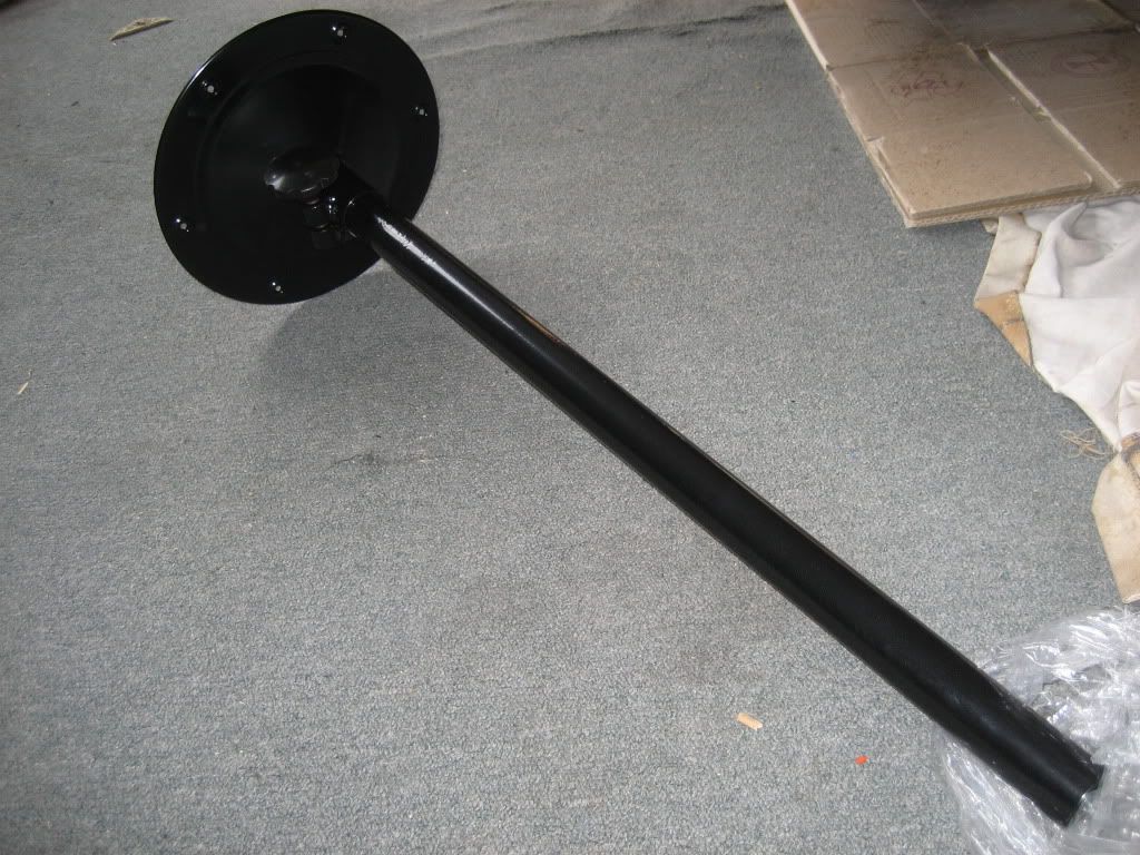

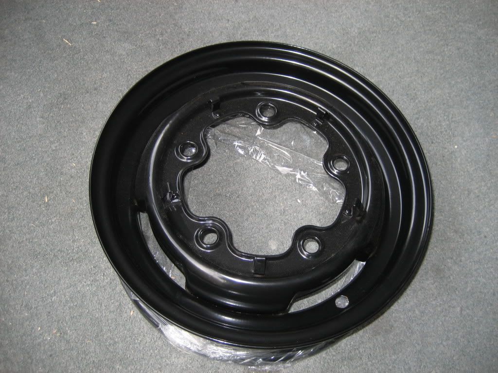

Parts powdercoated:

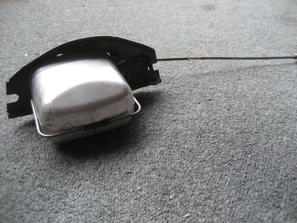

Wipermotor refurbished and converted to 12v:

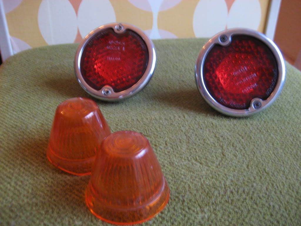

Taillights all buffed out:

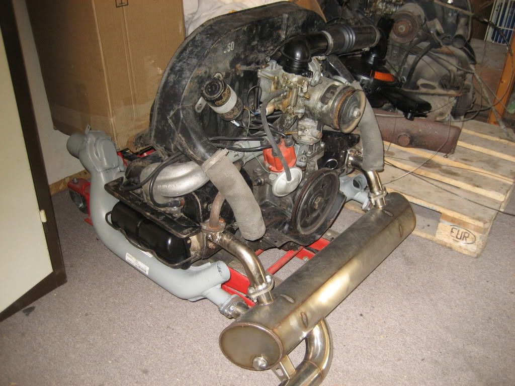

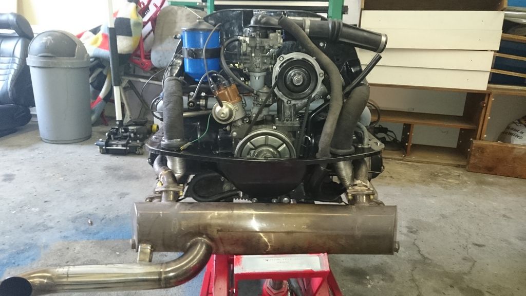

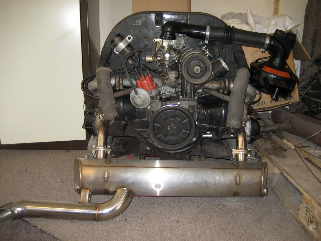

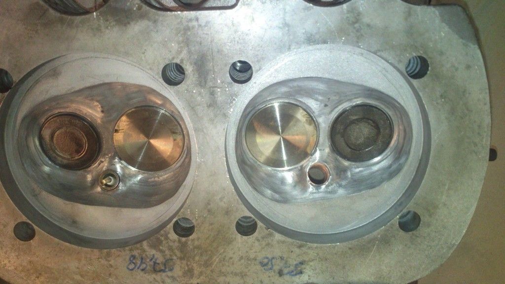

The car came with a 1300sp engine when we bougt it. Just a lame bug engine but it was still running. Since we are planning on using this car as a real camper we need something better. I’m planning a 1900sp stroker engine but we found a good 1600dp engine to start with. It has been tested and it’s running fine. Compression is perfect also an no signs of oilleaks. Also bought a taiwan exhaust and 38mm heaterboxes. The cooling tin will be powdercoated before we install the engine.

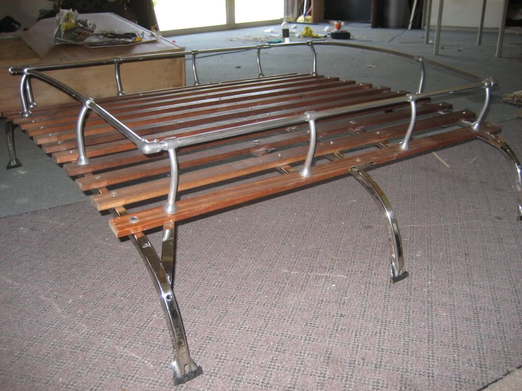

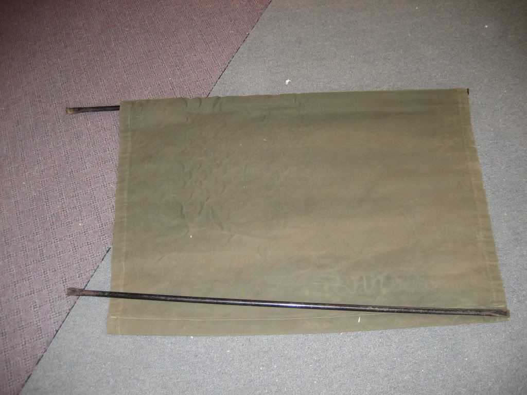

Westfalia parts fixed / bought:
Repro Awning, we also have the OG Foyer Tent:

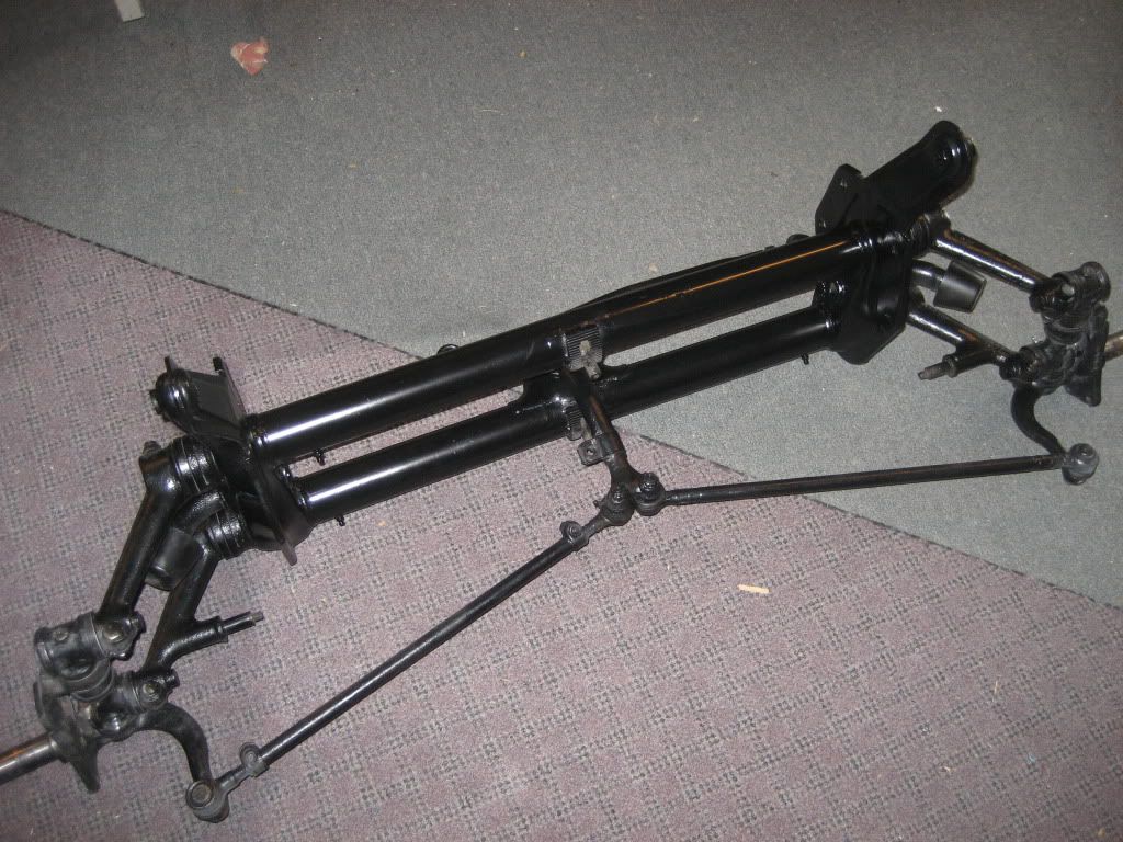

Front beam is totally refurbished. All the parts that can move are new now, beam has been powdercoated and the beam has been made ajustable. Not that we will lower the bus but now we can level the car properly.

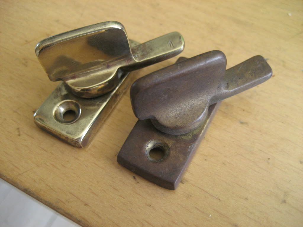

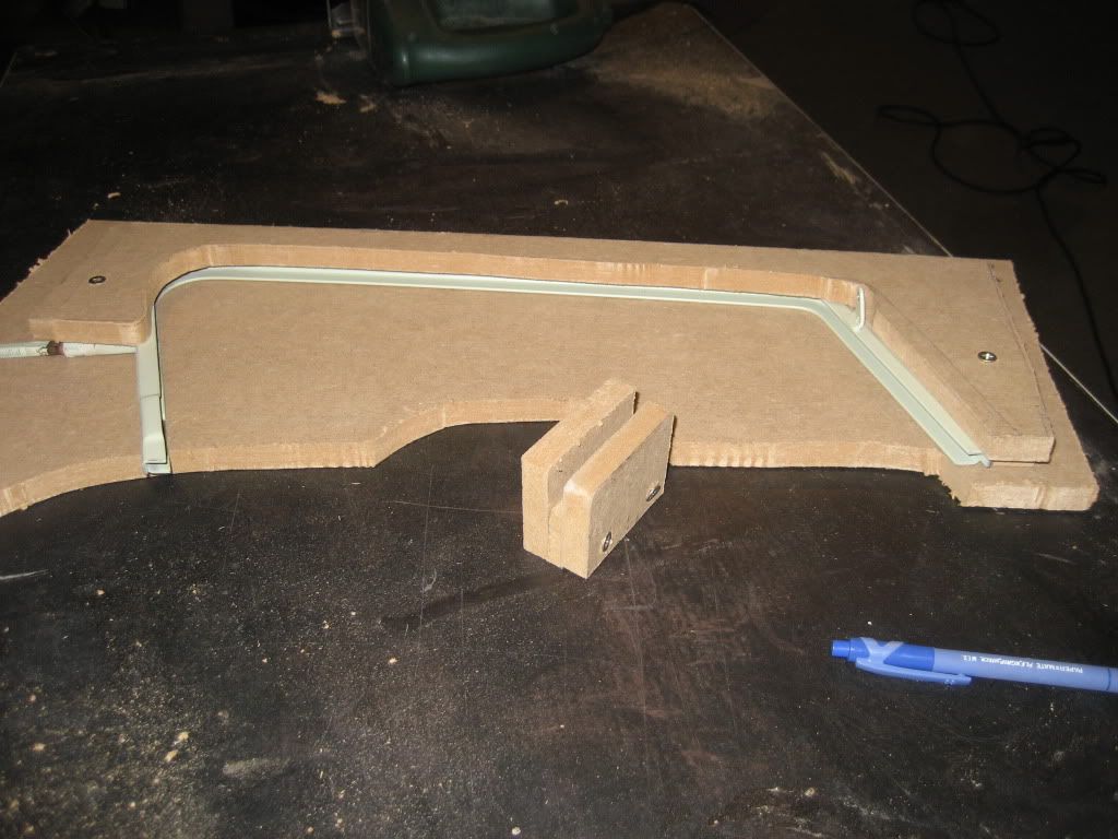

We made a tool for the ventwindows:

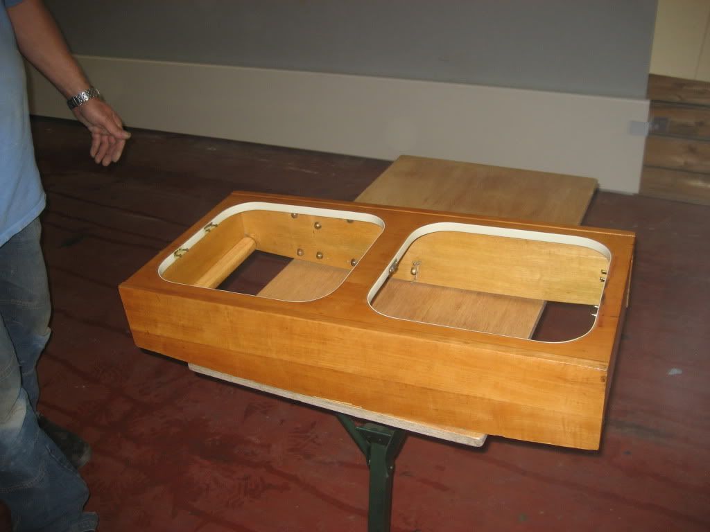

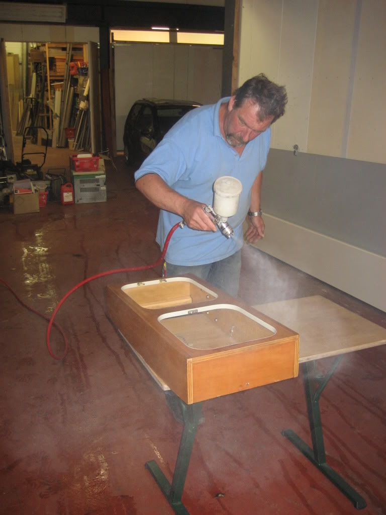

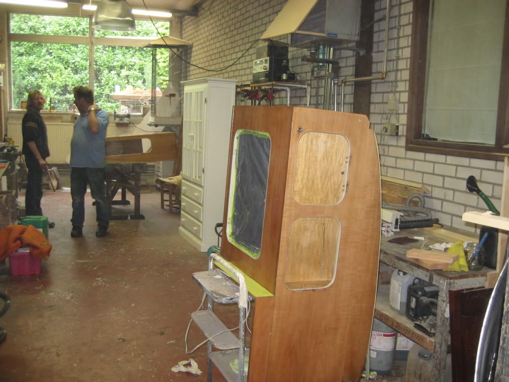

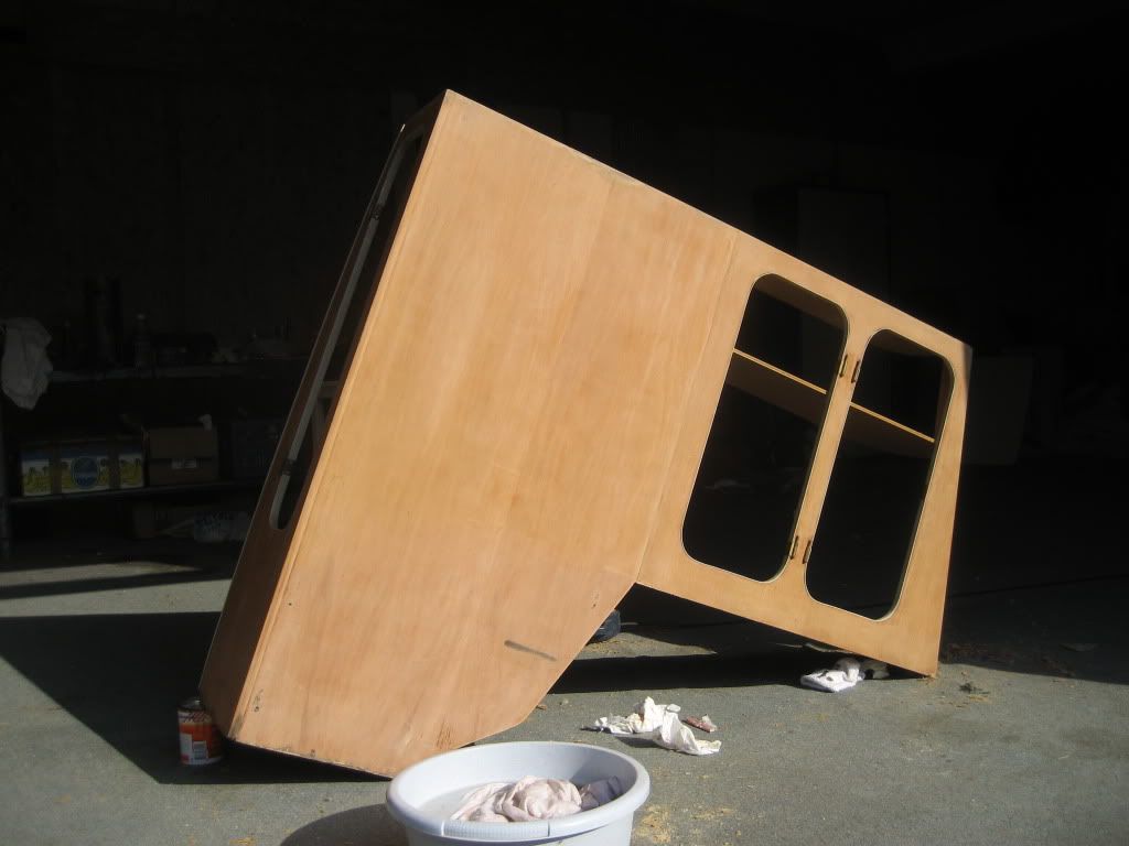

The process of restoring the cabinets. Took quite some time to get the old finish off. We did it with paintstripper and a scraper. Luckely we do not have to fix any damage.
And painting them with 2k clear paint:
They look great now!

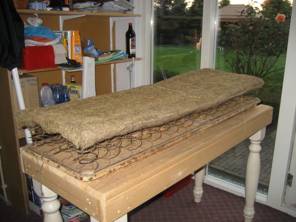

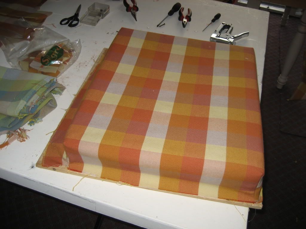

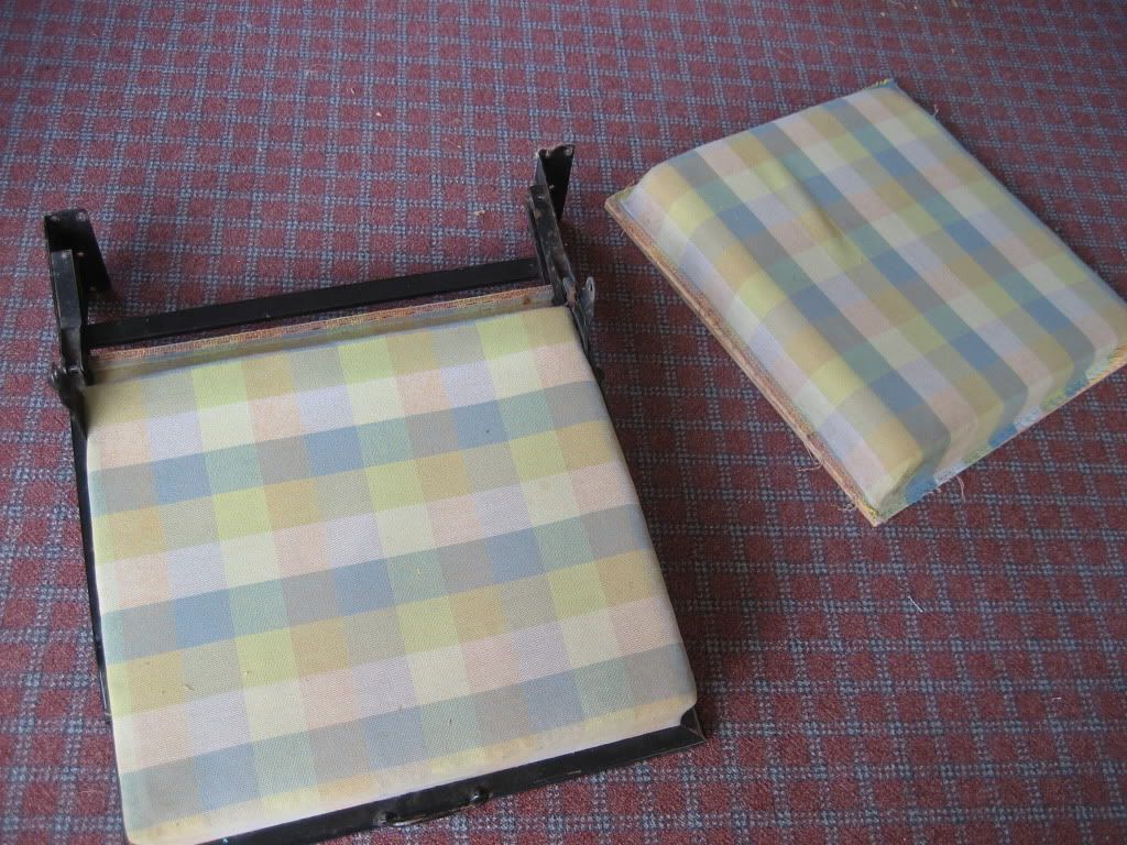

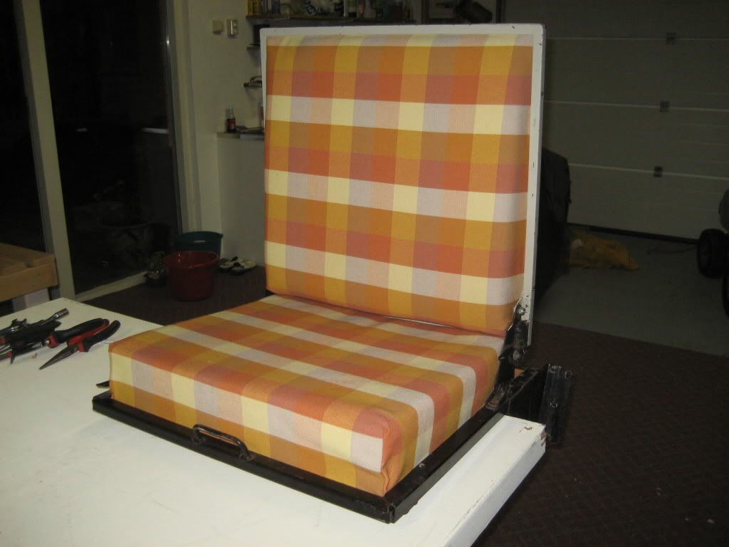

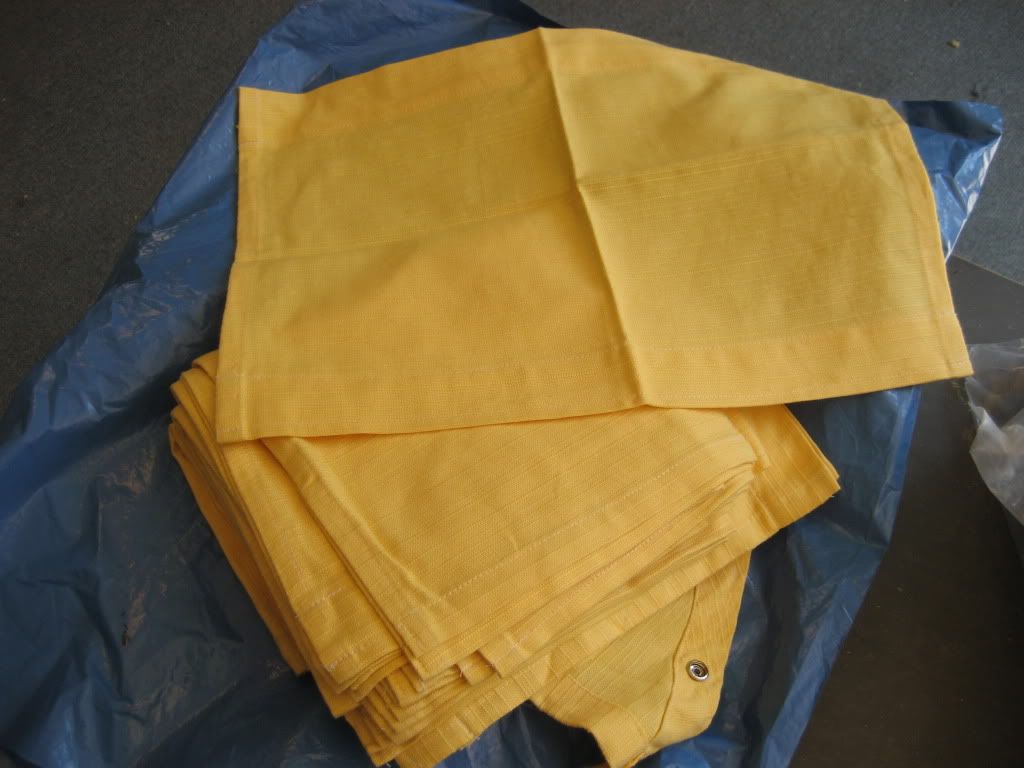

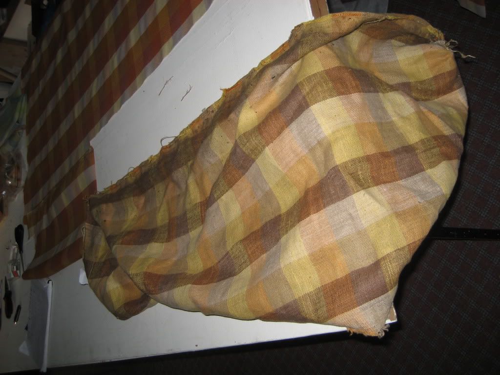

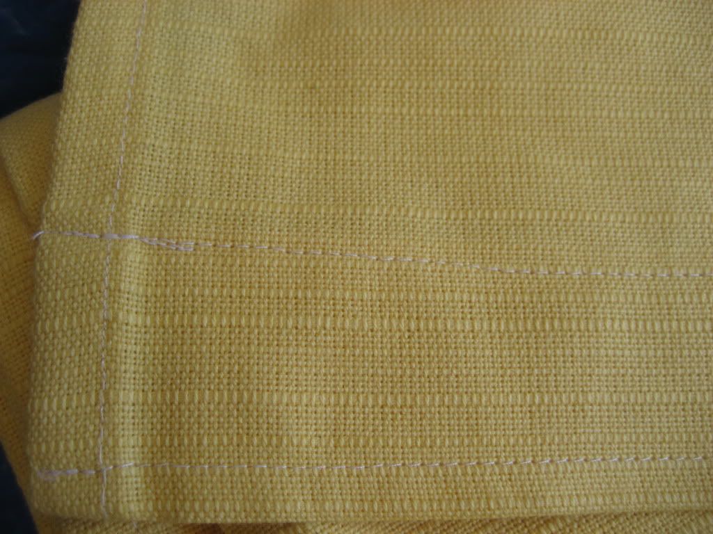

Last job I did was together with my mother. She’s handy with sowing so she’s the right person to do the upholstery. I bought 7 meters of repro material witch is an exact copy of the original cloth. It’s not the same colour that was used on our car originaly but we like it. The OG upholstery is beyond saving.
OG:
New:
Our car was missing the folding jumpseat when we bought it. We found one in Germany in good shape but in the wrong color.

Have any of that og tattered fabric left over?

vw7266 wrote:
looks awesome.....I dont know what to say about the top...
I already promised you the set few months ago. Wink I'll contact you when we're done with this job. Should be in a few weeks or so.
