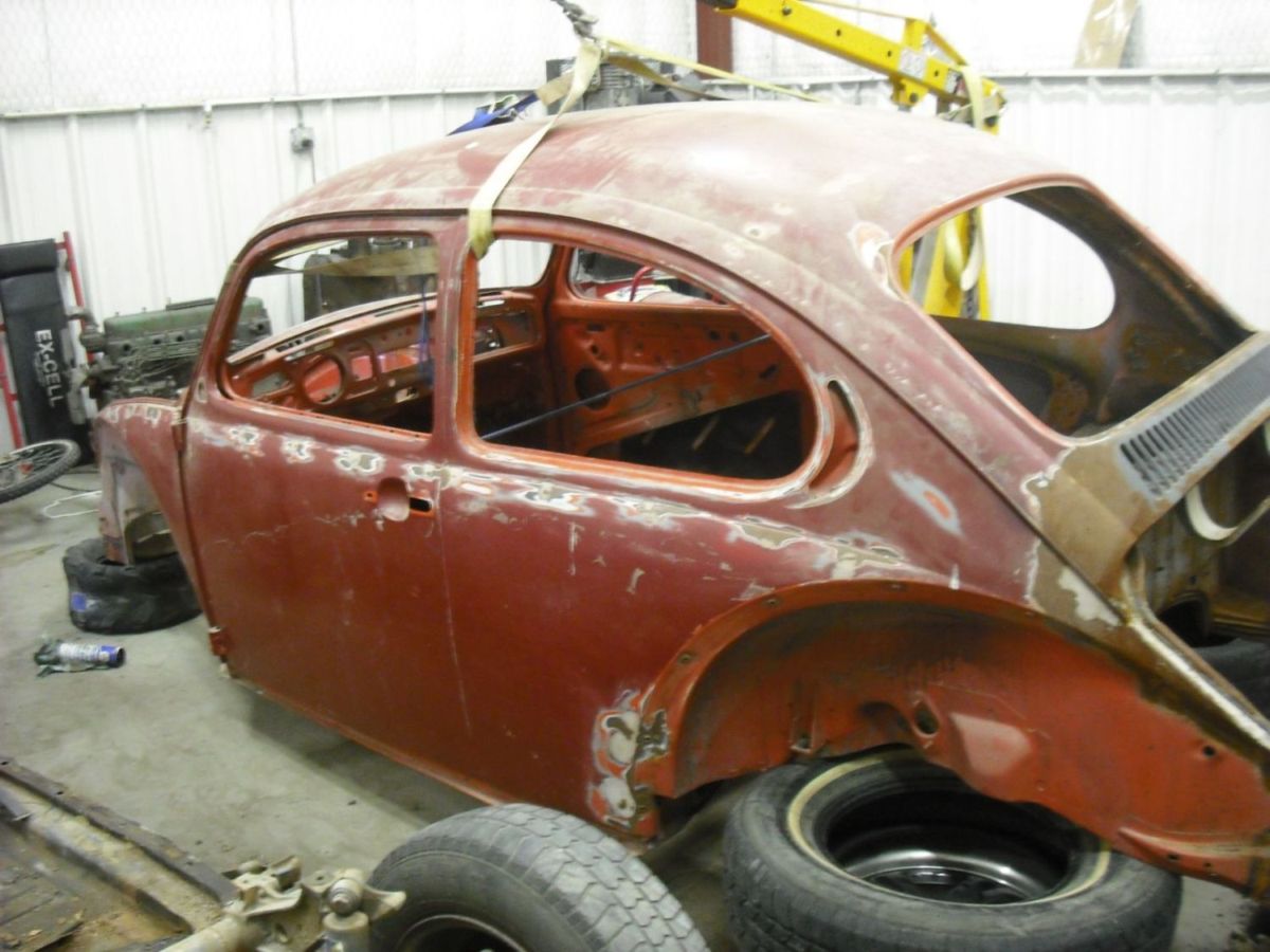

Body has been removed from the pan.

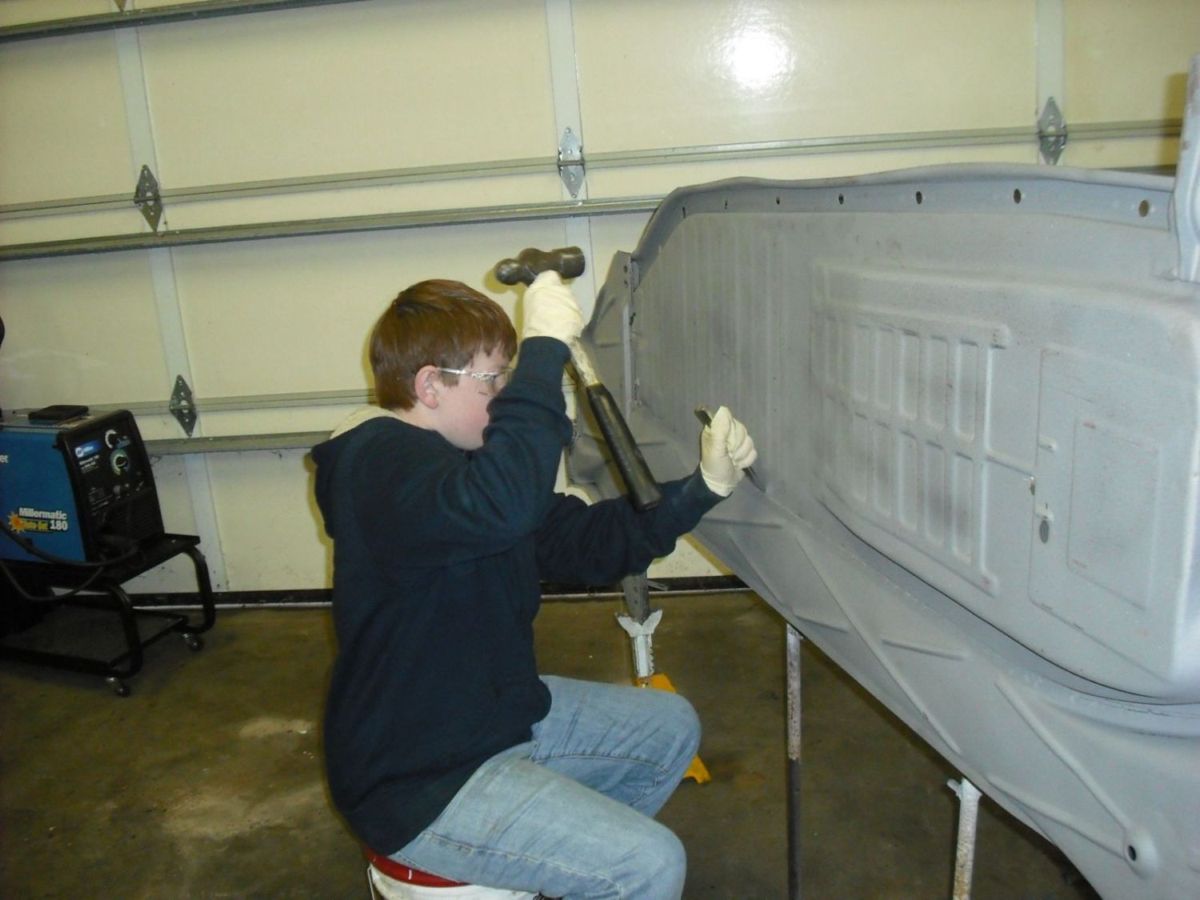

Old floor pans after removal.

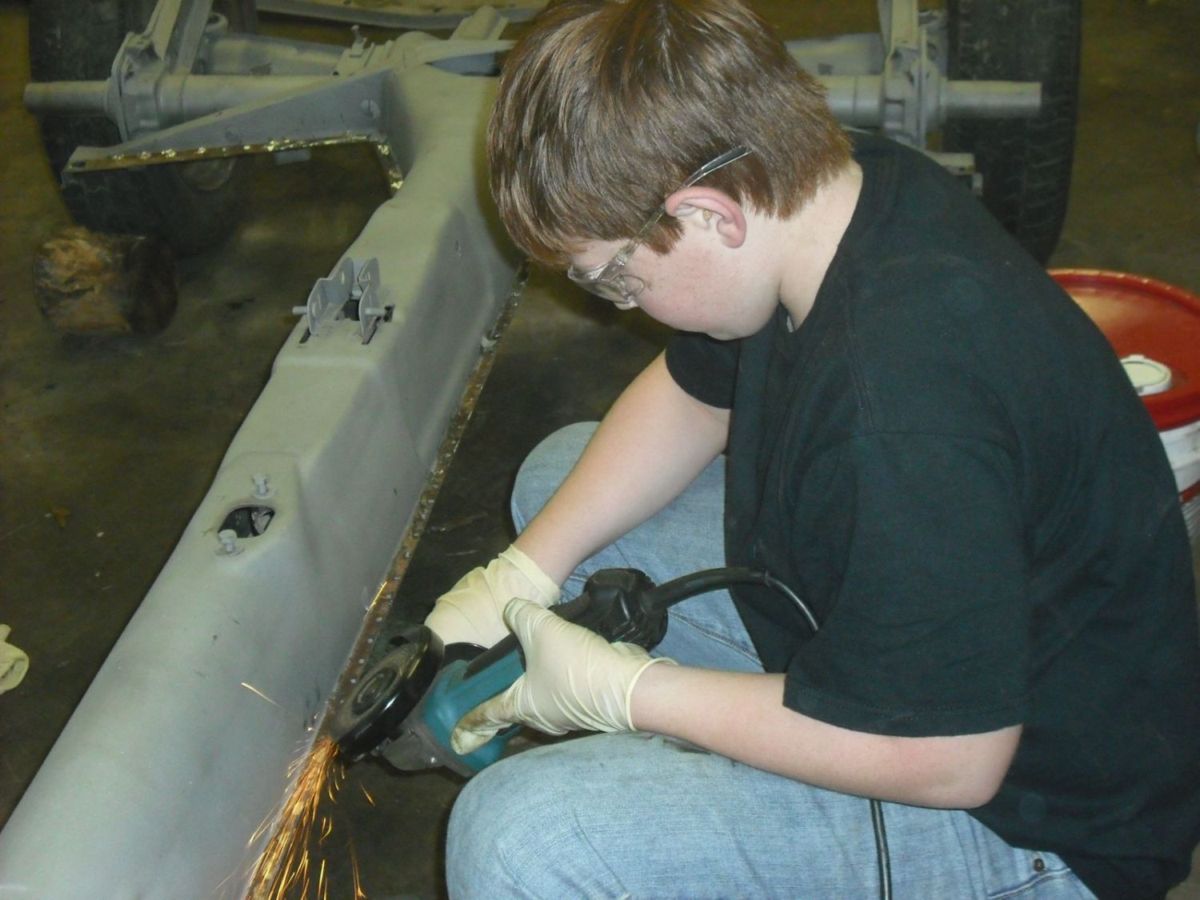

Grinding off the old spot welds.

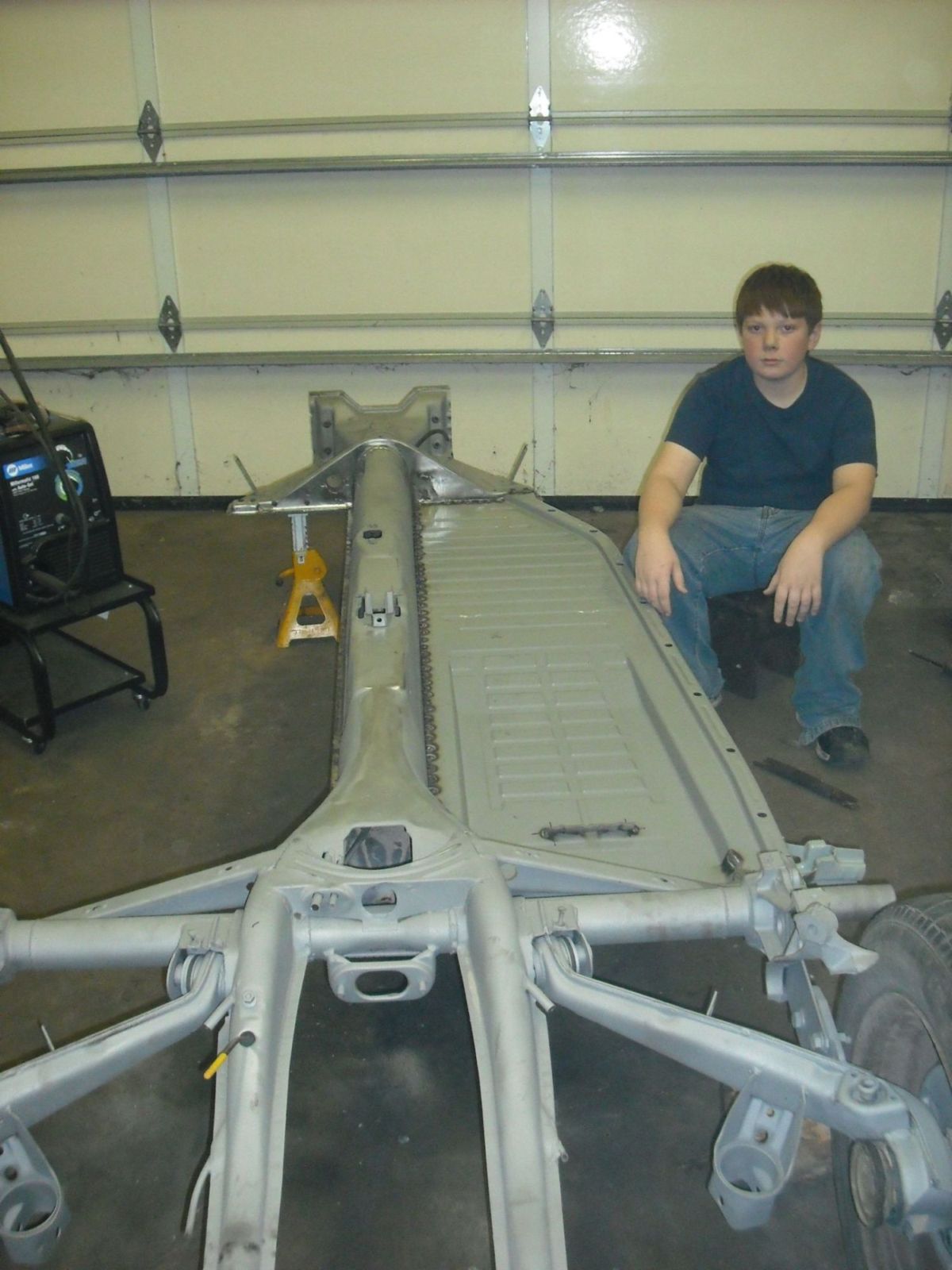

The chassis is now ready for the installation of the new Wolfburg West floor pans!

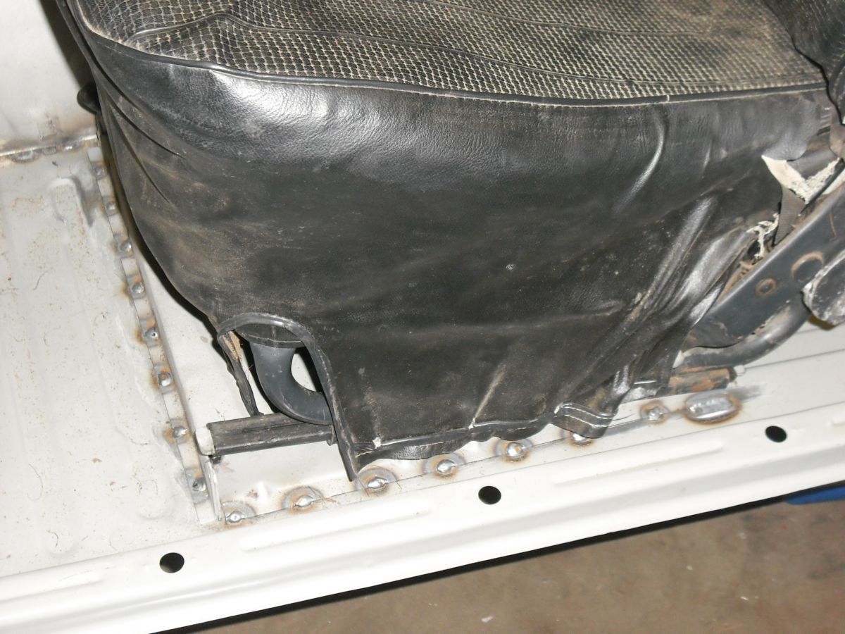

PostPosted: Fri Nov 12, 2010 10:10 pm    Post subject: Noah's 1972 VW Type 1 Sedan Restoration Reply with quote
Trial fit of seats on newly installed seat rails. The seat rails have been checked for squareness, however the seats are very difficult to move. Any ideas on what would make them move easier? I have lubed the plastic guides with WD40.

Driver side seat rail installed with trial fit of seat on tracks.
jwagner
Joined: July 15, 2008
Posts: 574
Location: chicago il
jwagner is offline
PostPosted: Fri Nov 12, 2010 10:51 pm    Post subject: Reply with quote
Looks good! Fast progress. As for lube, try whit lith grease, you can get it at most hardware stores in a spray can.

PostPosted: Sat Nov 13, 2010 6:09 am    Post subject: Noah's 1972 VW Type 1 Sedan Restoration Reply with quote
Thanks, I will give it a try.

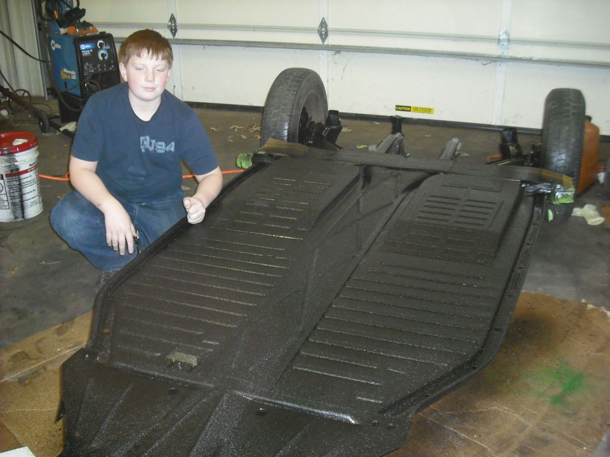

Pan bottom with Rhino Bed Liner applied.

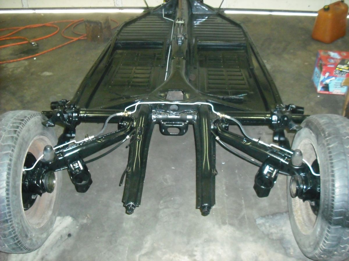

PostPosted: Tue Nov 30, 2010 10:17 pm    Post subject: Noah's 1972 VW Type 1 Sedan Restoration Reply with quote
Installed new rear brakes, lines, and wheel cylinders.
