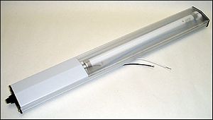

So, that evening I took it out to the van after dark for further testing. Last year I replaced the inadequate stock single incandescent light with two fluorescent lights that until today I thought were doing the job pretty well. These lights are $55 each at GoWesty or $34 at Northern AZ Wind and Sun, guess where I bought mine.
http://store.solar-electric.com/tl-151.html
my present lights:
Well, these LED strips are FAR brighter than the fluorescent lights I have! Granted I was testing two strips at a time, but it appears that even a single 12 inch strip would surpass the light output of the fluorescent presently in place. The light pattern from the LED strip is very wide, which IMO is good for van lighting.
