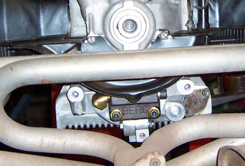

Here is one example of the adapter in question. See that bolt in the picture, that is what you need. I think it's M8, but I don't know the exact length.
Here is one from the gallery. I've never seen this one before, but it was apparently available commercially in Europe. I like that it does not use the oil pump bolts.

I would build an engine that has the correct 3 bolt holes for the mustache bar instead of using an adapter. I just don't trust them. OG mustache bars are easy to get in the classifieds here.
Holes in case for mustache bar can be seen here.
Mustache bar bolted on:
Not the best pics of it but it's all I had in my gallery.
