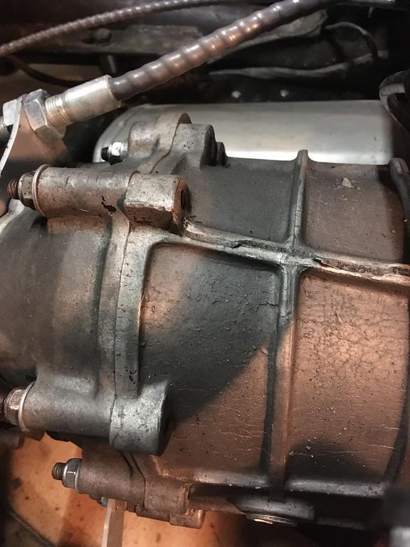

I've been wondering how to refinish my fan shroud... lots of reading on the various coating guys have applied, but not a lot of discussion about what was factory.
in this thread ( http://www.thesamba.com/vw/forum/viewtopic.php?t=100298&highlight=shroud ) ratwell suggests the fan shroud was "silvery" in color. he also suggests that sandblasting and clearcoating you would achieve the original finish...but i gotta disagree.
I'm thinking the original shroud was plated, like nickle or cad or something. after cleaning up my shroud, it has that goldish/gassy appearance:
seems the exposed surfaces fade away first, this shroud was super greasy underneath so it was marginally preserved. on the back where it was greasiest its quite well preserved
maybe they starter plating later on? were they all plated? what would you guys say was the original process? sure looks nickle to me!

Very good question, and I've wondered that myself. My shroud is original and hasn't been monkeyed with. It still has an old clearcoat-ish type of material on it (although worn) and the shroud seems silver through and through. On the other hand, the '78 and '79 brochure shows this (below). I've concluded that they came both ways, but who really knows? I know that everything else in my bus that had the gold anodized finish on it is still gold, so it doesn't make sense that just the shroud would fade. I also got a bunch of ancient photos from the original owner of my bus, and one had the engine compartment open (surprise, surprise). Although the shot was taken from about 30 feet away, the shroud appeared to be silver, even 30 years ago.

Westfabulous wrote:
Oh sweet picture, that is very gold looking isnt it...
I have an earlier shroud on the bus right now, that i also cleaned meticulously. though that was a couple years ago now, i dont recall seeing the goldish or plated appearance.
I'm thinking that gold plated appearance looks good. i'm going to call some plating shops and see what they say about plating magnesium. i think it would look sweet in original plating....

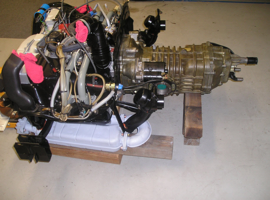

SGKent wrote:
I am not a plating specialist but I do know that some of the chromium compounds generated in chroming are cancer causing and that is why it highly regulated. Some of the places that were used for chroming are now superfund sites. A rattle can brass colored gold might be a safer product to work with that would approximate the finish. Or perhaps a goldish brown colored powder coat.
X2.....skip the greasy kid's stuff. Get a rattle can and go at 'er. Save the money, and the aggravation. 5 years from now it's going to need to be done again in all likelihood anyway.
I'm not suggesting for a second that Busadaddy's idea is a bad one, but at the end of the day, I would do the cost benefit analysis before I went down that road. If the project was a full blown mint resto, then maybe it's worth it. It certainly is handy to have options, and Busdaddy's resourceful recipes.
Quite honestly, I think that gold looks great, but to my eyes, the only thing that looks authentic to me is the natural patina. It looks real somehow. I also really liked the color that Curtis4085 used. I'd love to see a fan shroud that has been bead blasted and clear-coated. I bet that would look good.
Steve: How did you get that gold finish on your transmission? It looks good and it appears as though it was derived through some sort of chemical reaction.

SGKent Premium Member
Joined: October 30, 2007
Posts: 42940
SGKent is offline
PostPosted: Mon Oct 17, 2011 9:55 am    Post subject: Reply with quote
the transmission was cleaned then sprayed with CRC heavy duty corrosion control. I used aluminum paint on the shroud and it is holding just fine.I don't epxect it to last 100,000 miles but when it gets bad I will do it again - or maybe sooner with a color closer to original or a powder coat.
I love this look. It looks very authentic and real. If it was a durable product, I'd give it a try.
