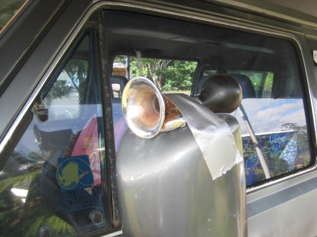

We have a cattle call horn, has a lever that lets you vary the tone a little bit. Great fun on the road to see if you can get the cows to look. Good for giving toots to children that are entranced by the van too.
