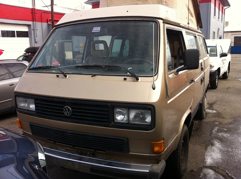

I decided I had to have one after a vanagon came into the shop with an ALH TDI. And if I was going to have one, I wanted a syncro westfalia. Hey, if you're going to go, go big.
I was watching The Samba like a hawk and had searches from Craigslist saved and would immediately email me when the key word "syncro" would come up. Called on one in Vancouver, emailed about a westfakia in Arizona but struck a deal with one in upstate New York. Sight unseen except for pictures, I bought it. 1986 syncro westfalia. Savhanna beige metallic. 280000 KM (173K miles)I HAD to have one NOW! Now to get it here...
It ran, but poorly (turns out all the intake pipes were rusted out), it needed a brake line and park brakes were weak. These are things shipping companies just LOVE! Well my neighbor is a truck driver and he had me call his dispatcher, now to wait for people to bid on it. I don't remember how long it took now, but the sell was VERY patient and had the room for it and luckily it didn't snow much up there this year.
Finally a truck show up to pick it up!!!! They said it wouldn't fit and refused it Crying or Very sad
Finally another truck showed up!!! This trucker likes a challenge apparently, and he made it work. They picked it up at the PO's house, delivered it right to my work. $1300 shipping bill later, I finally had possession of my very own syncro westfalia. My first car was a 1980 vanagon. I was back.
It's rusty, barely runs and no brakes. They call these "mechanics specials" for a reason.
Interior was pleasantly complete though, down to one ice cube tray!

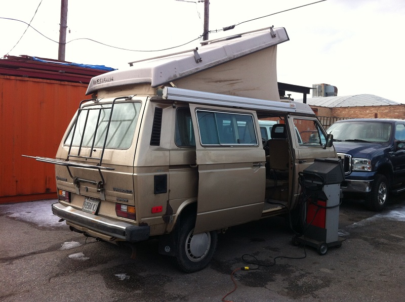

Random pic: Apollo awning deployed and works!
Fiamma brackets are on the way to modify to hold this thing, the one inch wide, 25 year old brackets are cutting it anymore. Also replacing one of the body holder brackets that's missing.

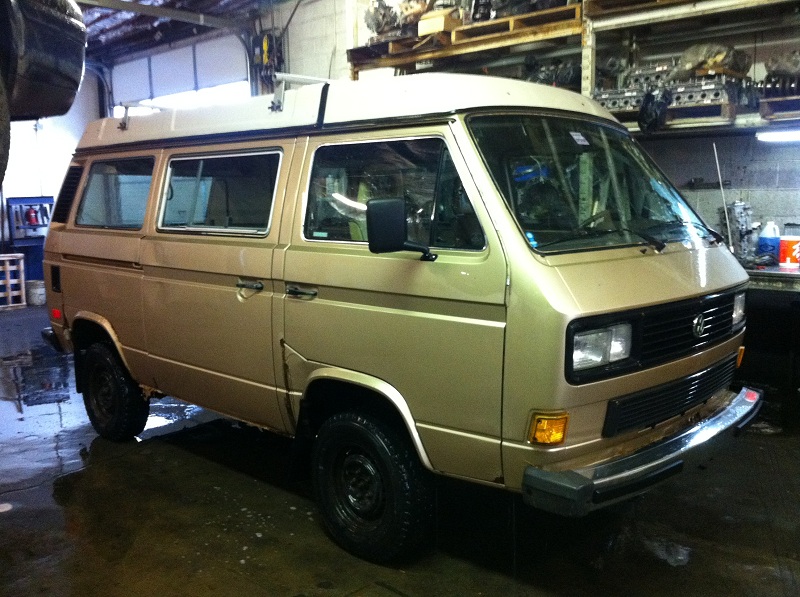

Random pic: I washed it!
Scrubbed the top, gave it a hot bath, looks 100 times better and I feel good about myself.

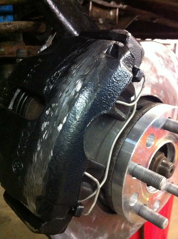

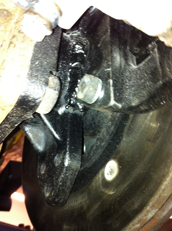

It needs brakes. Bad. Why replace with stock when I have bigger stuff lying around and seemingly lots of time on my hands? I replaced the brake line that was broken so I could at least drive it around the block, but everything needed freshing up...
I'll put these on
VW/Audi 288x25mm with single piston calipers. Basically the Van-Cafe kit? Modern parts that are cheap and easy to obtain are why I went with these parts.
Mocking it up
Barely fits under the 15" steel Eurovan wheels I am using!
Brakes with the caliper carriers modified, 10.9 bolts and stainless braided brake lines I had made locally. These will actually be installed much later.

PostPosted: Wed Apr 25, 2012 10:30 pm    Post subject: Reply with quote
Front brakes installed!
They look awesome.
They don't fit under the thick wheels.
Just needed a little haircut.

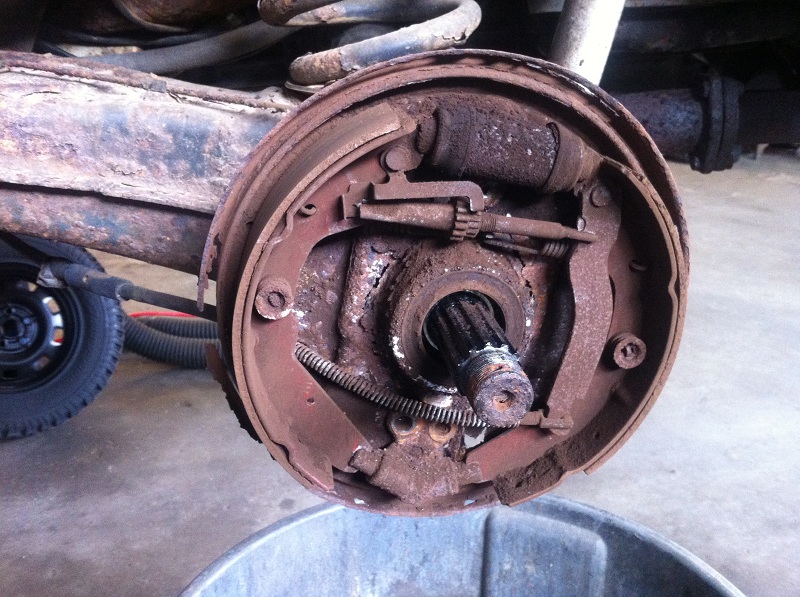

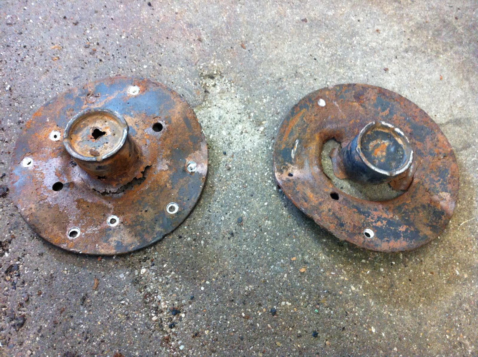

Now the brakes are still soft as I broke off the left rear bleeder when I first did the front brake hose. Turns out that was probably a good thing it didn't work.
(pic from the future of what I would come to find)...
Pretty sure if the brakes did work, it would have ripped the backing plate right off.
Did I mention it was rusty?
I had been planning rear disc brakes for a while now. I knew I needed them. I could have gotten parts off a parts van for drums, but what do I stupidly do? Oh yeah, go big...

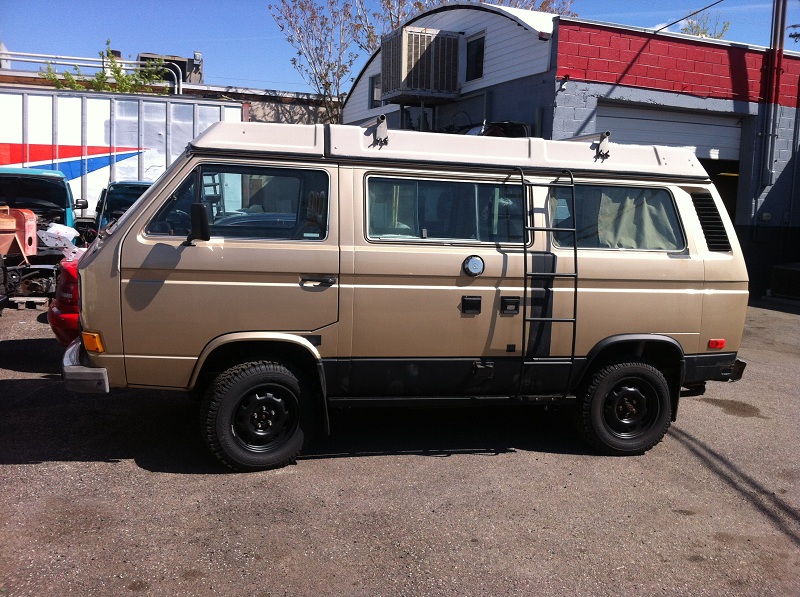

3/16" 2x2" sliders
Tubes that slid into the stock location and have pinch threads welded in
I was nearly able to jack the side of the car up with minimal deflection (from the center of the sliders), I have since welded a couple tabs to help out with the load. I also welded on some tube to be able to slide the stock jack just under the sliders at the stock mounting points as well as a smaller tab that "could" hold a high-lift in place. I plan on getting an x-jack anyway, but it's nice to have there.

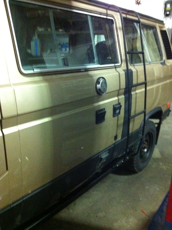

How do I get on top to secure my kayak in the future? I'll build a ladder!
Hangs in the rain gutter and is just bolted to the slider.
Don't weld galvanized conduit...
Been to the gas station twice, been complimented each time Very Happy

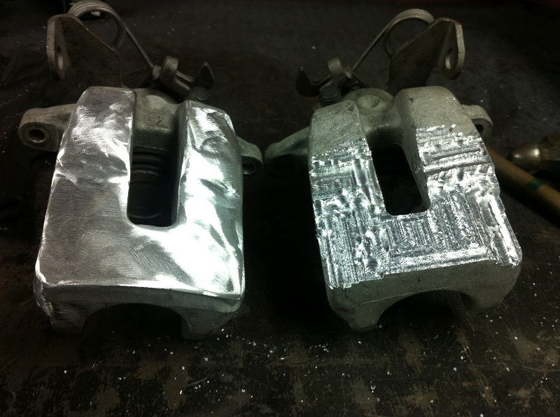

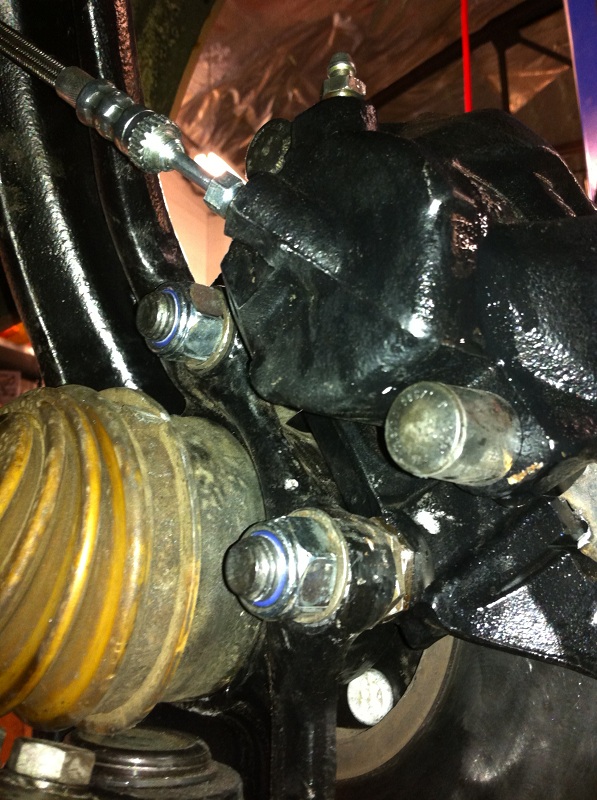

Ok so rear brakes. How about these? As compared to stock syncro front rotors Shocked
Audi URS6 front brakes 276x25mm
I wanted big vented rotors. So I needed vented capable rear calipers. I chose Audi B5S4 rear calipers because I follow the forums and found a car that was being parted out. $60 later they were mine.
I had to first grind the caliper carrier to fit the larger width. Stock rear rotors are 22mm wide, so I ground them to fit 25mm wide. Easy. Now to make the caliper fit under the 15" steel wheel. Hahaha, I osuld have stopped there...
Is what I ended up with.
I love that we have a mill capable drill at work! I just wish it drilled straight holes....
Almost there
I will end up sanding them down to fit with my electric angle grinder and a sand flap thingy.
I wasn't sure how to attach them though, brackets were kind of too big, so I ended up welding a new bracket to the hub. Here's a mock up.
Ok well that's actually welded on so I'm committed!
I got them to fit well enough to satisfy me, (I'm picky about this too, and if you think grinding on the calipers was unsafe, they still have more material than the calipers used in the solid rear disc conversion).
I also converted the connection to a banjo bolt to make it run over the top of the trailing arm.
Finished calipers sans paint with more stainless braided hose goodness.
Installed! First and last set I will EVER make!

PostPosted: Thu Apr 26, 2012 7:19 am    Post subject: Reply with quote
Very nice brake setup, sometime you should post part numbers or what you stole the parts off of.
I'm stalling on replacing my brakes, I need to do this.
