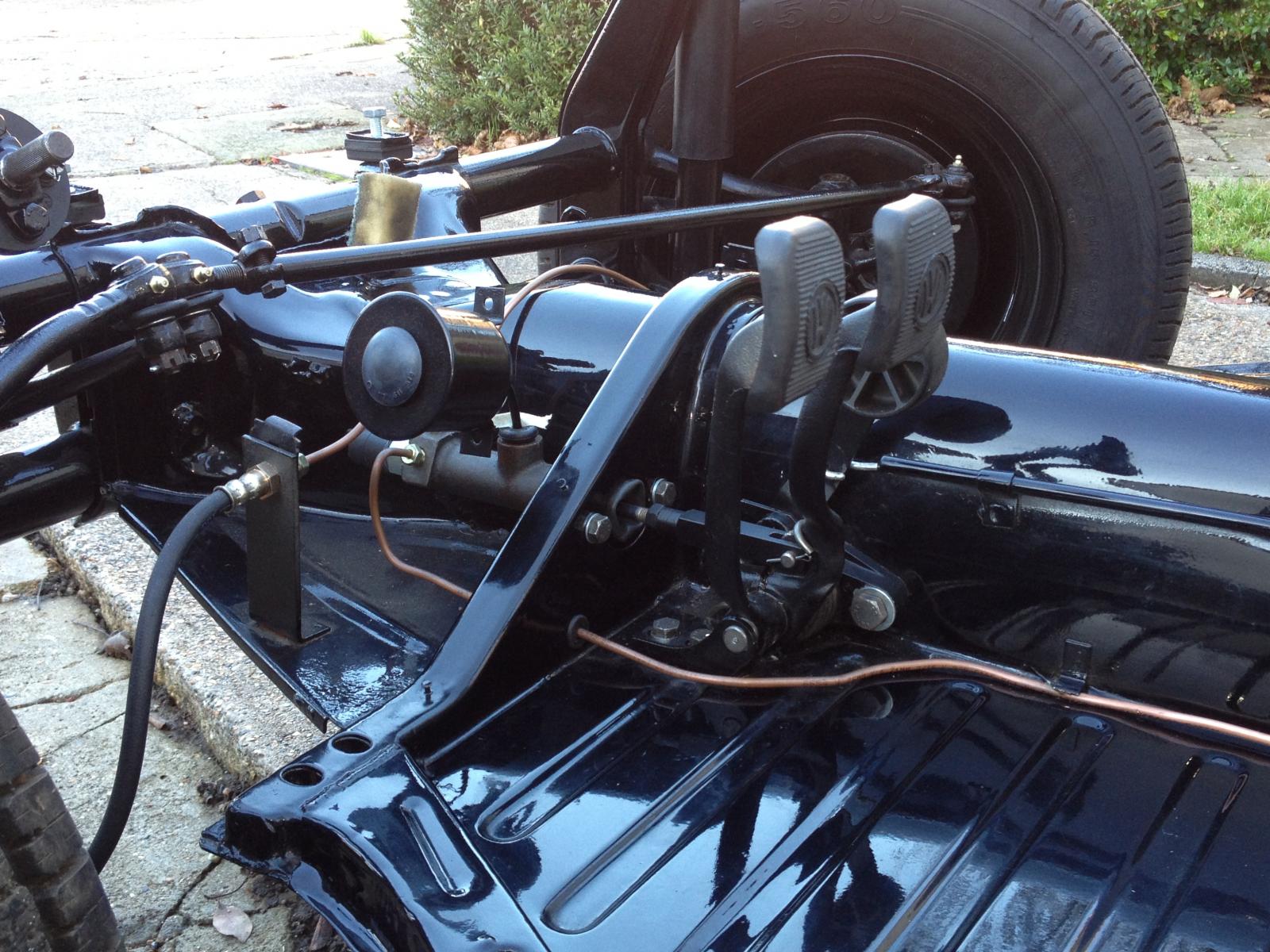

So first up was the pan. Have spent the last few months cleaning painting and assembling...
We have now finished this and our attention turned to the shell......

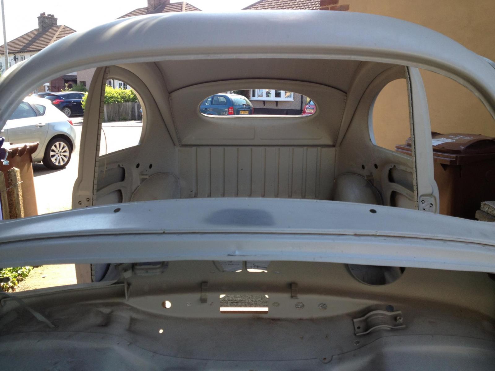

As good as it looks it still needed some work but not much!
Its now ready for prep and paint which will be its original Horizon blue.

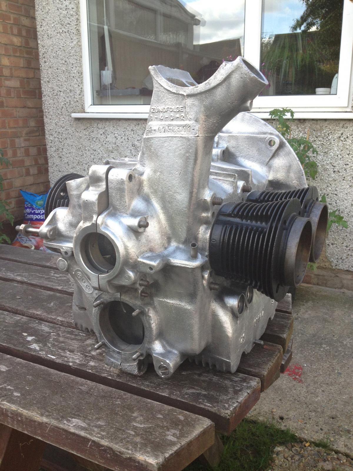

Nice stock 36hp but boy is it a proving to be hard work. It has since been stripped and sent for a line bore but im having a real tough time on finding the machining tolerances for the oversize bearings I got from wolfsburg west. Soon as I sort that I can begin putting the motor back together as I have collected the rest of the parts and had all the other machining done.
Heads have been stripped blasted and all new valves put in along with all new components like springs etc...

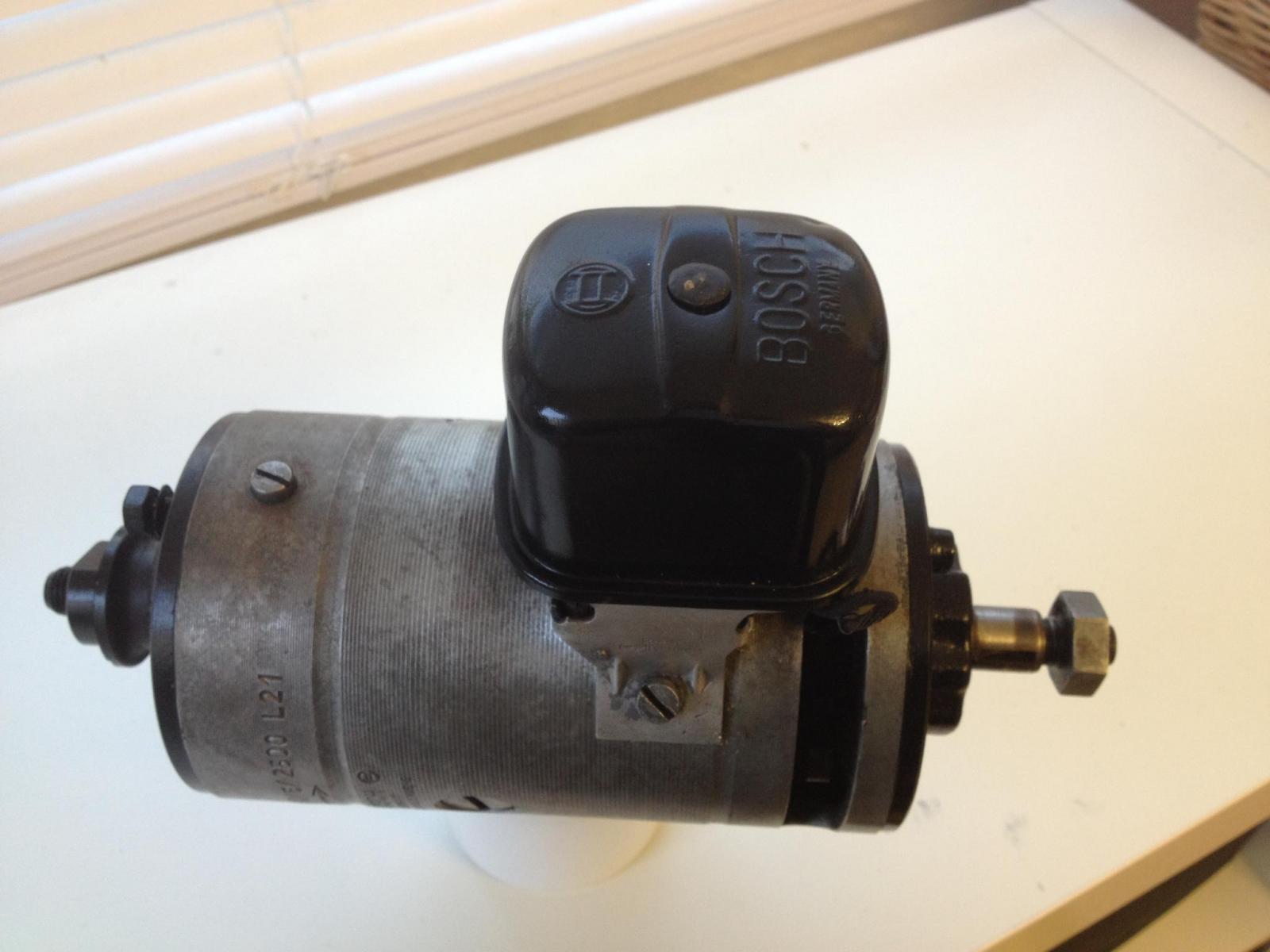

Iv been restoring the generator today pics soon Cool

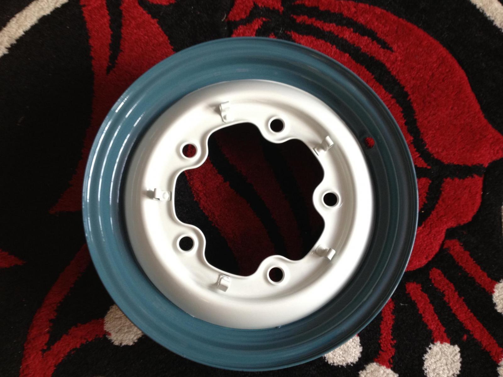

Having an og paint Horizon blue spare I had the wheel scanned and colour matched. Our wheels are being painted this week so will post a pic of the results. Here is all the information I have along with modern dupont mix codes. there is a paint chip attached in one of the pics. I found it interesting that the match came in as capri blue.

Wheels back from the paint shop today. Need a couple of weeks for the paint to harden then tyres to be fitted and we will have a rolling pan.

Dammm Dave, that colors like dead on...... Very Very Close - yay!!! I know your happy about this. Smile
Kudos to you and the painter!

PostPosted: Sat Jul 28, 2012 11:24 am    Post subject: Reply with quote
please tell me those brake tubing lines are NOT copper ?? Shocked
Cant see why that would be a problem? Iv used copper brake lines on all my cars and buses with no issues. Confused

PostPosted: Fri Aug 03, 2012 8:21 am    Post subject: Reply with quote
Apologies for the poor quality picture but my phone is all I had!
Anyhoo...............
Got the engine back from the machine shop (At last) Case is now line bored and had a shave on one half to restore the cam journal as well.
Crank has been reground and the flywheel has been re-metaled with spray metal then polished to remove the deep groove cut into it.
All the barrels have been honed and the heads are awaiting new valve guides which are proving a nightmare to get in the uk at the moment. Just cant justify the shipping cost on valve guides from wolfsburg west but might have to bite the bullet!
Case needs some cosmetic tidying due to deep pitting in places but this will be re-metaled then filed down to restore a stock look.
Thats all for now pics when I get the camera sorted.

PostPosted: Sat Aug 04, 2012 2:54 pm    Post subject: Reply with quote
Dave Byron wrote:
We used noncorrosive brake lines just like that at my last job. They exceed the standards of regular steel brake line, are flexible like copper tubing, and will probably never have to be replaced. It won't rot on the outside due to the elements, or from the inside due to the brake fluid.

PostPosted: Sun Aug 05, 2012 11:36 am    Post subject: Reply with quote
Well today was spent cleaning! case has come up lovely with a few repairs to do but nothing sinister.
All internal components are now soaking away in my special formula ready for a buff in a few days.
Couldn't help myself and put the barrels up....
Carb and dizzy next on the clean and detail list.......
