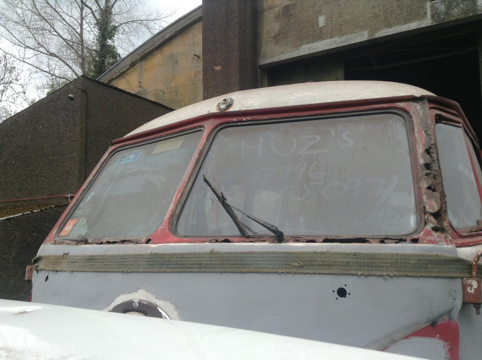

So , I realise there were a few questions about this bus when it was first for sale on here .
It was purchased and shipped to a guy in the UK , who , upon receiving it decided it may be a bit too ambitious for him and he put it for sale here .

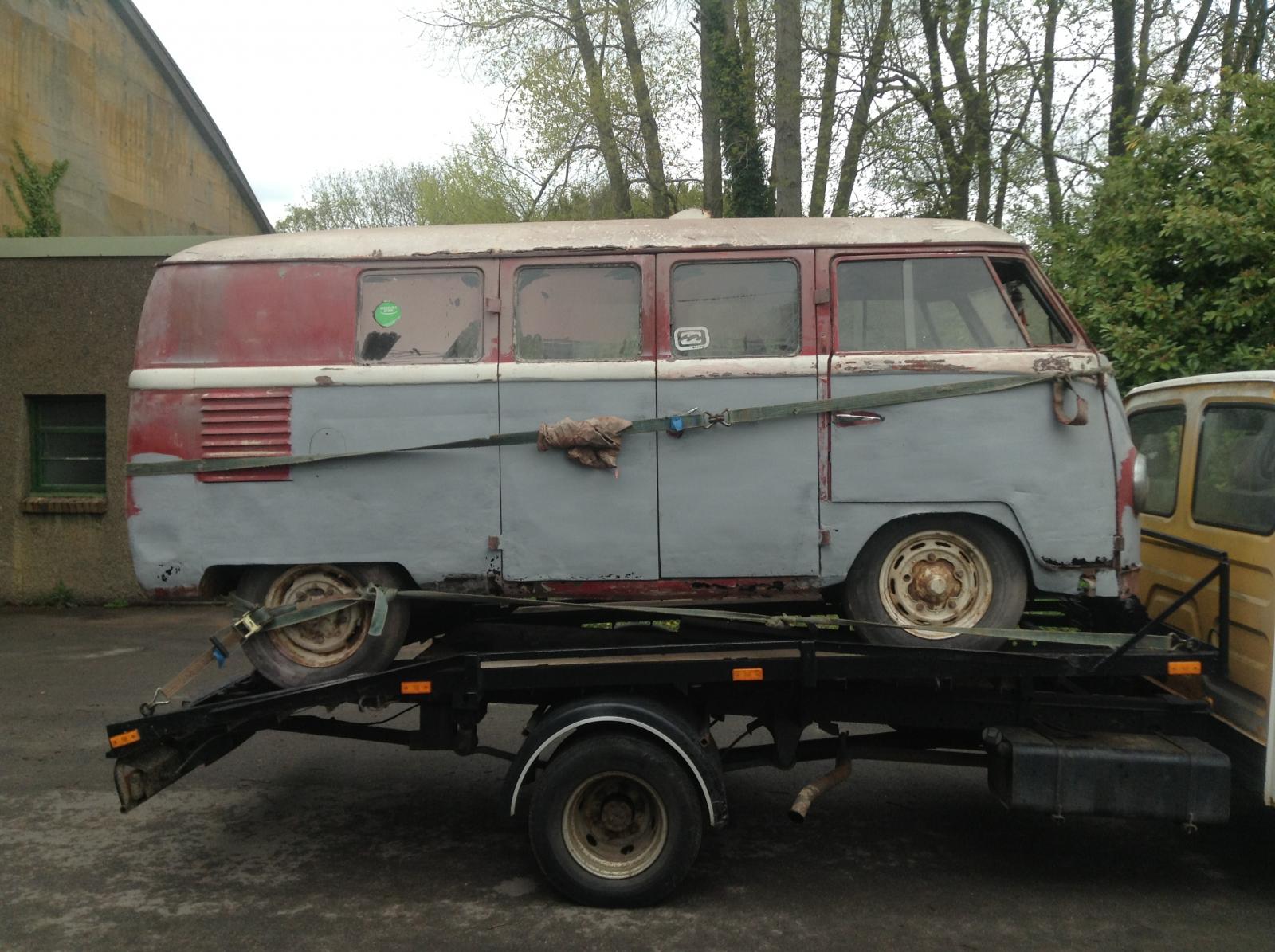

I viewed it some months ago and a deal was struck .
I managed to get it picked up this weekend .
Various shots on the transporter when it was picked up .
I now have it in my workshop and I have begun to have a little play .
I will add more pictures as I delve in - Im sure I will have lots of questions which hopefully you knowledgable folks will help me with .
