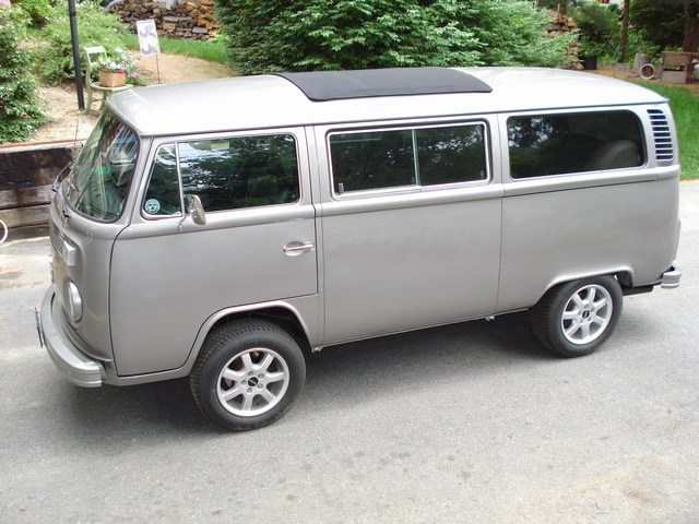

I've always used 3M window film and after 8 years in my current bus it still looks good and hasn't had any noticeable color degradation. If you want to save some money you can certainly do it yourself. I paid for the first window tint install 30 years ago. When I saw how it was done I did the next 3 vehicles myself. (You might want to check on your DMV's websites to see how dark a film you can use. Here in MA I had to go with a 35% tint.) On my current bus I was doing new seals anyway so I popped out the windows. You can apply the tint with the windows in place but it's just harder to trim where the film meets the seal when you're done. I've done it both ways. The key is getting the windows squeaky clean with glass cleaner and razor blades. Then apply the film after spraying the glass with water. Use a piece of film bigger than required since you'll be trimming it when you are done. I use plastic Bondo applicators to squeegee out all the water bubbles and stick down the film. Start in the middle and work the water bubbles towards the edges and dry the water with a paper towel. After each window dries use a razor blade to trim the edges then reinstall if you're using new seals. If you are installing the film without removing the glass you can trim the film at the rubber seal using an Exacto knife or razor blade. There is a knack to applying window film so I recommend you practice the technique first. My son installed window tint is his van last year after spending some time applying/re-applying tint to a spare window I had laying around. One word of caution, after installing the tint you should only use glass cleaner without ammonia. I'm told that the plastic film is degraded by cleaning products with ammonia.
