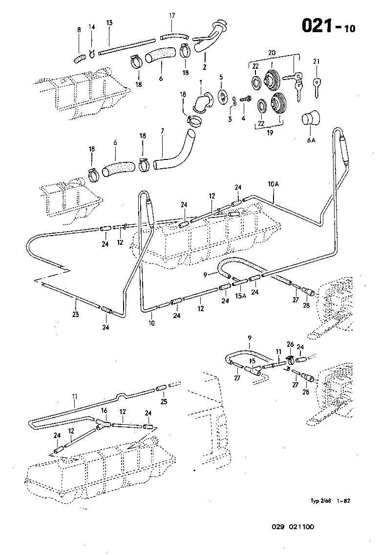

PostPosted: Tue Dec 23, 2014 5:38 pm    Post subject: 1972-73 Type I EVAP System Reply with quote
The Fuel Flap makes this a pre 74 fuel tank ventilation system (minus the extra vent in the filler system) for a Type 1 upright engine depicted by the air cleaner.
Pic courtesy of peteandvanessa
http://www.thesamba.com/vw/forum/album_page.php?pic_id=1235211.jpg
busdaddy wrote:
Great drawing, but it doesn't include that evil 72/73 center vent and the elbow that leads to the filler neck, a great pre production artists conception of what next years vapor system theory including the separator/condensor bulbs looks like though Very Happy
busdaddy wrote:
Tcash wrote:
BD should I delete it?
No I don't think so, it shows the vent system all later buses use, only 72/73's with the gas door use the extra vent in the filler system, it applies to all 72+ buses as far as venting goes.

PostPosted: Tue Dec 23, 2014 7:01 pm    Post subject: Reply with quote

Might be the European version for certain years?

PostPosted: Tue Dec 23, 2014 10:56 pm    Post subject: Reply with quote

PostPosted: Wed Dec 24, 2014 1:35 pm    Post subject: Reply with quote
busdaddy wrote:
ahhh, found this one from mr. Ratwell!
