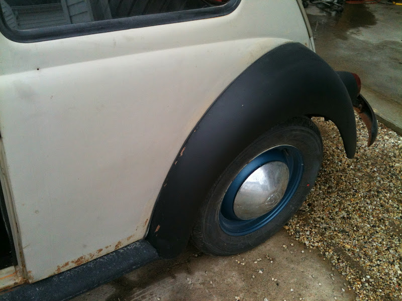

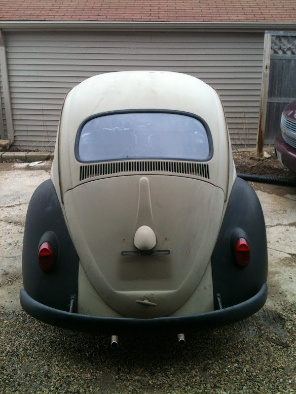

Well now that I have the beetle in my shop. I had big plans for it. I had a vision in my head. I wanted a "hoodride"... Not sure what else to call it, but the 67 will be a true show car. I am not going to want to scratch or scrape it, it will always have to be cleaned and polished for shows. I just wanted something that I could hop in, drive around, take to the occasional show and what not. I envisioned a slammed early bug, roof rack and the roof rack schwag on top....
Now, I wasn't loving the color of it. I didn't like the black fenders or the tan. The paint is very porous and attracts oils from your skin and grease like crazy. It also seems to store those stains in it. I thought about repainting it, clearing it...etc. But... have to keep myself honest... no major work on this one... So I decided to go against it. I just cleaned it up with some wax and grease remover. It took care of most of the stains, but it's also lifting the paint. Oh well...
The first step was to get the car lower and get rid of that stock whistley exhaust. I went to a swap meet in the spring and found myself a nice stainless dual tipped muffler and a pair of modifited heater boxes for it. I got those installed in record time. I found that the previous owner was a psychopath and had all kinds of weird crap in there to hold the exhaust in. I got rid of all of that and got the exhaust in. Next was to order up a set of extended swing plates. I didn't go with drop plates since I will be going with air ride. So I opted for the extended spring plates from Wide 5 Aaron. Was a great deal. Installed in a snap, lowered the rear and bam! I was on my way to my vision....

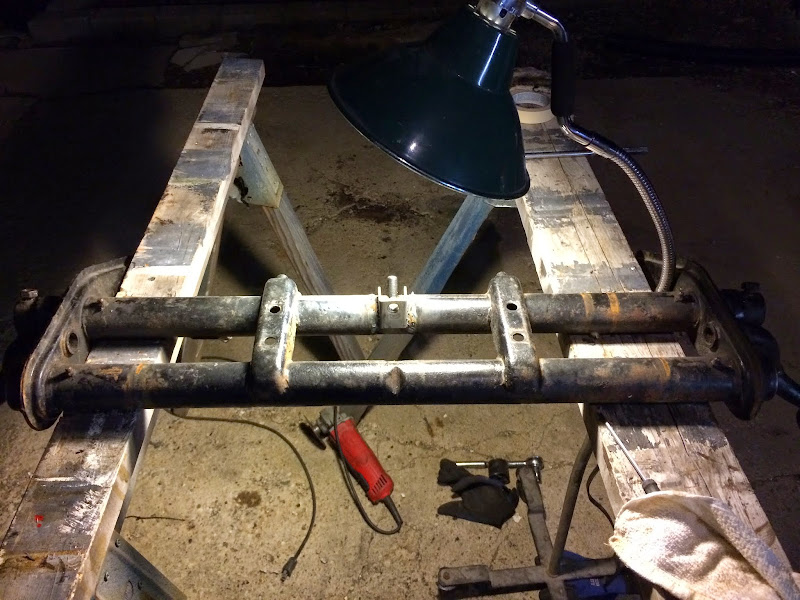

So, now that the rear is lowered, it's time to lower the front. I went and pulled the beam out of the front. I then welded in some adjusters and indexed them so I had a little more drop out of them by moving the adjuster past the original grub screw line. I welded them in and called it a night.

The next day rolled around and I starting to put everything back together. I noticed on one of the link pins, that the drivers side was missing some shims. I didn't think much about it at the time, but it did come back to haunt me.
I cut the stops off the front of the beam and bolted everything together. Once it was all done, I decided to put those wheels I picked up on as well and see how it looks....

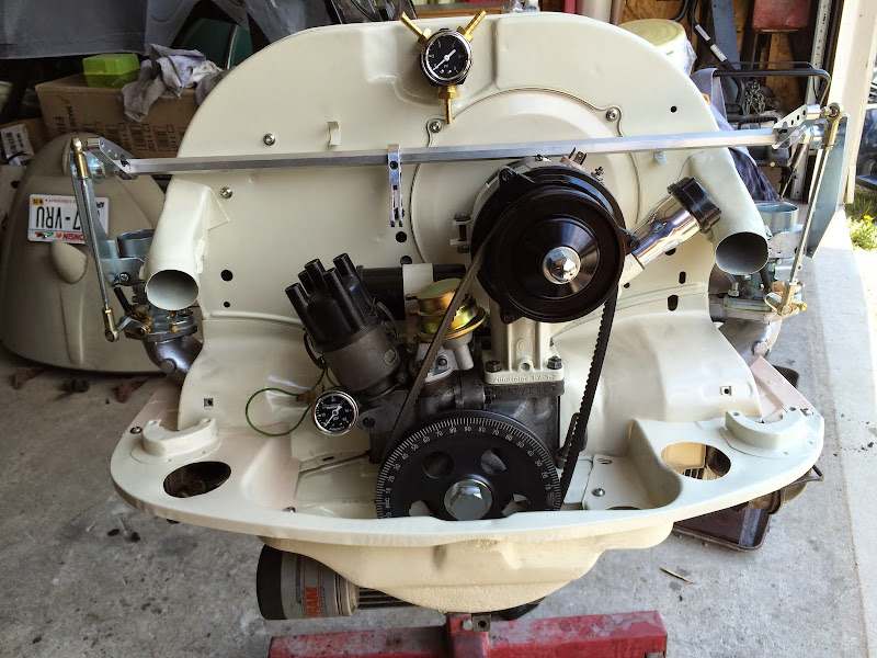

Since I was having all these troubles with the motor plus while driving I found a bad front transmission mount, I decided to pull the motor. I already had those dual EPC 34's and figured it might be easier to get everything installed and test fitted on the motor while its out. I also decided I wanted to powder coat the motor tins in the same color I am doing for my Mango Green 67 air ride beetle in my other journal and see how it holds up and if I like it or not. So, I pulled the motor and found that the previous owner was a complete idiot. wrong bolts, wrong nuts for the motor, wrong bolt on the starter and had a nut welded to it instead of having the right bolt. clutch cable wingnut was several bolts stacked to sorta make it work. So I pulled the motor out and started the whole process.... here are some pics of the progress....
stack of nuts for the clutch cable instead of using a 2.00 part Rolling Eyes
You can see the pile of parts from the motor behind it...
Here the motor got a little bath and brushing....

So, since I was making the motor look all pretty and stuff, I thought I'd add in an oil pressure gauge at the motor as well as a fuel pressure gauge. I had a hell of a time trying to find a fuel log block to split off the main fuel line to both carbs as well as having a gauge port in the right spot. Finally I found it. And it was reasonable. Billet aluminium and black. I think it will work nicely...

So, now that the motor is done to my liking, I figured I'd put it back in the car... So off come the carbs, intake and manifolds, most of the tin and then put the motor back in the car... with some shuffling it went right back in.
