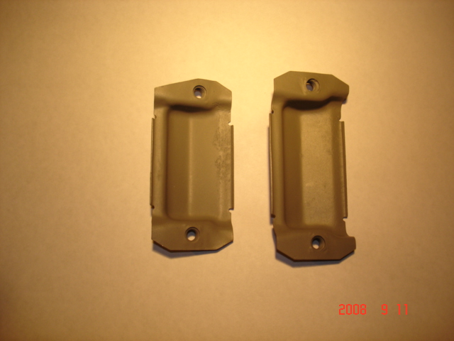

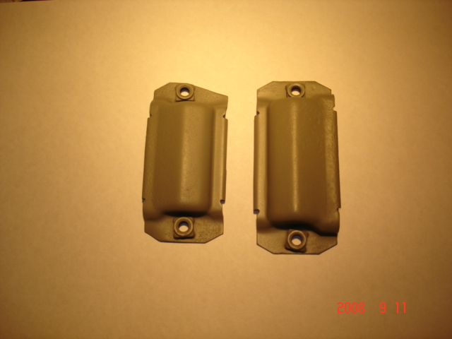

72-79 Air Non Return Flaps:
021 119 263 A Left
021 119 264 A Right
Thanks to Karl (rip)
Small=Right side Big=Left side
Thanks to jerseylooker
#41 & #42
Thanks to Mayor Ratwell
2. Control Flaps (blue):
72-79 Bus Heating System
German Supply 021 119 263 A Left Flap
German Supply 021 119 264 A Right Flap

Bleyseng
Joined: July 03, 2005
Posts: 4759
Location: Seattle
Bleyseng is offline
PostPosted: Tue Mar 17, 2015 6:54 pm    Post subject: Reply with quote
Yes, they had a little bit of foam around the edge too when new. For the pins I use a finish nail cut to the right length to slide in and hold the flaps. The cover holds the pins in.

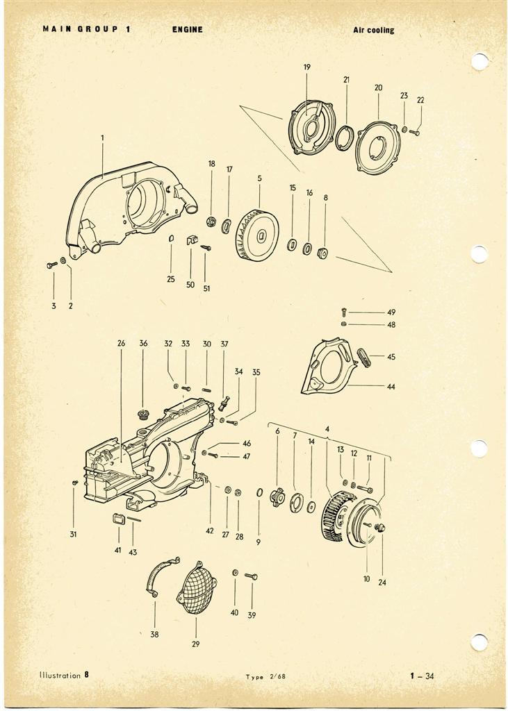

PostPosted: Mon Aug 17, 2015 4:21 pm    Post subject: Heat Exchanger Covers 021 256 321 D/ 021 256 322 B Reply with quote
1975 Kombi wrote:
Left 021 256 321 D -------------------------------Right 021 256 322 B
Gskt Lft 021 256 325 A------------------------Gskt Rght 021 256 326 A
thanks to mayor ratwell
http://www.germansupply.com/home/customer/product.php?productid=16558&cat=&page=1
http://www.germansupply.com/home/customer/product.php?productid=16559&cat=&page=1
http://www.germansupply.com/home/customer/product.php?productid=16389
http://www.germansupply.com/home/customer/product.php?productid=16388

PostPosted: Fri Nov 27, 2015 12:07 pm    Post subject: Non-Return Air Flap (L) 021119263A (R) 021119264A Pins 02111 Reply with quote
mountain bug wrote:
NOS Non-Return Air Flaps. Dealer purchased in the 80s, on the shelf since.
L Air Flap 021 119 263 A
R Air Flap 021 119 264 A
Flap Pins 021 119 270
VW Parts Book adds: "Shorten to 56mm for left flap".
They had small foam seals glued onto them. Over the 30 or so years on the shelf, they have dissolved and disintegrated so all that's left is the glue. See Photos. The Foam kept them from rattling more than for sealing.
Edited for content.
