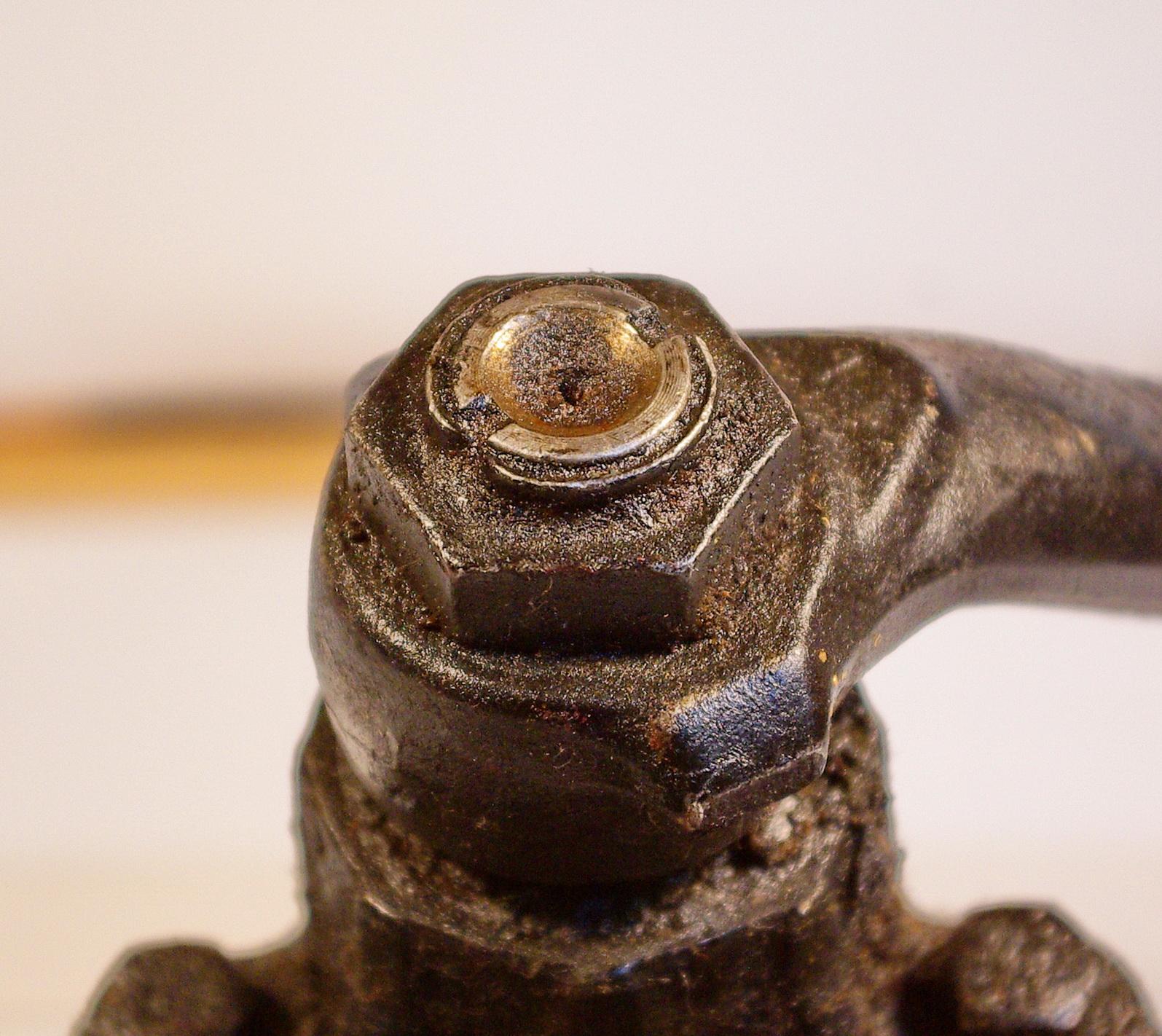

The problem I have got myself in is this. The box is already installed, and the rest of the steering is installed, but the pitman arm has to be installed on the box. I have it on there, and the nut is on, but I'm having trouble getting it to press on deep enough. I don't have enough arm strength. Perhaps as you say if I put some anti lock on the spline, and get a younger person with strength enough to turn it----When you get my age(90) you start loosing some of your strength
The box was rebuilt by a man in Oregon, Bill Kantz. He is another type 4 person. He rebuilt and sold several complete steering assemblies. I am well pleased with the one I bought. But for shipping convenience I had him ship the box separate from the rest of the system. Now I wish I had left it all put together. This has been a couple of years ago, and the steering is working fine, but I'm bothered that the arm is not all the way up on the box spline.
Its not supposed to be all the way up on the spline.
here is what it is supposed to look like
The nut only goes flush or a little more from the top so you peen only the edge of the lip into the slots
From the side.
Ray

titan3c wrote:
Yep I know now I shouldn't have installed the box without the pitman arm. I know it doesn't go all the way on the spline, just far enough for the nut to be fully on. Since I'm where I am with it on but not all the way for the nut to be fully on, I will make another try to turn the nut further. I hate to have to take the box off again, but may have to. Give me enough time, and I will learn enough to be a type 4 mechanic. Really, I shouldn't have removed the original box. I still have it with the pitman arm installed, and it was working fine. The reworked one with all new looking parts, just "siked" me out. Bob
Try this.....since the centerlink is not installed yet.....cut the steering box far enough over that you can insert a steel rod....a long ratchet extension bar will do....into the hole in the end of the pitman arm ....push it upward and then turn the steering box until the rod comes up against a body part wedging the rod in the hole and preventing the steering box from turning any further..
This will keep the worm gear from going all the way to the end of its stroke putting load on the ball bearings and worm nut.
Then get a large breaker bar and cheater pipe to attach to your socket and tighten the nut until it looks like the on in the picture. Thats pretty much all it will go.
this is how I did it when it was in the vise on my workbench. Ray
