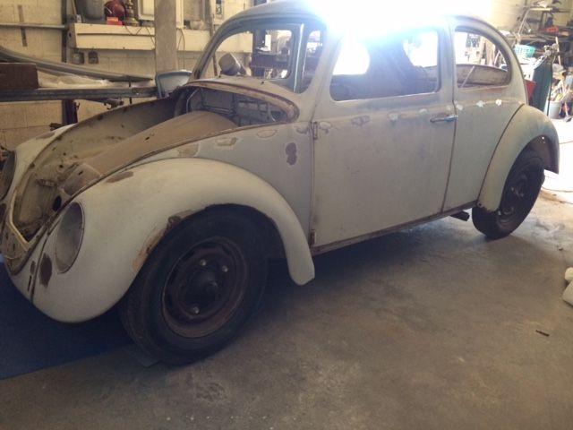

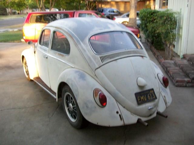

Here`s the start of my next project. A very solid, original paint 1963 Beetle. My plans are to build a traditional 70`s style California Look sedan. Dechromed, Pan off, T Bars, mildly lowered front, detailed Fuchs wheels... but with a few modern exceptions like 4 wheels discs, modern tires, 2276 with 48 Dells, and probably a modern ignition system.

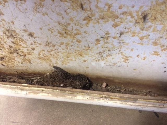

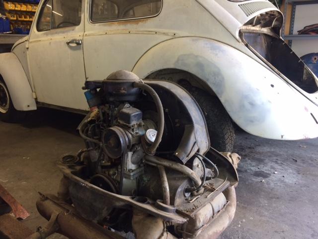

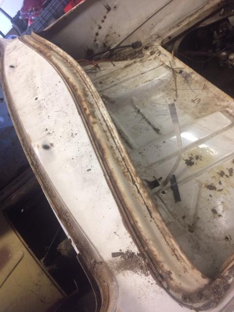

So here are a few shots of the teardown process. No major surprises, just an old original car.
A little rust in the trunk lid seal channel. So that will get replaced.

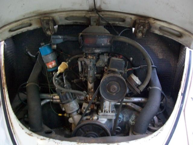

Out with the old 40 horse engine

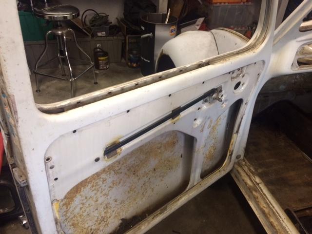

Making a mess...
The floors look good. Hopefully they can remain.
On to the doors.

Wow Bryan! That Bug looks VERY solid!
For the trunk seal . . . is the rust limited to just the seal-retaining channel? You can get that from Wolfsburg West. See if you can use yer twenty-percent off coupon at Harbor Freight to get a spot welder.

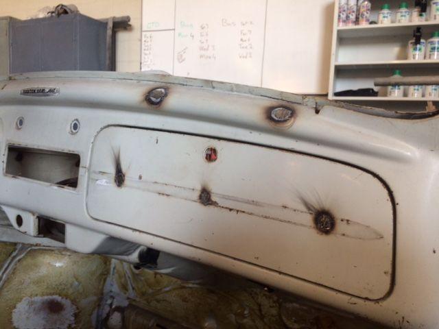

How neat, are those the factory inspector's signatures or m-codes in the bonnet forward of the ashtray & radio?

It`s just the channel. And I`m way ahead of you. I have a pile of W.W. parts waiting to get used. And I had Scat custom make the seats. They already use the hounds tooth on some of their other seats, so it was not a big deal.

I've pulled the hood and deck lid seal channel off one Bug and don't think I'd put it back on. They make a seal that goes on the edge of the hood for the front. I never figured out why VW put that seal on the rear.
Yes they are. I've had a few other cars with similar markings. In the trunk and in the wheelwells as well.
Cool, me too. My Current '64 has them in the bonnet as do you, behind the door panels, and behind the tarboards. I find it really neat that they've lasted so long.

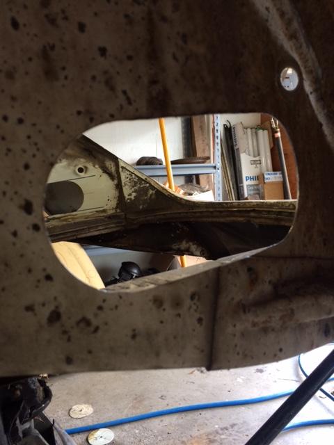

Here`s a few shots of the access panels being cut. I still have to make the covers...

It`s been awhile, but I finally got my 63 into my friend Craig`s shop Above And Beyond. Before sending the body off to media blasting he did some welding...
