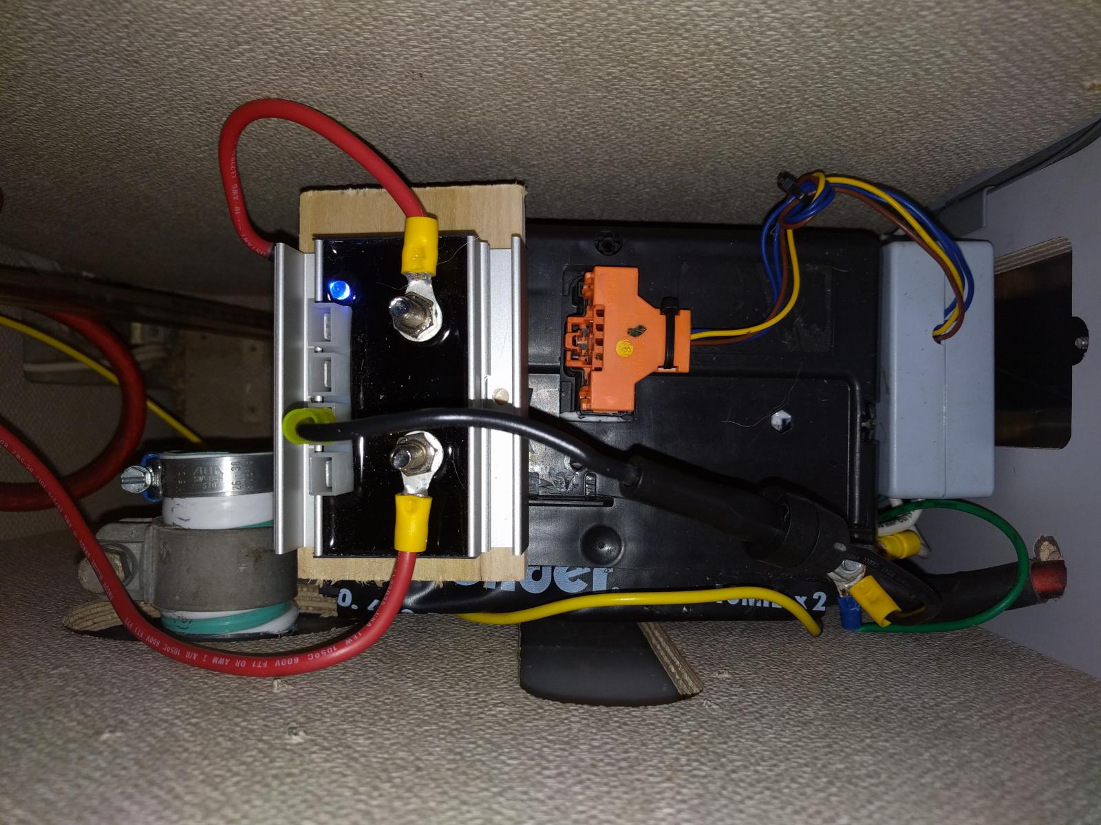

Hi all, De-lurking to see if anyone else is running a lithium aux battery
Here is my setup:
    full camper syncro
    100 Ah LiPo battery pack installed in lower rear cabinet
    Samlex Battery Guard (disconnects on low V, high V, >40A)
    Battery Doctor 150 to merge/isolate with the start battery
This is the first Li setup that Detlev installed (though I believe he has now converted his personal van). I've made some mods since it was put in.
Pros (so far):
    good energy density 100Ah fits in lower cabinet without protruding into the door opening
    The 100Ah + DoD seems to provide great life (truck fridge was still running after 3 days)
    The Li pack should be good for ~1000 cycles
Cons (so far):
    LiPo charge curve tops out at 14+ V, which tends to hold the start battery high enough to prevent the Battery Doctor from isolating the batteries automatically. For now I have a dedicated disable switch. Ideal solution would be a programmable isolator.
    Initial low-voltage disconnect was a solid-state relay. Unfortunately it was causing a lot of voltage drop and eventually failed. The BatteryGuard is better and provides over-current disconnect as well as over/under V disconnect (programmable)
    Cost
Dale
