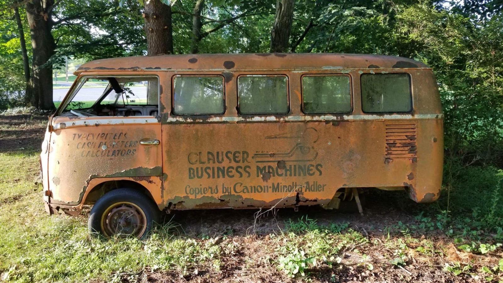

I recently went to PA to pick up a parts bus and while I was there, the owner was kind enough to show me some of the other VW's he had around. It was kinda late when I got there and was raining, but we ventured out into the night on a mission. Long and behold sat this Orange beauty. It was night time so I was looking at it with the flash light on my phone. I remember seeing it awhile back for sale in the classifeds and thinking the logos were really cool, but the damage was to extensive. Im a sucker for cheap rusted buses and having the bus in front of me to really see the damage, I got excited and convinced myself that I could do this Bus justice and put it back on the road where it belongs!!! Ive had better buses that ive passed along simply because of the amount of work needed. Ive also built my share of buses and lately my ambition to revive these lost cause ones has been gone. Something inside said I have to have it!! So with that being said.. heres my new bus. The Typewriter Business Pumpkin Bus!!!

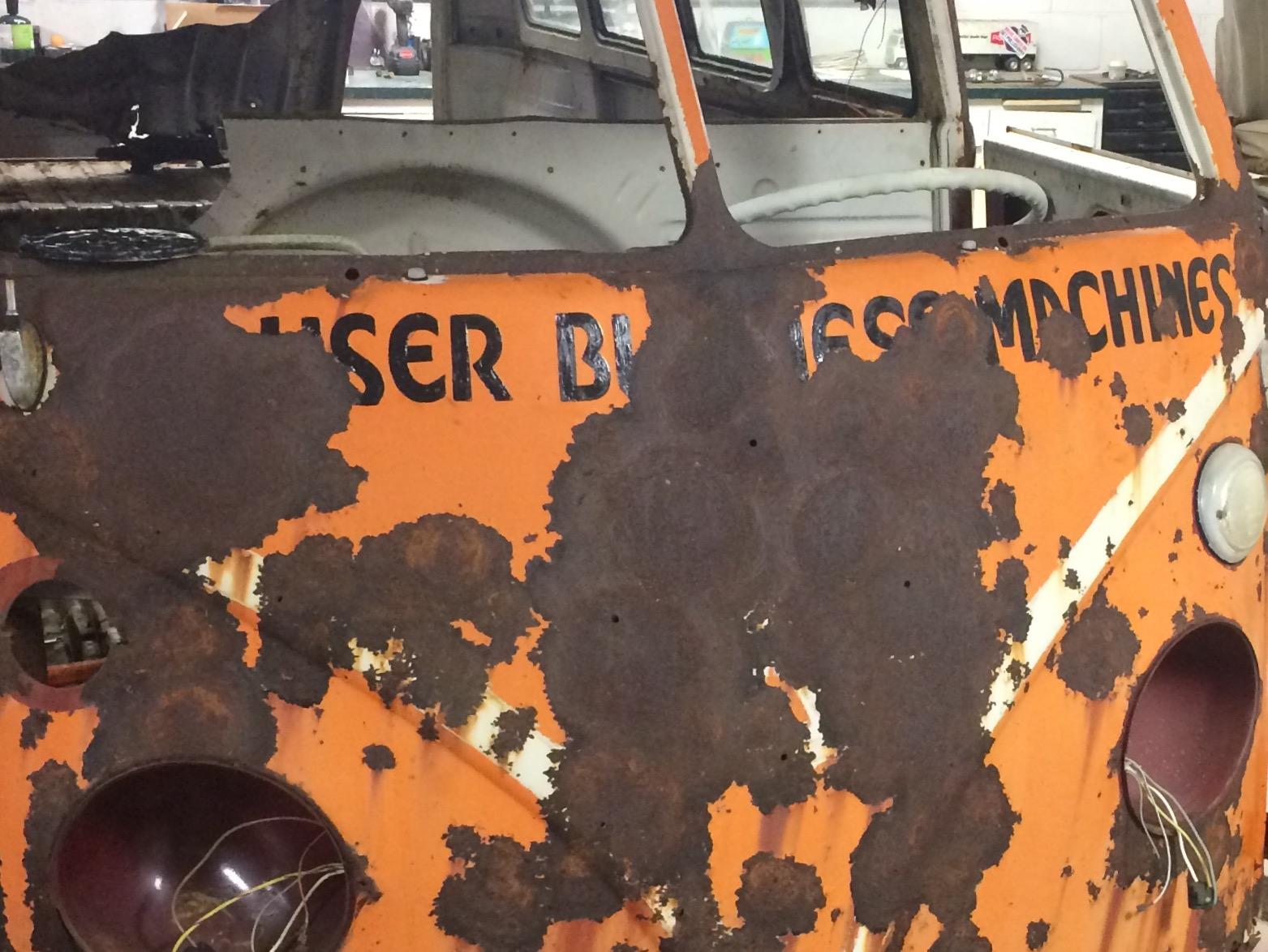

The bus was delivered to me on my birthday. 8/26. and right away I started having second doubts. I almost traded it for a sweet 61 bug. The deal didnt go down though. So giving the bus the benefit of the doubt, i slapped some axles on it, went and got it titled and ran thru the car wash!
It looks alittle better with all the mold sprayed off.

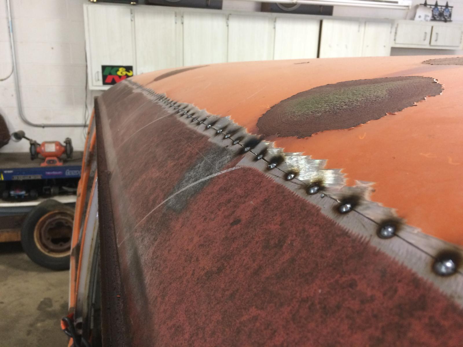

It got slammed hard on the passenger side. It twisted the roof and frame. The buckling in the roof made the paint flake off. Then it started to rust. A big ole pile of leaves and pine needles collected and just rusted the crap out of it. I started to have panic attacks looking at it "What the hell am I doing?"and "I need more solid metal in my life" were running rampant thru my head. The "A" pillars are gone, it needs a roof, it needs a frame, it needs a non-walkthru section, it needs a donor nose. It by far the worst bus ive ever owned haha.

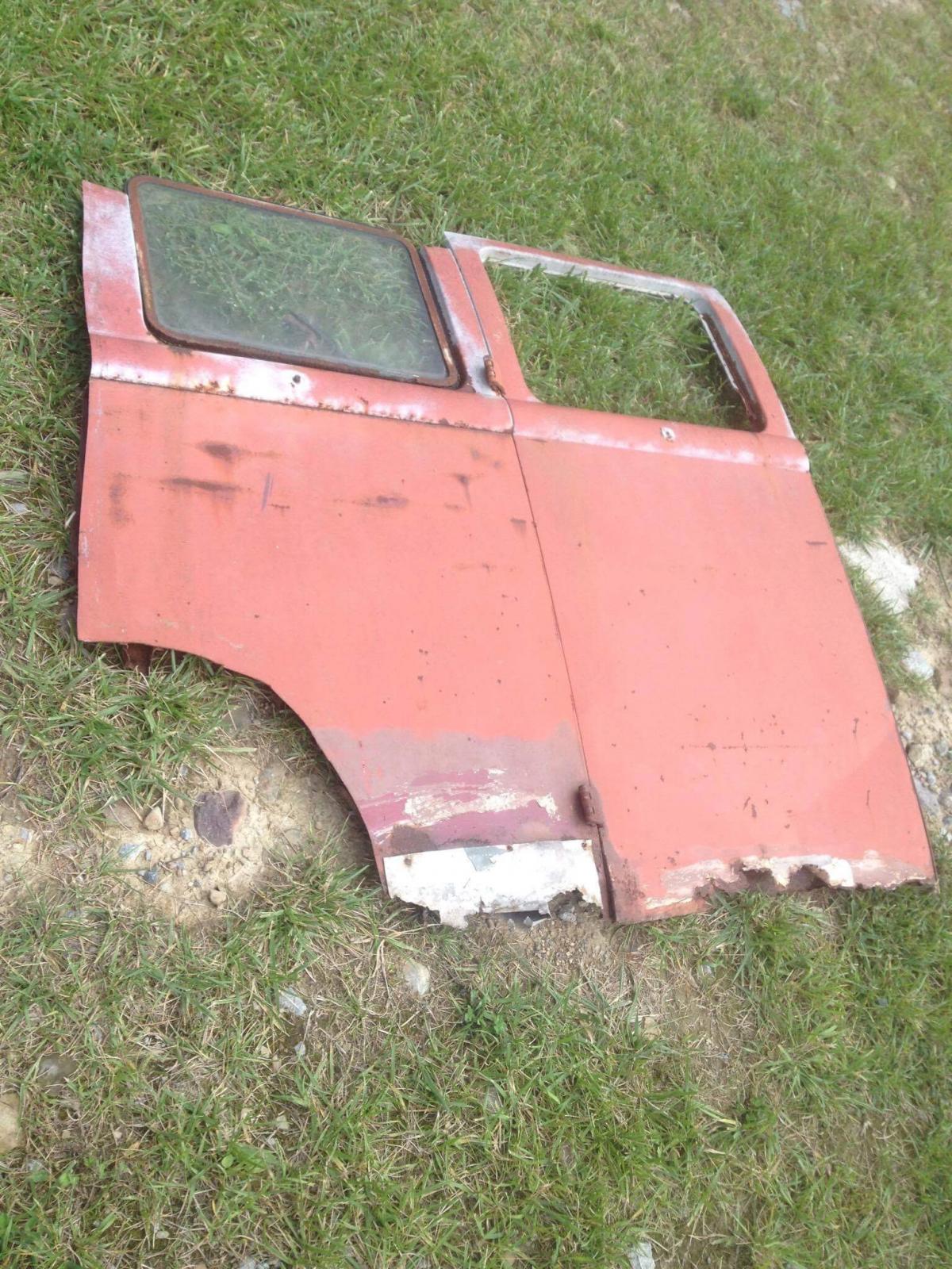

I had a 67 parts bus that was way worse then this one. I put it in the classifieds here and ended up making a trade deal. I got a complete roof, short wall and front frame and non walkthru section in the deal. The best part was he delivered it to me. So I began my magic...
Got the section I needed cut out

I forgot to takes pics, but i cut the bad sections off the bus. I welded a couple angle iron braces and had ratchet straps pulling and twisting the roof every which way. The frames still twisted so the roof wasn't really wanting to fall back into place. Once I got it where I needed it to be, i started fitting the donor section in. Thankfully, I have a really nice 66 westy here to take measurements from.

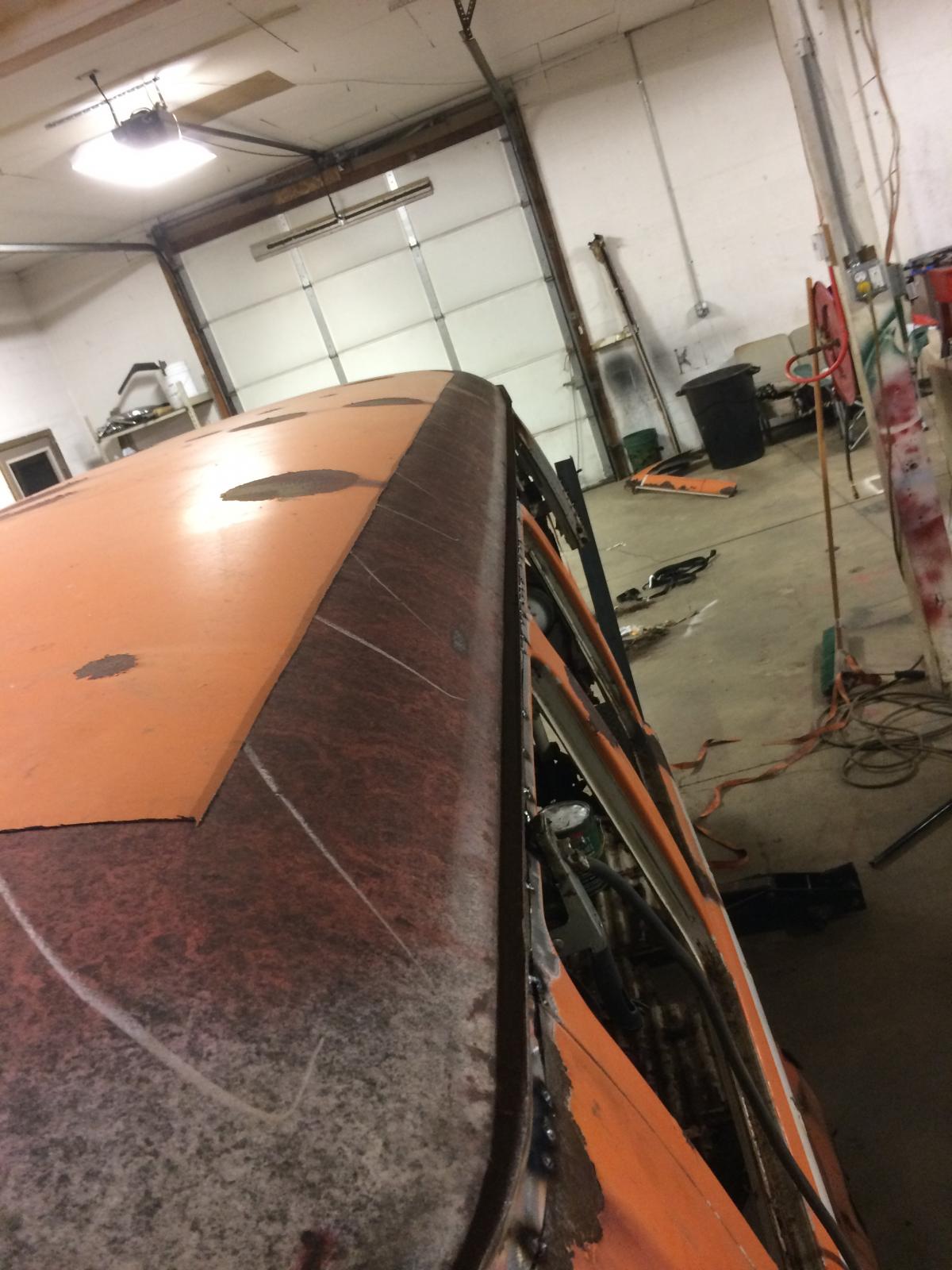

PostPosted: Thu Sep 14, 2017 9:44 pm    Post subject: Re: The Typewriter Business Pumpkin Bus Reply with quote
After a little bit of welding and sanding. Ive got a nice and straight roof. Now we're cooking with fire. Theres a tiny bit of rust in the corner. Easy fix.

PostPosted: Thu Sep 14, 2017 10:10 pm    Post subject: Re: The Typewriter Business Pumpkin Bus Reply with quote
I got a short wall in my trade deal and hopped on over to the "C" pillar that was crushed in. I dont really care about the bumps and bruises. I intend to keep this buses logos and all of its surface rust, but repair all the rust-thru. Overspray wasn't really a concern, either. I had paint mixed at the local auto paint store and was excited to see how well it blended. After i had that wall sorted out, i masked off the logos and shot a little paint on it. When everything is welded and fixed I plan to do the proper prepping and body work. I just had to see Very Happy

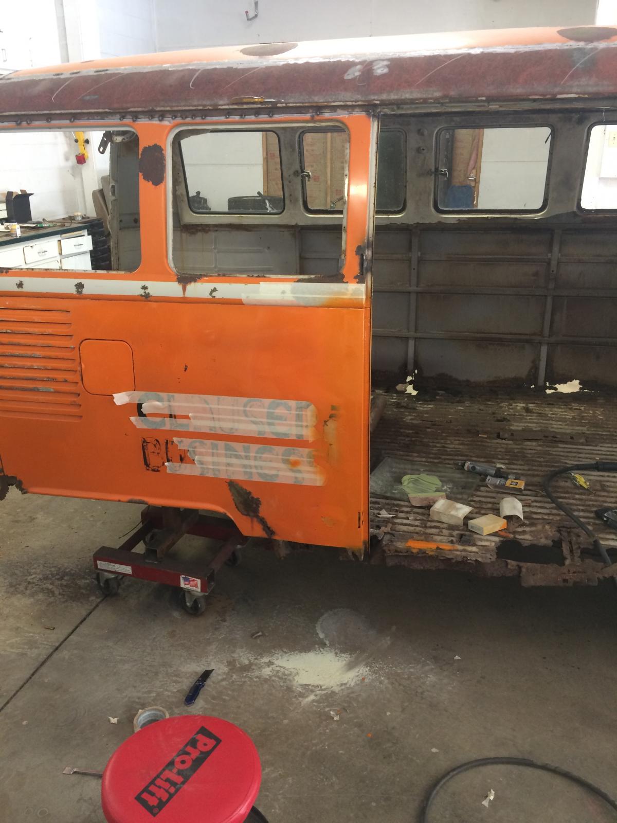

PostPosted: Thu Sep 14, 2017 10:20 pm    Post subject: Re: The Typewriter Business Pumpkin Bus Reply with quote

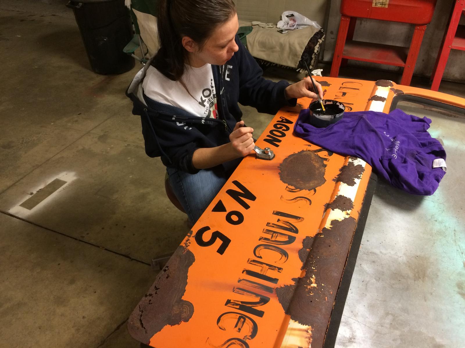

Although they were no longer visable, the bus had a logo'd nose. Under the right lighting angle you could see the outlines in the orange paint. I stayed up till 3am last weekend going back over these. My girlfriend loves VW's and everything I do. She wanted the duty of preserving the logo's. So she went and bought her own set of paint brushes and has been going back over them all by hand. I really couldn't ask for more!! Not only is she good looking, she also welds and helps me with every project we get. Not bad for a nurse.

PostPosted: Thu Sep 14, 2017 10:28 pm    Post subject: Re: The Typewriter Business Pumpkin Bus Reply with quote
After she redid the hatch logos, I buffed out the rest of paint and put the hatch back on to have a look. Now that the roof and C pillar is fixed, combined with a little paint cleaning, my thought process has changed dramatically. Cutting up or trading this bus would of been a huge mistake. Im certain its worth my efforts to save it.
