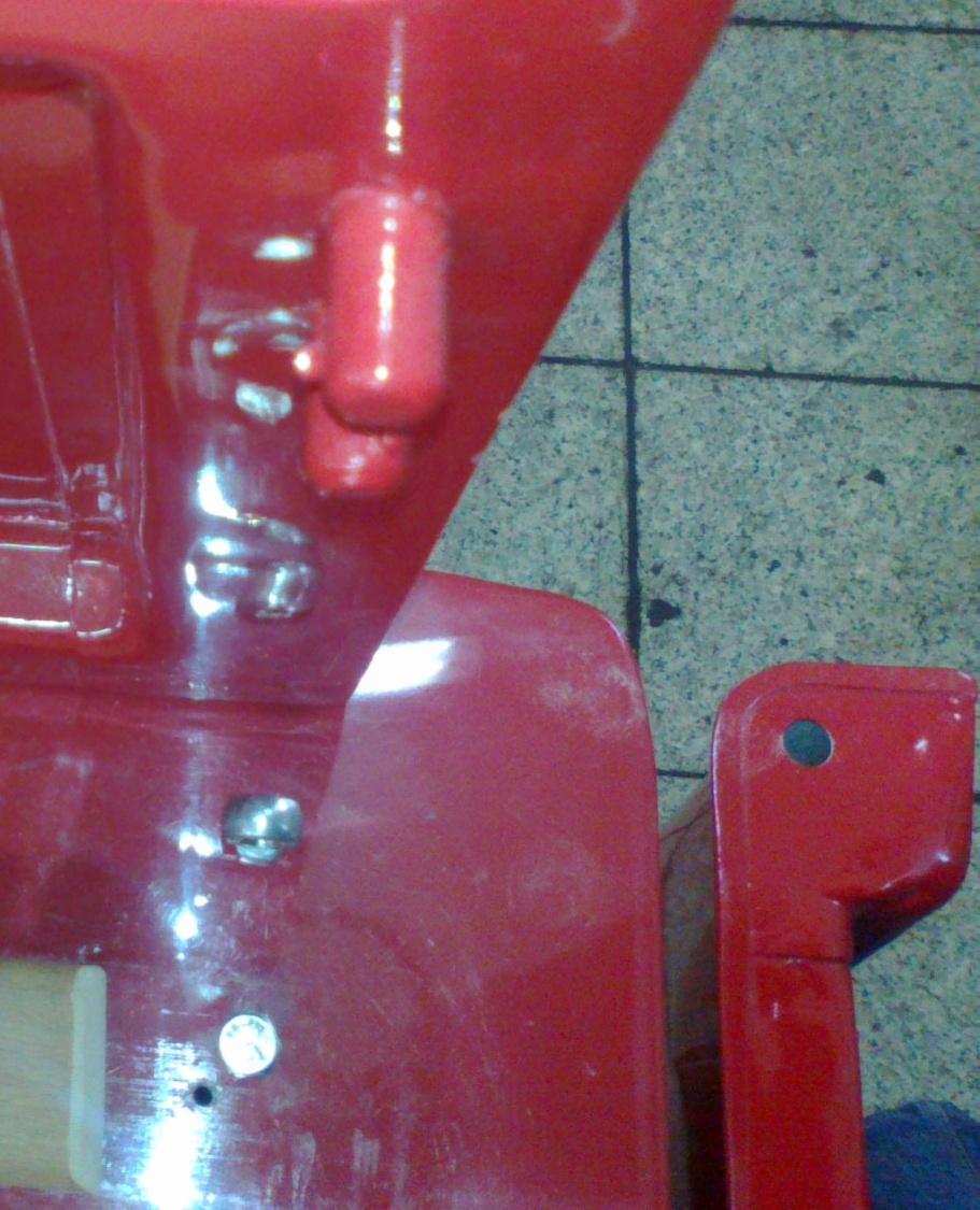

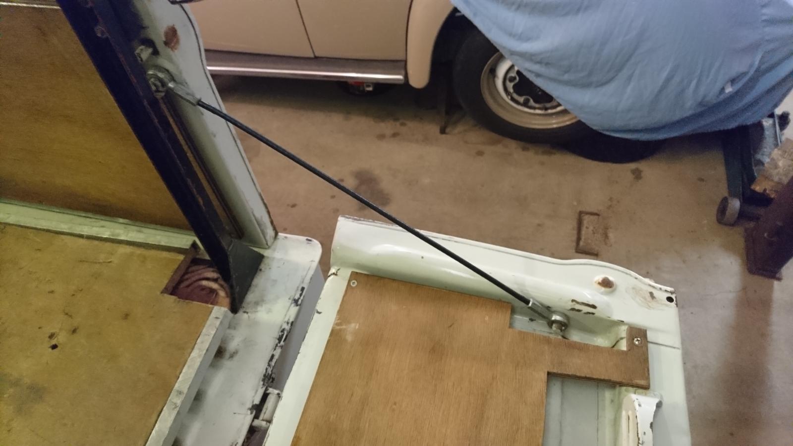

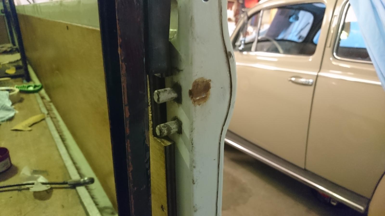

I found extras M226 in M-platte
Stop cable for rear pickup gate (retaining cable for tailgate)
I founded picture on web, samba..but without succes. Do You have this extras on Your Doka? Is it possible take picture for me?
thanks
PS: pictures show two pins on side gate - maybe parts of M226?

JirkaB
Joined: November 28, 2008
Posts: 39
Location: the Czech Republic
JirkaB is offline
PostPosted: Sun Dec 10, 2017 7:47 am    Post subject: Re: Crew cab/truck - extras M-226 Reply with quote
Extras M226 is a same for Bay and for Vanagon too. You are right.

Any chance of some better pics of those pins on the gate? Are they threaded?, do they have holes or slots for a clip of some sort?
Looks like the OG deck is long gone, but are there any holes where some sort of brace may have bolted down along the edges?

I will add a new better picture within weeks. Unfortunatelly Doka is not home now.
Every long side (side walls) have a two pins. Pins are without threaded, but have a small pin. Every big pin have a small pin with other angle. The big pins are welded od side wall.
The big pins are in "air" when gates are closed.

PostPosted: Fri Dec 29, 2017 12:57 pm    Post subject: Re: Crew cab/truck - extras M-226 Reply with quote
added pictures of pins

From http://www.teedrie.nl/t3-m-codes/m226-kabels-achterste-laadschot/
Ben

I also have the M226 code on the M-plate. The gates have the same pins as yours have. Fortunately the cables have been preserved.
I assume it is a pretty rare option to have.
The ends of the cable have aluminium castings with a slot for the small pin.
This construction is pretty sturdy, you can just sit on the rear-gate.
I hope this helps

PostPosted: Fri Feb 01, 2019 2:00 pm    Post subject: Re: Crew cab/truck - extras M-226 Reply with quote
Perfect. Thanks It helped to me.
Side gates have pins. Unfortunatelly rear gate is without pins. It mean rear gate is not from my Doka. Therefore I had not idea.
Pictures are super. It is solution for me.

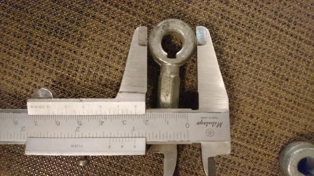

Please, is it possible measure cable? Lenght - center to center, width of eye, diameter of cable.

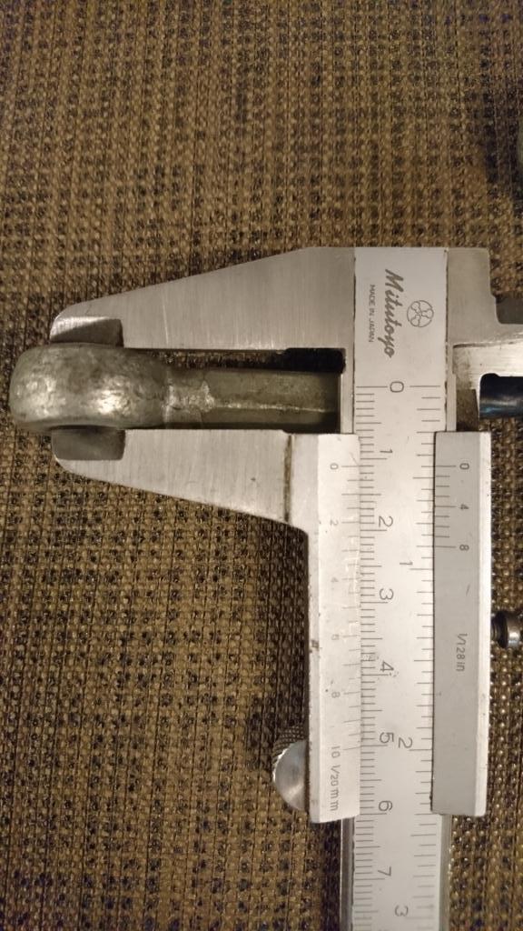

Hi vwassing
please, is it possible help me - measure dimenssions of cable?
I would like use DIN 944B screw as "raw" material.
Dimenssions A-H
B..probably 10mm
G..probably 12mm
thanks

PostPosted: Wed Feb 06, 2019 9:26 am    Post subject: Re: Crew cab/truck - extras M-226 Reply with quote
Hello Jiri,
Of course I can help with the dimensions of the cable.
A= 24mm
B=11,5mm
C=4mm
D=24mm
E=10,5mm
F=10,5mm
G=11mm
H=6mm, Steel cable is probably 5mm
The length of the cable, center to center, is 465mm.
The pin (nipple Wink ) on the gate is located 275mm from the bottom of the gate.
I hope you can continue with these dimensions!!
If you need extra dimensions or pictures let me know.

PostPosted: Wed Feb 06, 2019 12:05 pm    Post subject: Re: Crew cab/truck - extras M-226 Reply with quote
Perfect, all dimenssions are clear. Thanks.
Material of eye is aluminia? Cable is coated steel.
