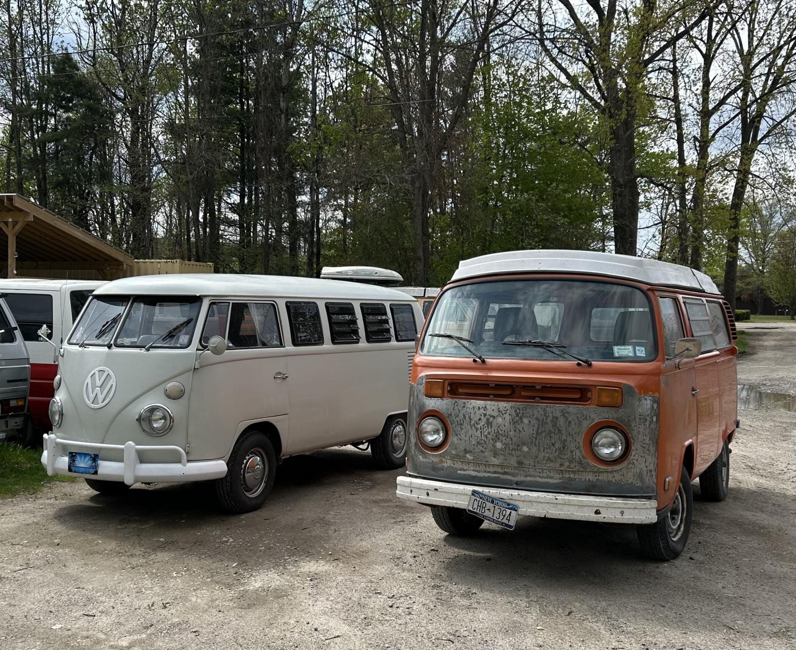

It's about time that I started a project thread after scattering questions around here for years. I will try to keep my explanations short and include lots of photos.
My grandparents bought this bus from its original owner in 1979. There is a story floating around in my family that the original owners brought it over from Germany. I'm pretty sure that's not true. I will post an M-plate pick at some point. My mother sometimes tells people that they drove this bus to Woodstock. They did go to Woodstock, but obviously not in this bus. They wanted to catch some of the country and folk acts but cleared out as it started to get rainy, muddy and carnal. They were squares, square dancers actually and fairly conservative. But they were fun and did road trip shit you might get killed doing today. They had planned to drive the bus to Salt Lake City to visit my aunt, but my grandfather was diagnosed with bladder cancer and died before the year ended. My grandmother kept the bus and drove it occasionally until she totalled her Plymouth Duster in the late 80's. It then became her daily driver. My grandmother worked nights as a nurses aide and drove a ten mile round trip year round with the heater boxes not really working. She was pretty tough, under 5' tall and had a club foot from having polio as a child. The inside door handle is still loose from her hauling herself up into that bus so many times. She never complained about it, wasn't interested in another car and wouldn't part with the bus. In my late teens, I bought a scooter, a PGO 150. It was a knock off of a VESPA PX150. It would do about 60 mph and I scared the hell out of my entire family taking it on long road trips. While driving in downtown Toronto, a cross shaped piece in the gearbox disintegrated locking the back wheel and sending me into a surprise skid. I mananged to stay upright, but that was the end of the scooter. I began saving for a real bike. When I was just about buy one, my family intervened with an offer I couldn't refuse. My grandmother would give me the van and my mom would take my bike money to put towards a K-car for my grandmother. So in 1990, I took posession of the bus and drove it from Poughkeepsie New York back to school in Toronto. I will try to keep the rest of the story short and include a few pictures.
Goofing around with my sister and a good friend, Toronto 1990
First road trip, Winship's hill, Fairlee VT, early 90's. The spare tire mount and ugly mirrors are long gone.
Return trip from 3-Pistoles, Quebec to Toronto

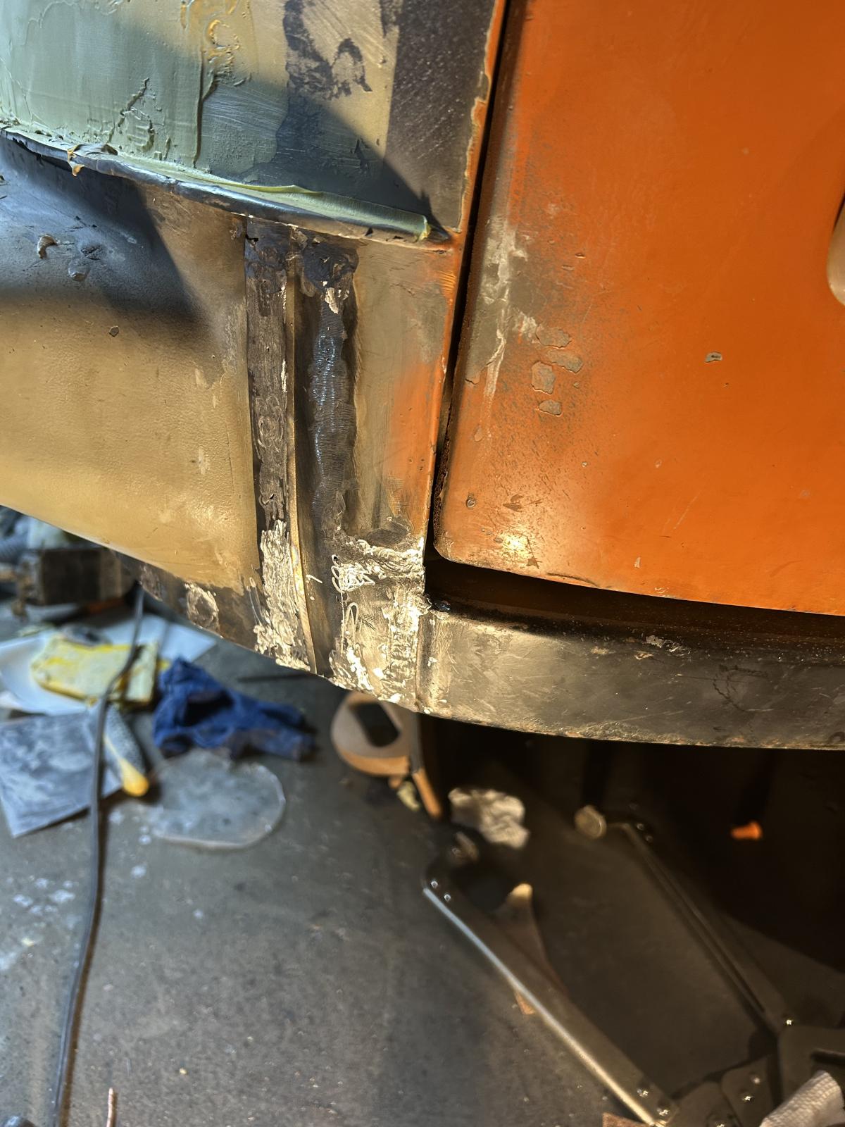

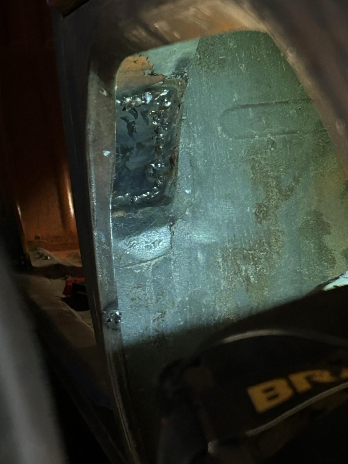

Flaming Gorge, Wyoming on the way to San Francisco, 1996. Looked good, but brazed in patches under bondo sculpted panels.

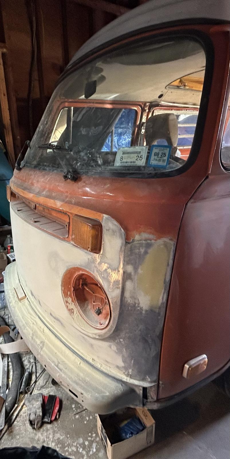

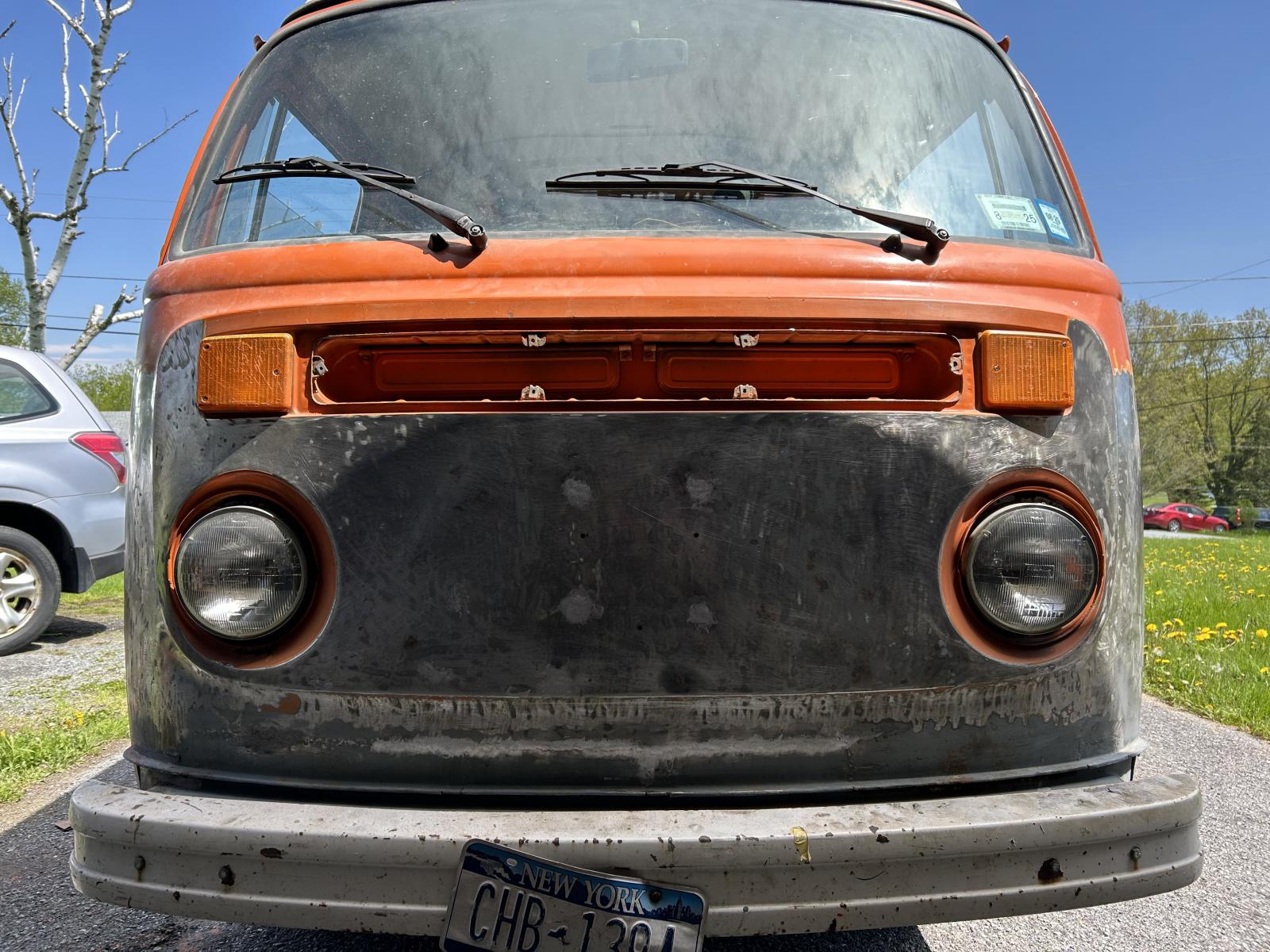

Last summer in Old Orchard, Maine. Looks awful, but no more bondo...
Now that I finally got this project thread started, I will try to get it up to date with how things are going with it now.

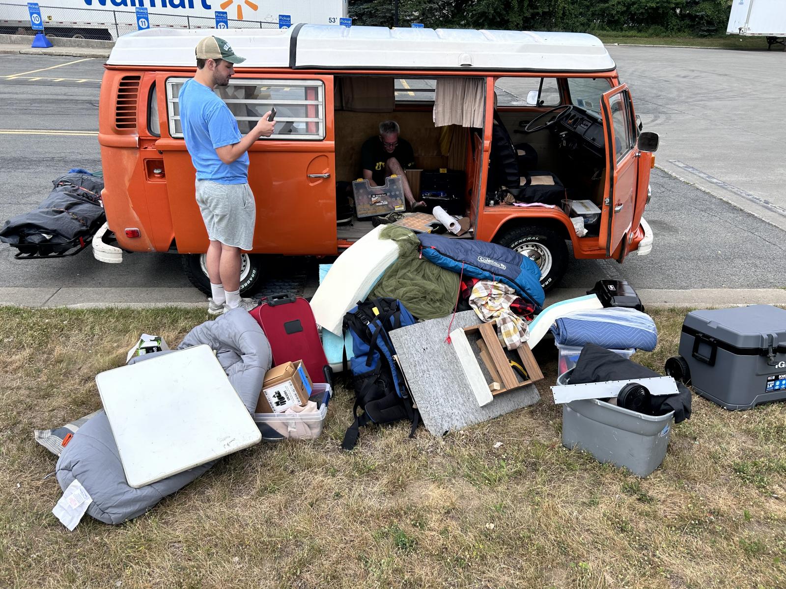

In the summer of 1996 I drove to San Francisco from Northern New Hampshire. I had recently replaced the original engine with a crate engine from a company called ECI. I had driven it a couple thousand miles and had it checked out by an old school be mechanic before leaving. We were doing ok until somewhere around Omaha when it started running rough and losing power. We had the valves adjusted in Omaha but the engine continued to lose power and run like crap. When we got to San Francisco it was Bailey moving. We took it to a VW Audi Porsche mechanic who told us the engine had zero compression on one cylinder and was at 50% on another and that our engine was a slappped together pile of shit parts. The garage told us that they were going to order a factory authorized rebuild from a company in Holland. What we got instead was a GEX “premium rebuilt” engine. We knew of the GEX reputation but we were completely stuck. We drove home with no issues and I ended putting 45,000 miles on it until I tore it down in 2013.
One of my friends on the trip insisted on taking one of these photos every time we crossed a state line.

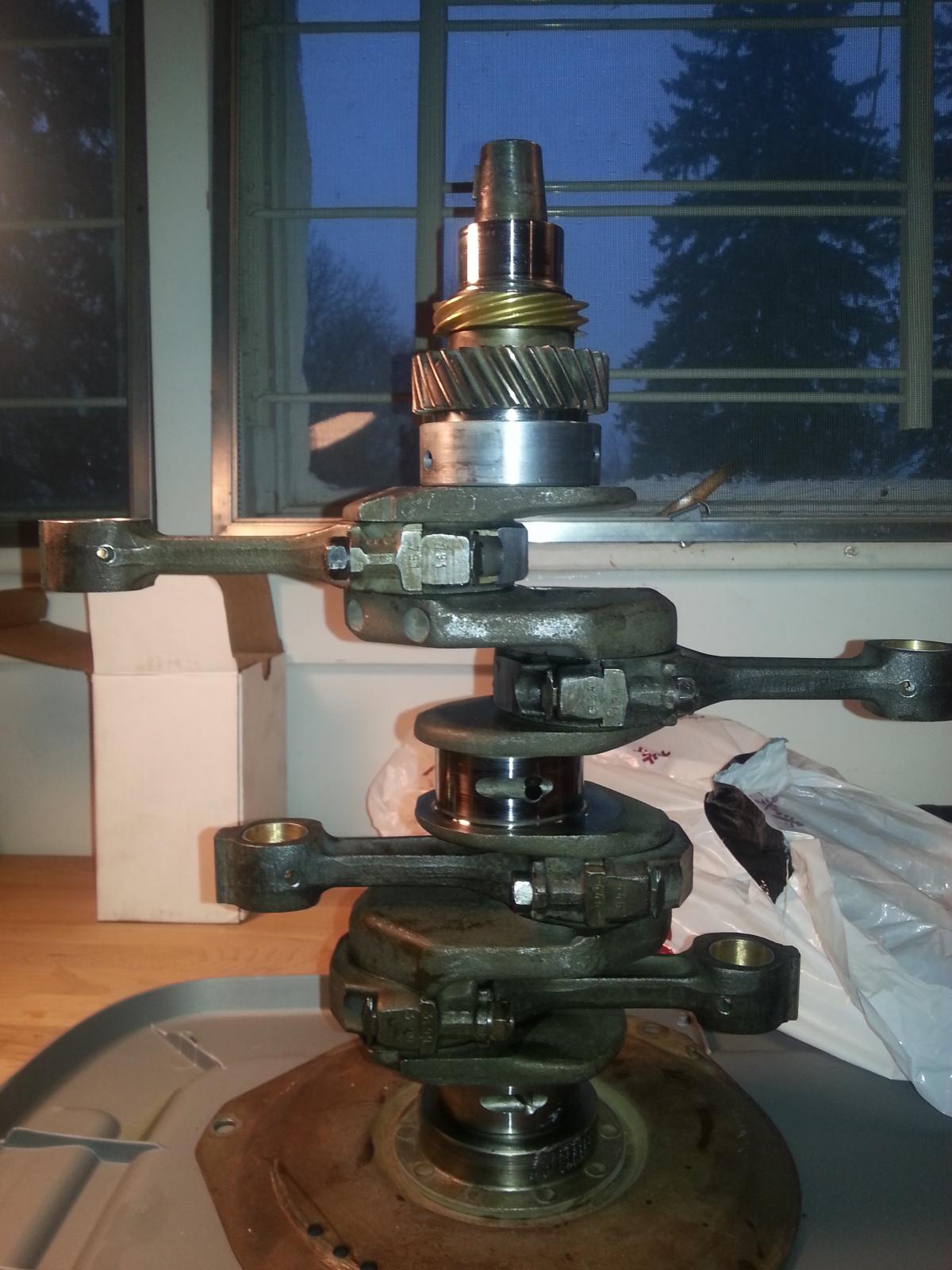

The GEX engine was really unremarkable; bearings were ok. An odd rod with a different balance pad, the usual Type 4 cam lobe wear starting. I had a local machinist do the heads, hone the cylunders, polish the crank. I replaced all the bearings and put in a WEBcam (stock grind). I had broken an ear off the stock oil pump trying to pull it (before the night of drunken disassembly) and it would not build pressure. The welded on ear quickly broke off, as well as the other one. The pump had always been tight. We took it out in pieces.

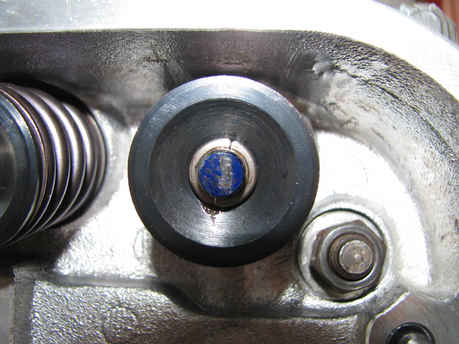

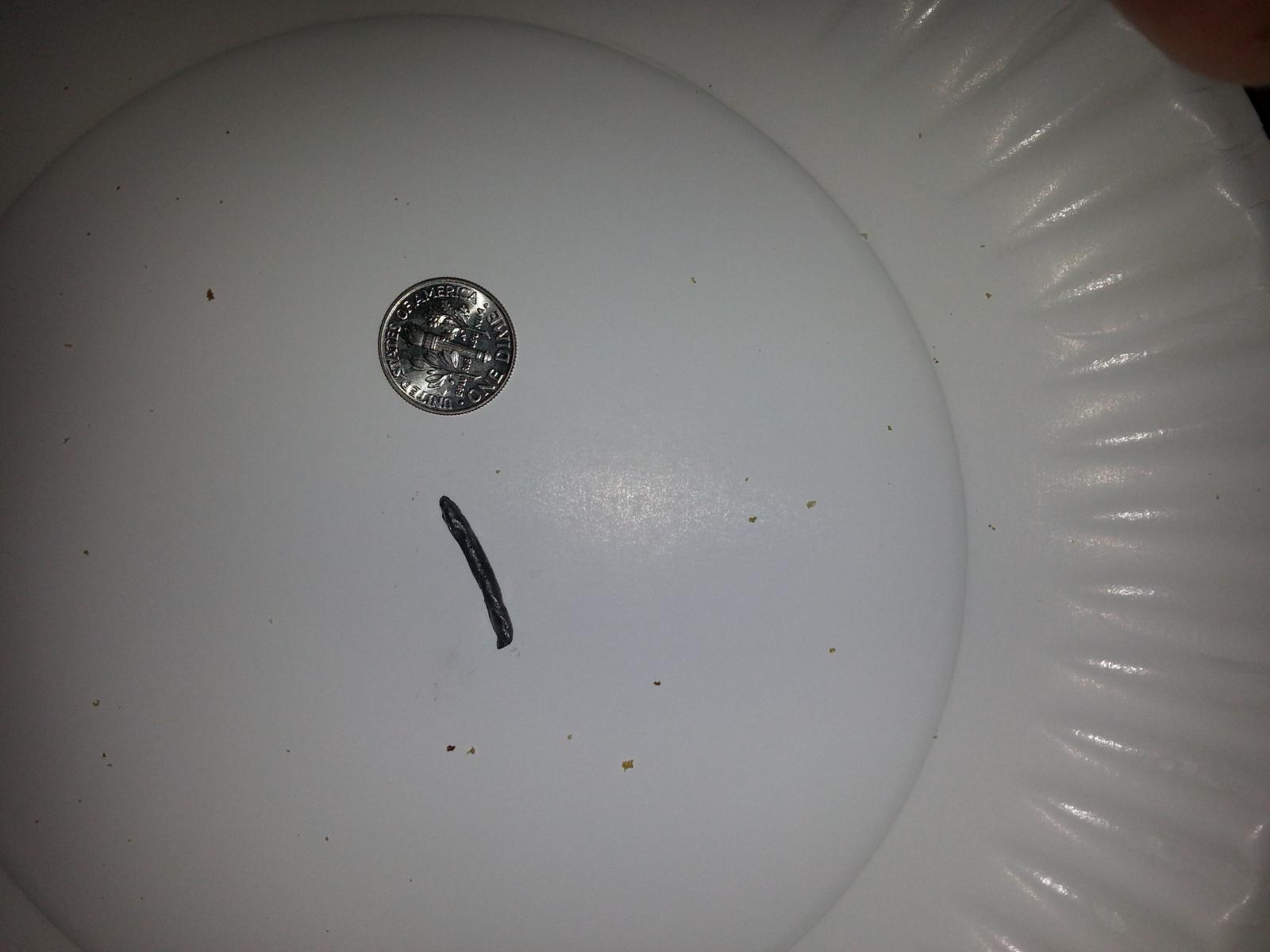

This little bit of metal had found it's way into the number 3 cylinder and had beat up the piston top and combustion chamber. I think it might have been a piece of a small screwdriver used for glasses...which was on my keychain...which had been next to the engine hatch...when I was adjusting the carb.
I took the head back to the machinist and he replaced the valves and cleaned up the combustion chamber with a die grinder. He said he was not equipped to do fly cutting. My new pistons and cylinders wouldn't fit. The sleeves were thicker even though the pistons were the same size. Looking at them more closely I saw that he had ground the ends of she valve stems so they were level with each other, probably to compensate for sinking seats. There was a crack in the spark plug boss I had never noticed before. Compression on the number one cylinder was lower than before, probably because the head was warped and the original head gaskets made it seal better. I had lapped the cylinders to the heads, but lapping won't cure a warped head.
I really wanted to give up. I realized that I was...a butcher. And a really sloppy one at that. And that the local machinist...sucked. And seemed to put VW engines in the same category as riding lawn mowers. Even GEX would not have hired me...

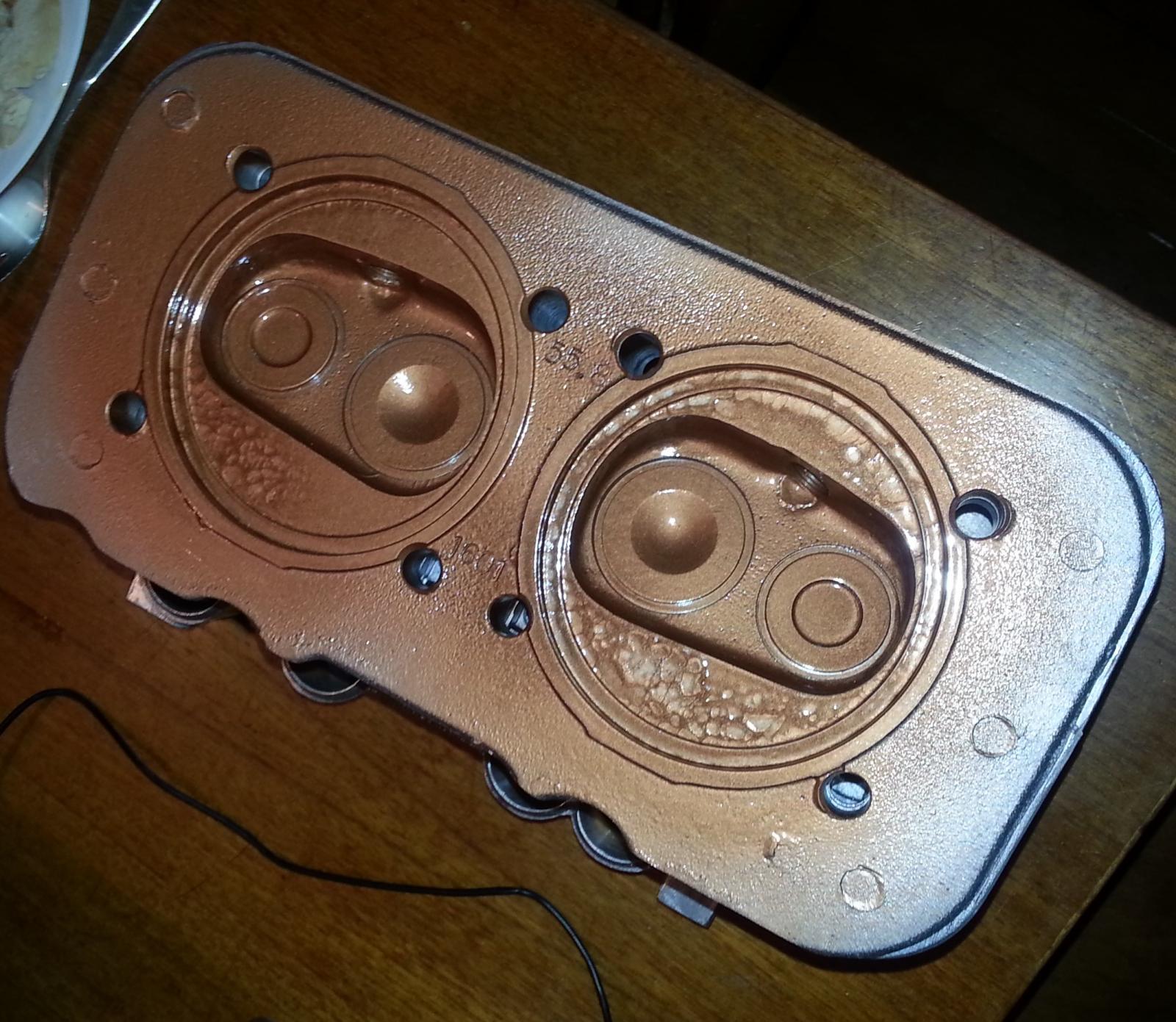

I decided to get Blueprint specials from Len Hoffman. All my past engine failures had been due to head failures; burnt valves during long highway drives. Nothing spectacular, just that slow death as an engine lost power. Len was really helpful in explaining his work and with cam recommendations. He answers his phone and is straightforward and unassuming. He answered my handwringing, obvious questions without making me feel stupid for asking him.
The heads themselves are works of art. They made me realize what complete turds my old heads were. I don't mind spending good money. Good money often solves a problem and ends up being much less than bad money in the long run. I also installed a Webcam 73.
One of Len's heads with way too much Coppercoat. I torqued them and removed them to check the seal with the cylinders. Cleaned them and applied a more reasonable amount of coppercoat. My old #1 cylinder had not sealed well in spite of extensive lapping on the first rebuild. I suspected a warped head but also worried about the case deck. The new heads and cylinders sealed perfectly.
I find that new engine builders become really focused on one specific measurement. It is a forest for the trees kind of thing. I was really focused on deckheight and valve geometry as I had problems adjusting a valve during my first rebuild (one adjuster had to be backed out a lot to get clearance).They were fine on this build.
I also had the rods balanced end to end and new piston pin bushings installed. I reused the 26mm CB performance pump and had to remove a little material from the drive gear shaft to make it fit.

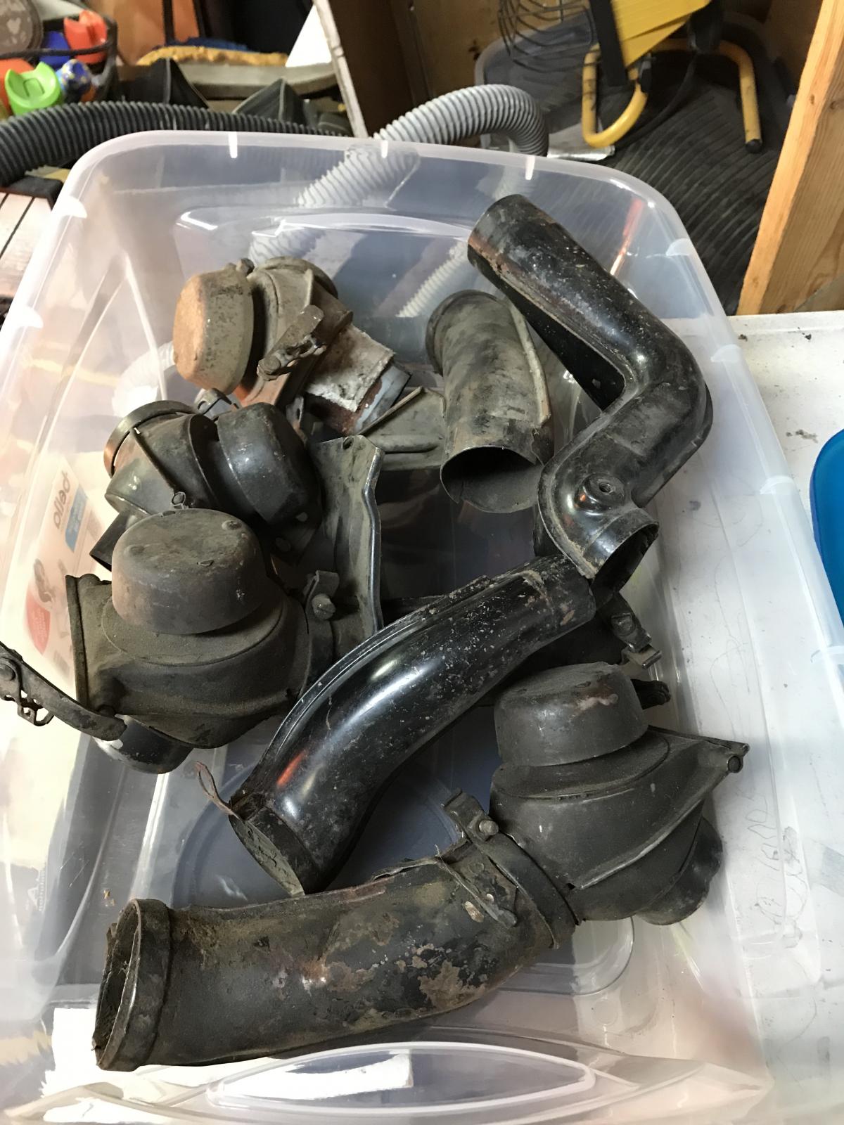

Like many of you, I have ended up with my own parts department. I have been working on getting it organized. It makes a project a lot easier when you can put your hands on the parts you need without overturning your entire garage.
